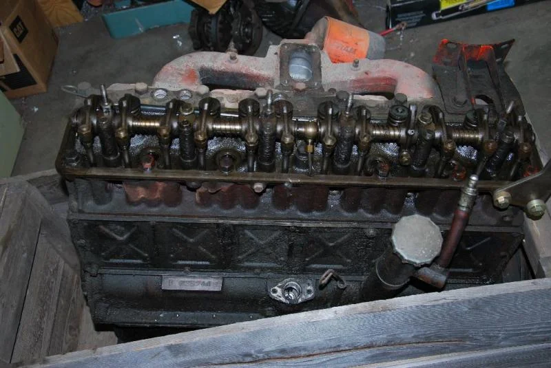

Here Are some pictures of my carburetor on a 0ct 1976 built FJ40 for 1977 and an engine serial number of 2F 120142 . I could not find the serial number. If you could point out where it may be on the picture that would be helpful.
Right above the sight glass on the top of the air horn there is a boss sticking up. Oval shaped. The date stamp will be there. Wow, your 2F and mine are only 565 units apart (mine's 119577, so it was a little ahead of yours on the assembly line). Cool.
Alright work week is done so I'm back for the next couple days. So I saw a 6 and an I on each of the oval jet housings that lie across the sight glass. There was no XX or 10 but there were two numbers on the top side of the jet housings that looked like someone hand carved them in. As far as boss do you mean the copper rigatoni noodle orifices that are sticking out of the top of the air horn? I carb cleaned all over the inner part of the airhorn and sight glass and saw nothing except the numbers on the jet housings 6 and I on each housing. I dont want to un hook any of the linkages to dismount the carb. What do you think?
Wow, thank you that helped out tremendously. The SOR carb looks very similar. I notice my carb has no wiring harness nor does it have those 2 copper candy cane looking pieces hanging off the side of the air horn.
Notice in the carb picture how the TP Diaphragm has a hose going directly to the intake manifold. I believe there needs to be a VSV (TP and EvAP) between the tp Diaphragm and intake manifold. Do you concur?
