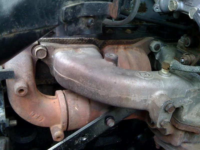

If you look at this picture, you will also see a couple other things:
  1. There are two threaded holes in the exhaust manifold. There is a shield that is supposed to mount there using those two holes.
  2. There is a hole on the bottom of your air intake. There is supposed to be a hose that runs from that hole to the shield mentioned above. This is for the Hot Air Intake (HAI) system. Not a critical system, but it helps with cold-weather operation and keeping the engine efficiency optimized. Might want to think about eventually finding those pieces.

It will not pass CA smog without the HAI intact. They won't make you cool it off to verify the bi-metal spring actually retracts, but you have to have a reasonable facsimile of a heat shield and the riser tube. You can get away with a fab job. I have made two, one out of coat hanger, alu foil and alu foil tape. Cheezy, but functional. The original will be hard to find and expensive. They don't even have them at $OR.
You will also need a full EGR system, AIR system, VSV and computer. It doesn't all technically need to work, but it has to be there for visual inspection and of course you have to pass tail-pipe emissions. If it's well-tuned, has a reasonable carb and valve train, the AIR system is functional, and it's hot, it should pass. The numbers aren't that restrictive for the early years.

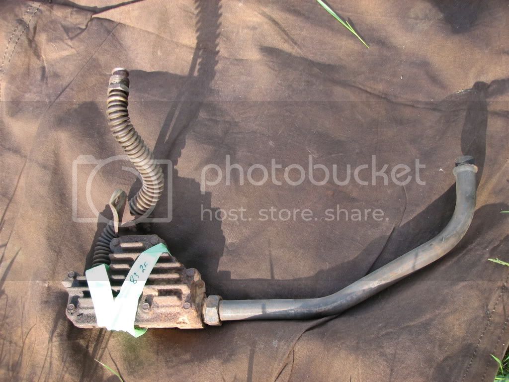

Just do a Google Image search like this:
"EGR Cooler site:ih8mud.com" and you will get pictures like this:
EGR Cooler:
