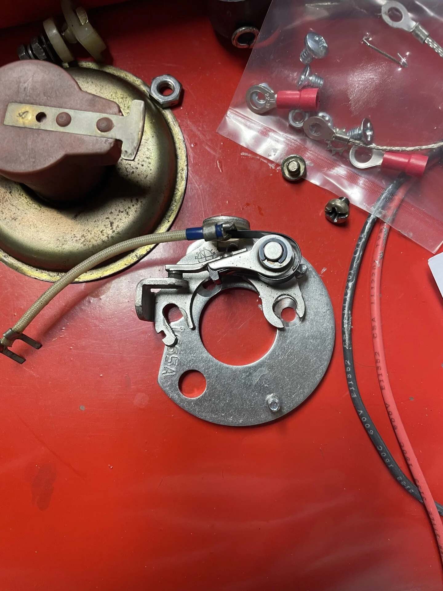

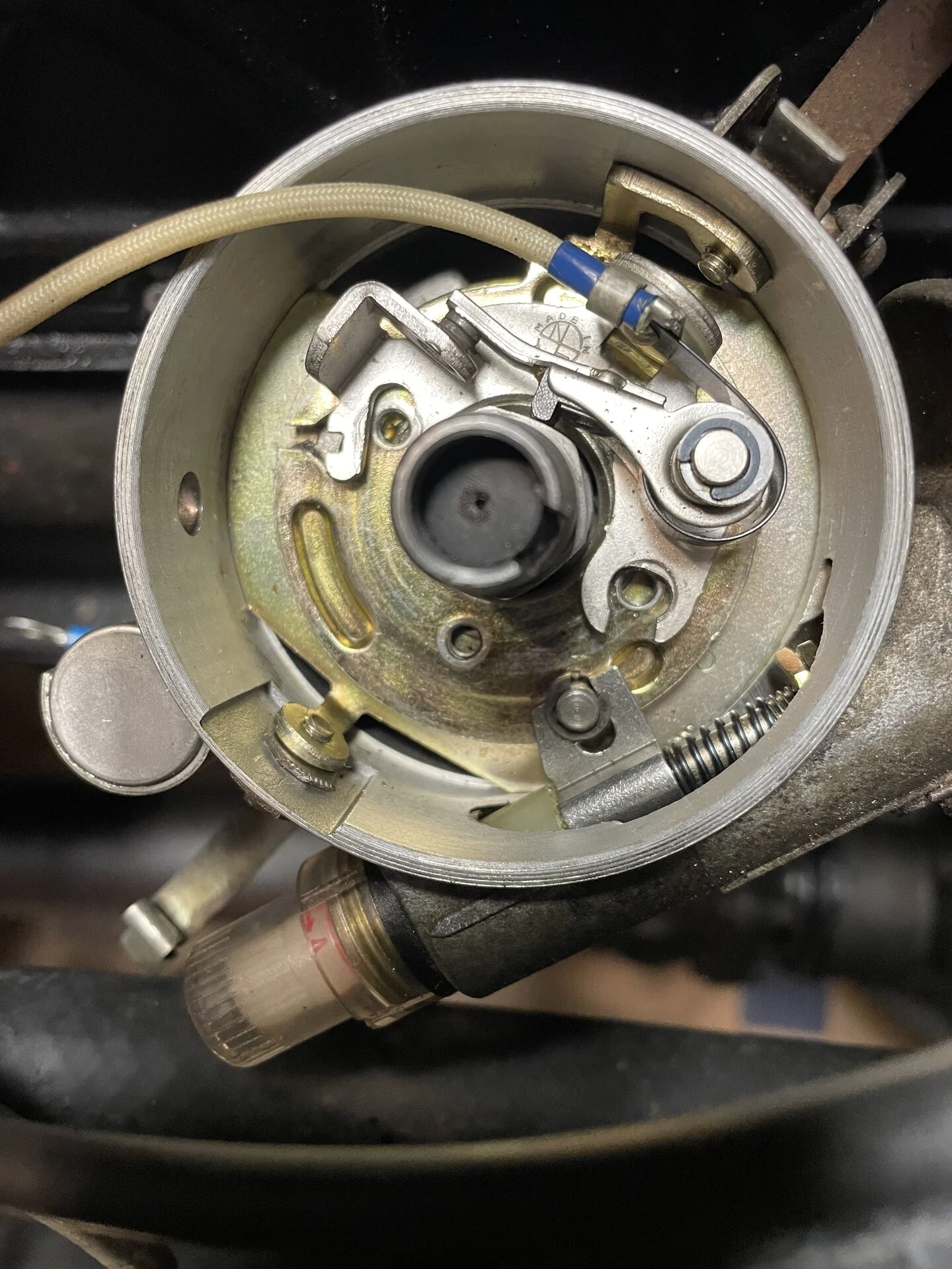

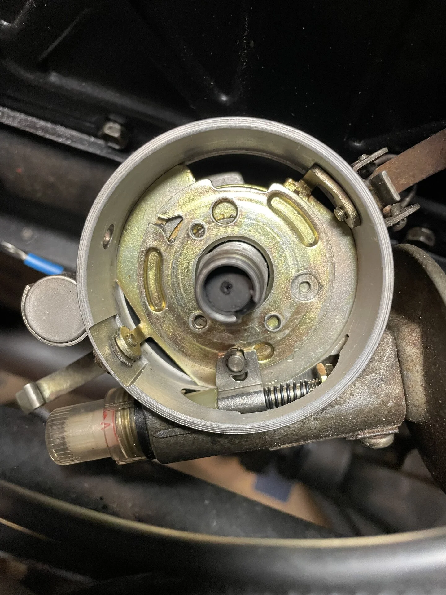

Thank you for all of the good info and links. It appears to me, and I may be looking at this wrong, that the hole spacing for mouting the base of the 1665A and the 91662 original or LS are both much closer to the cam than the points mounting holes in my dizzy.
It looks like I may need to swap out base plates either way. Might PM you to see what that would be.

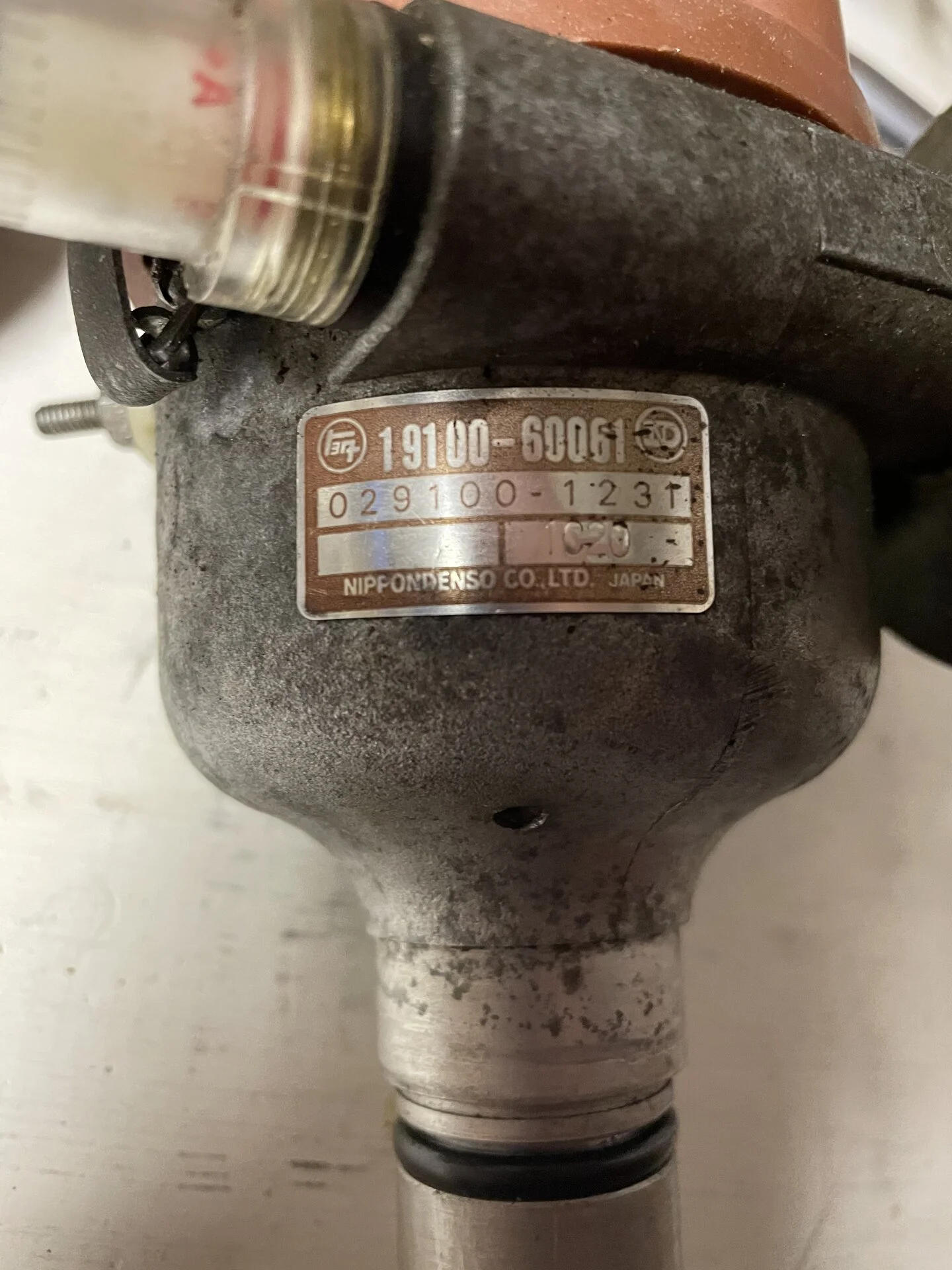

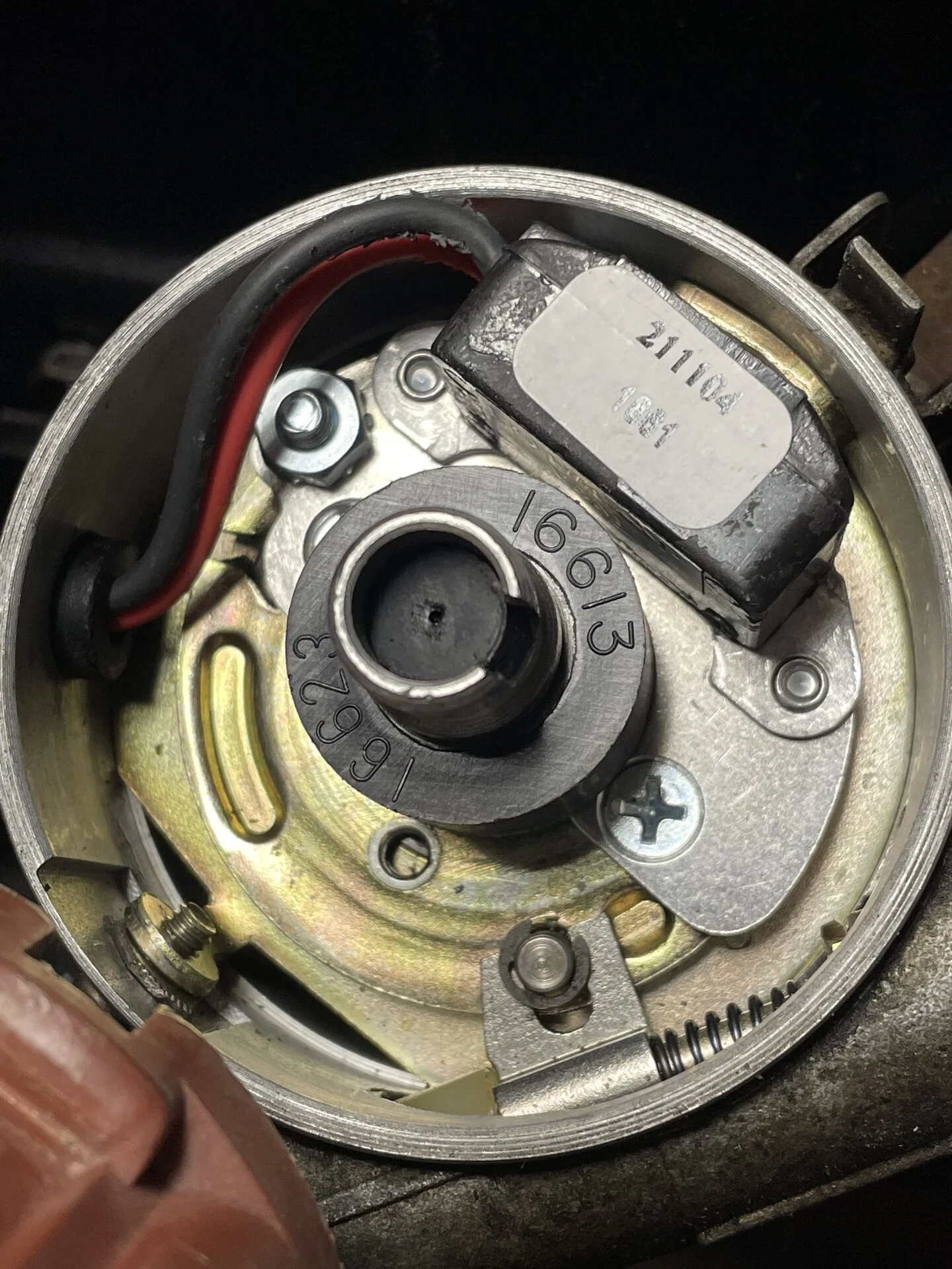

After spending some time on the phone with Larry at Pertronix, who was very helpful, he was able to determine that the correct igniter for this 19100-60061 vac advance distributor is 1661. So I returned the 1665A and order the 1661 which fits and works perfectly.

It is a bit elusive and takes some digging, as the standard vac retard dizzy matches with the 1665A, but the earlier vac advance dizzy has points screws which are closer to the center of the dizzy, which matches with the base of the 1661 igniter.

1971 FJ40, F engine with Nippon Denso 19100-60061 dizzy.
I am trying to make the switch from points to electronic ignition. Running this vac advance dizzy which runs good.
I am looking for a correct PN for a good electronic system that will fit this distributor base.
I tried the Pertronix 1665A, recommended fit for a 1968 (I believe this dizzy was original up to 1968?), but the base plate did not match up to the 19100-60061. Any recommendations on exact electronic makes and PNs, where someone has first-hand experience is a good product and fit?

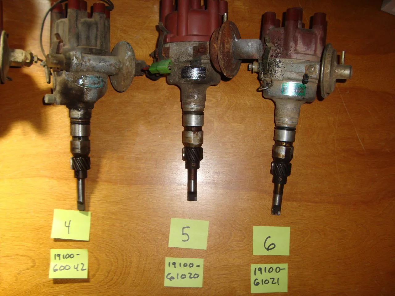

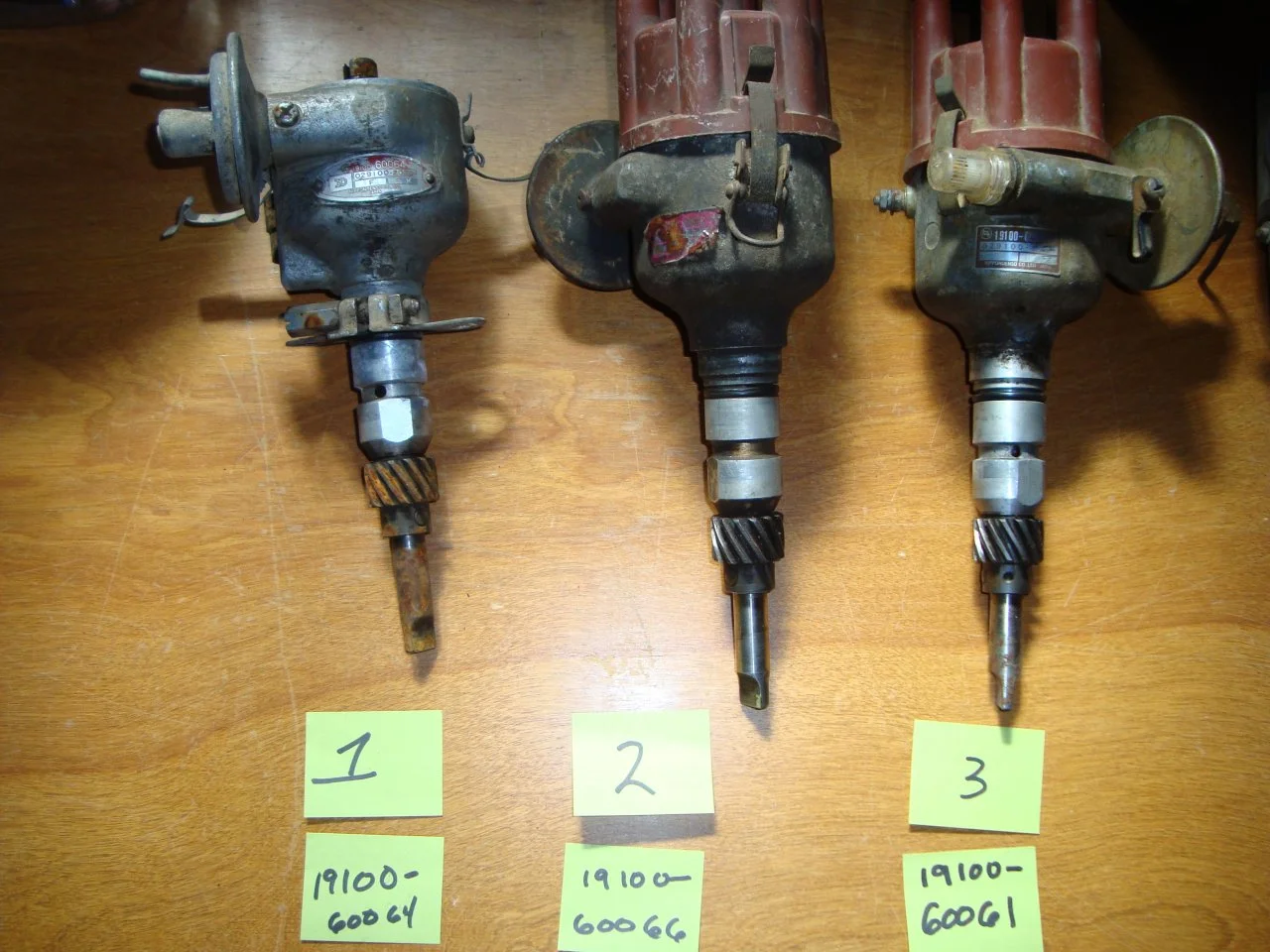

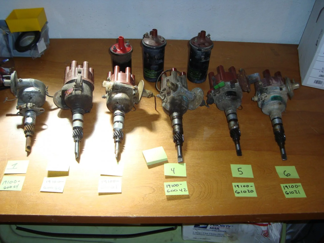

View attachment 3415376View attachment 3415377View attachment 3415378View attachment 3415379

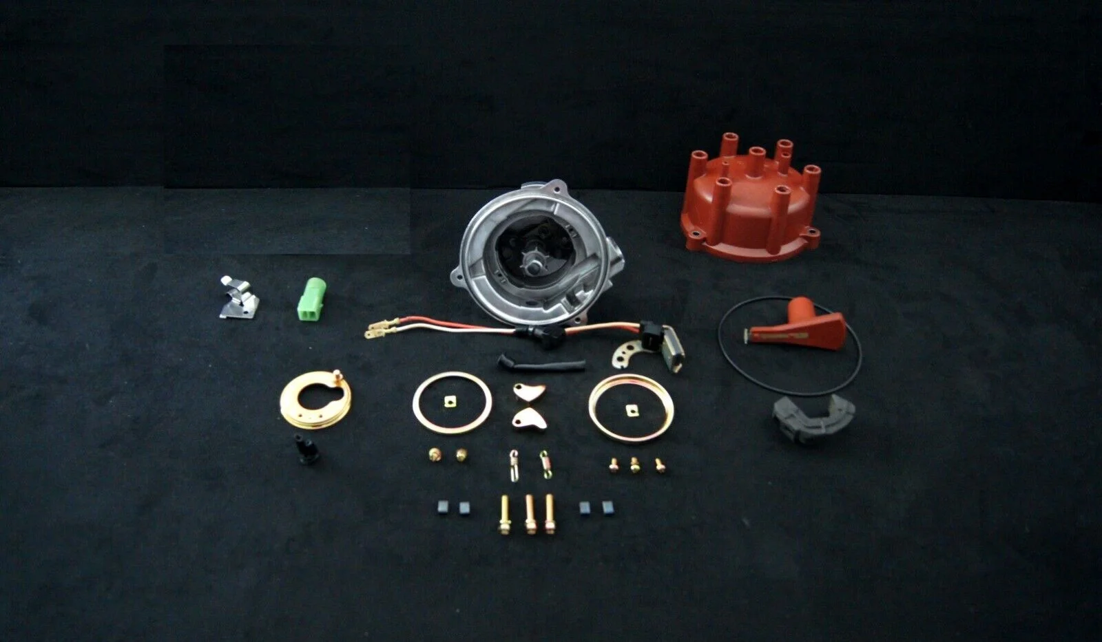

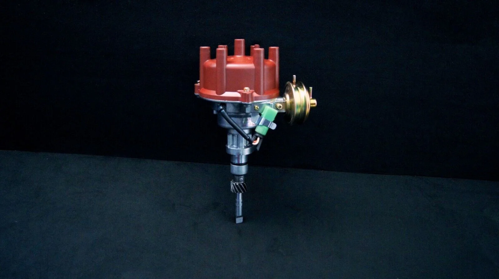

Engrain a set of facts into yourself , and even jot it down in your TEq Vehical Log Book ,
- your 60061 is a SMALL CAP style era 19100 ..........
- there are later era MED. caps
- and also a 8/80- later BIG CAP 19100-
- all 3 size caps were in-fact being used post 8/80-9/87 by toyota globally ...
- you always recall this , all your future 19100- time spent will be happy and bright .....
- see below :
the " BIG CAP " 19100-
