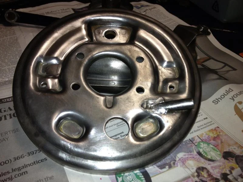

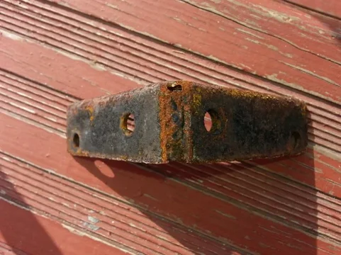

Man , those results are undeniable...looks like ill be using this method for all my small parts!

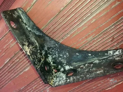

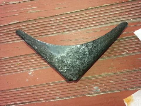

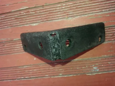

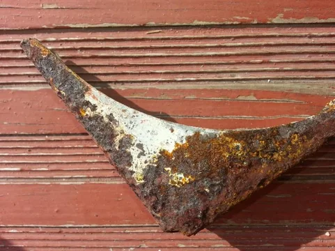

Looks like you have nailed the electrolysis technique. As early as you are in your project you could easily step up to a larger tank (rubbermaid totes work well). I agree that you should lose the plastic short protectors. I never found shorting to be a problem. I also got lazy and would often remove the parts , rinse them and use a hand brush to reveal fairly clean metal and shoot them with WD-40. That preserved them until I was ready to break out the grinder with a wire brush to prep them for primer. I would degrease them, wire brush them, degrease them again and etch prime.

Thanks Craig. I already am using one tote as my redneck parts washer. Heck, I could even stack them! I'm sure that an electrolysis process producing hydrogen gas, and a container of diesel fuel sitting on top of each other would be OSHA-approved safe. :-)
On the shorting - if the two electrodes (+ & -) touched, you'd get a short, no? Underwater welding would ensue would it not?

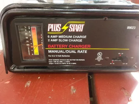

I just hooked up a battery to my bucket, with a battery minder to float charge it. I couldn't get it to run more than 6A on my big front end pieces: brake drum/backing plate, etc...
Just got to keep monitoring it and brushing it down then pull it when clean enough. I was pretty happy with the process. Some pieces it's hard to get a grinder/brush in there so having it done this way requires a lot less work and mess in the garage....
I read that article - interesting tip: "Too many amps means too much electrolyte. you should be pulling about 7 amps, if I remember right. Start with pure water and add your electrolyte a little at a time until you get up to 6 or 7 amps."
