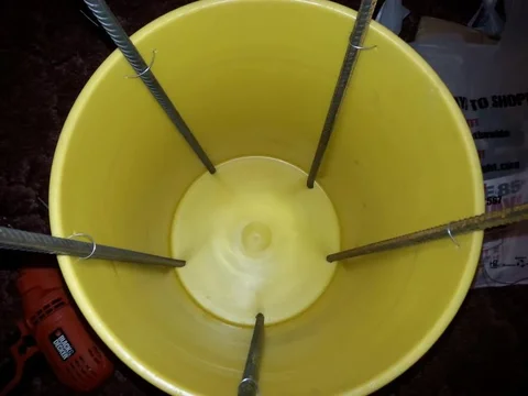

I drilled holes in the bucket to pull the tie wire through and secure the rebar to the sides. (I wasnt too concerned about how much longer the rebar is than the bucket - especially they are considered sacrifical and assuming that this experiment worked - then I was automatically moving to a bigger tub.)
Initially the holes I drilled were 1/2 inch apart - this turned out to be too far apart - if I wanted to SNUGLY secure rebar.

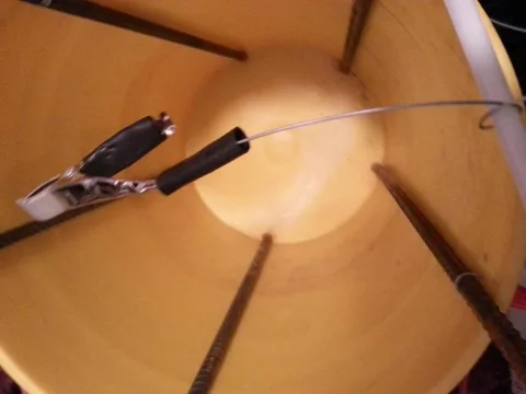

The charger (unplugged, unpowered!!!) Red "hot" charger connector went to exposed hanging red wire. The black Charger (negative) had to be connected to the bracket I wanted to de-rustify ;) I was so eager to get started, and I didnt want to use the copper wire, so I connected the negative cable to some of the steel tie wire, dangled it from a (non conductive, of course) plastic hanger

The black negative connected to tie wire, and then to another clamp which was in turn attached to the rusted bracket.( I wanted to specifically show this as this is where I was a little unsure in execution) The plastic hanger will be replaced as it is not stable enough..I have a bunch of granite slabs that are 2 inch by 24 inch - Ill probably one of them to secure the negative over the bucket.
Using the steel tie wire, there is no copper in the water solution.

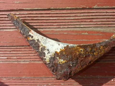

Here are pics of the rusted bracket before
Connected all wires, suspended the rusty bracket in the water solution - and hit the power. The bubbles started slow at the 12V-2A setting..after about 10 minutes, I flipped it up to 12V-6A and it really started cooking - bubbles I'd liken to simmering water from the rebar pieces and the rusty bracket. I let it cook for an hour..

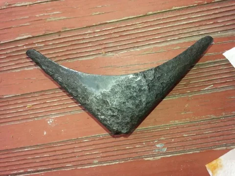

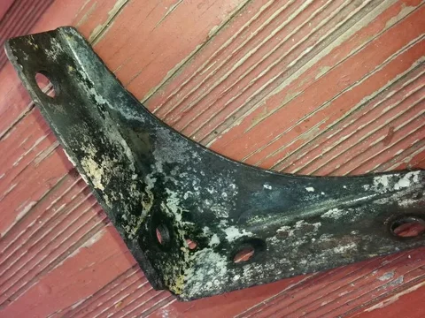

After 1 hour - below are the results. I was floored, flummoxed and seriously impressed :bounce: When I pulled it out I initially used a wire brush - (against some opinions) But it was pretty darn obvious that most of the crap rubbed right off. . so I tossed the wire brush - wiped it down- washed it-dried it with a hair dryer-then I hit it with Rustoleum Professional Primer..two coats.
24 hours later its obvious that I shouldve used something to efficiently coat the surface before laying primer..This particular detail will require more research :p

That's great. I'd let that piece go a bit longer but you're on the right road here. The step you left out is the metal passification step.
When I get parts out of the solution, usually everything left comes off with a bit of a rub down with some scotch-brite stripping pads. Anything that's black where the rust used to be, is good-that's magnatite and will not promote further rust or scale. Then coat the metal in metal prep and prime (like Ospho or equivalent) let it sit for 30 minutes and then wash off and dry completely. That step converts raw iron on the surface to Iron Phosphate which is also stable and a perfect surface to hold paint. It also prevents the flash rust you get otherwise.

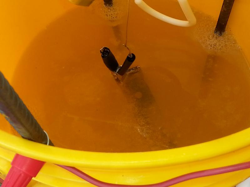

In the pic is a tank I "built" for de-rusting drag links and other long skinny parts by laying a garbage bag inside a long cardboard box, filling with electrolyte from my main tank, lining the sides with pieces of old computer cases, then laying the part on the bottom with plastic insulators. ( The orange insulators are re-bar caps!) You can see the blue light I was using to regulate the current. The current was too high due to the rods being very close to the bottom anode. The bulb regulated it down to about an amp (depends on the wattage of the bulb used).
