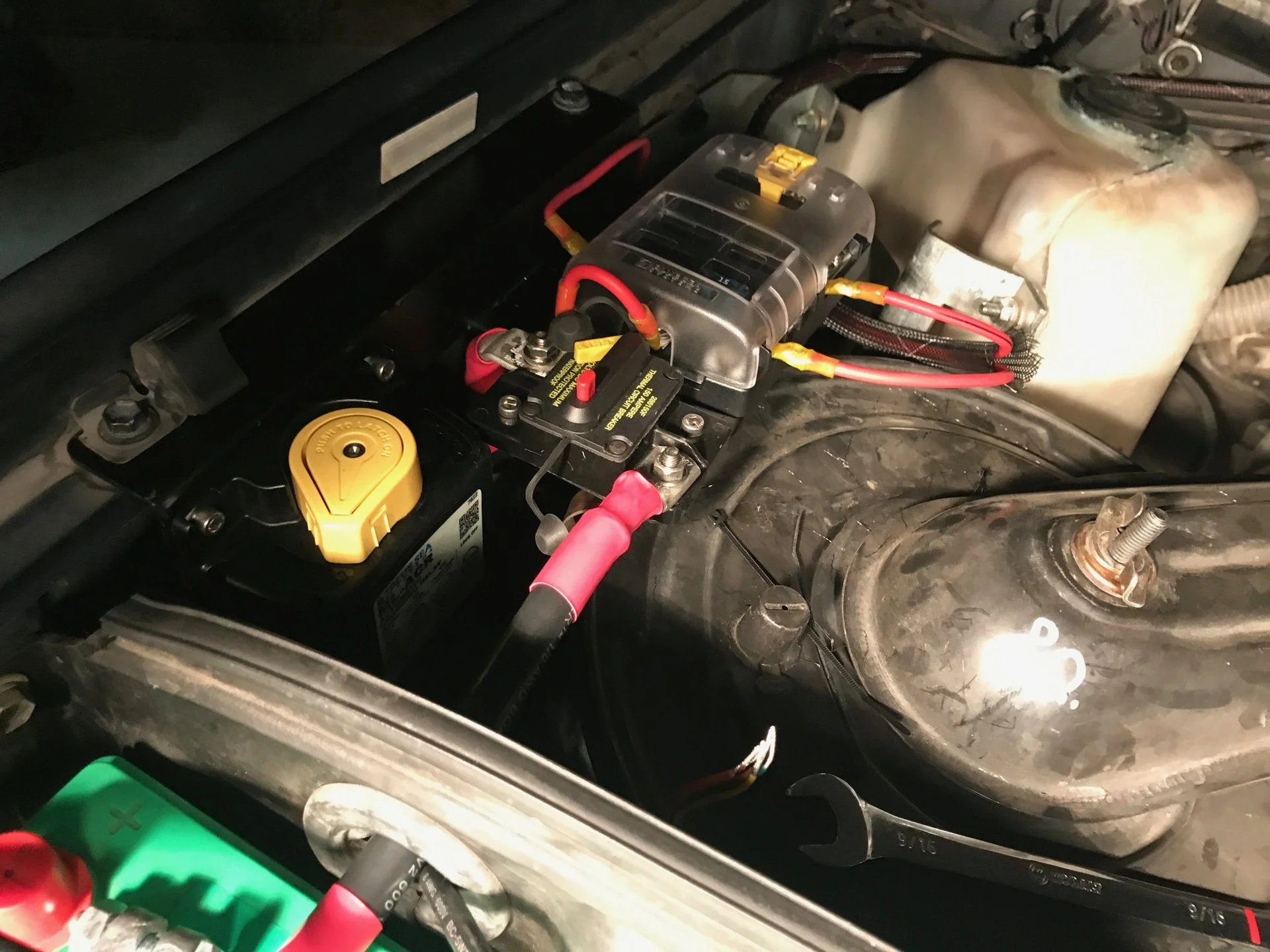

In my opinion most people use wire way to big for these smaller accessories. Also depending on the type of wire it can vary in size a gauge plus or minus. I used 4 gauge for my dual batter system. I have a hot wire from the second batter that goes along the driver side and then comes out of the carpet behind the second row seat and mounts to a blue sea on off switch, then goes to a fuse panel and also to a 750 Watt inverter. I was going to install inline fuses all over the place but I decided that they are well protected. I thoughtfully routed it and added additional wire loom. Anywhere it looks like it could chaff you can zip tie additional protection on there if you're paranoid. In my opinion even 4gauge is overkill for my application but I don't run a huge inverter and try to run power tools or something.
The extended winch wires are the same size as the factory wires so they're pretty beefy.

If only someone made a slick solution for mounting a breaker and a fuse panel for an aux battery system in an fZJ80. If only...

The inverter does not need to go through the blue sea fuse block. 1000 watts at 12 volts is about 83 amps. You aren't going to find a blade fuse for your blue sea fuse block to handle that. So I'd wire the inverter directly to your battery with a 100amp fuse inline close to the battery.
