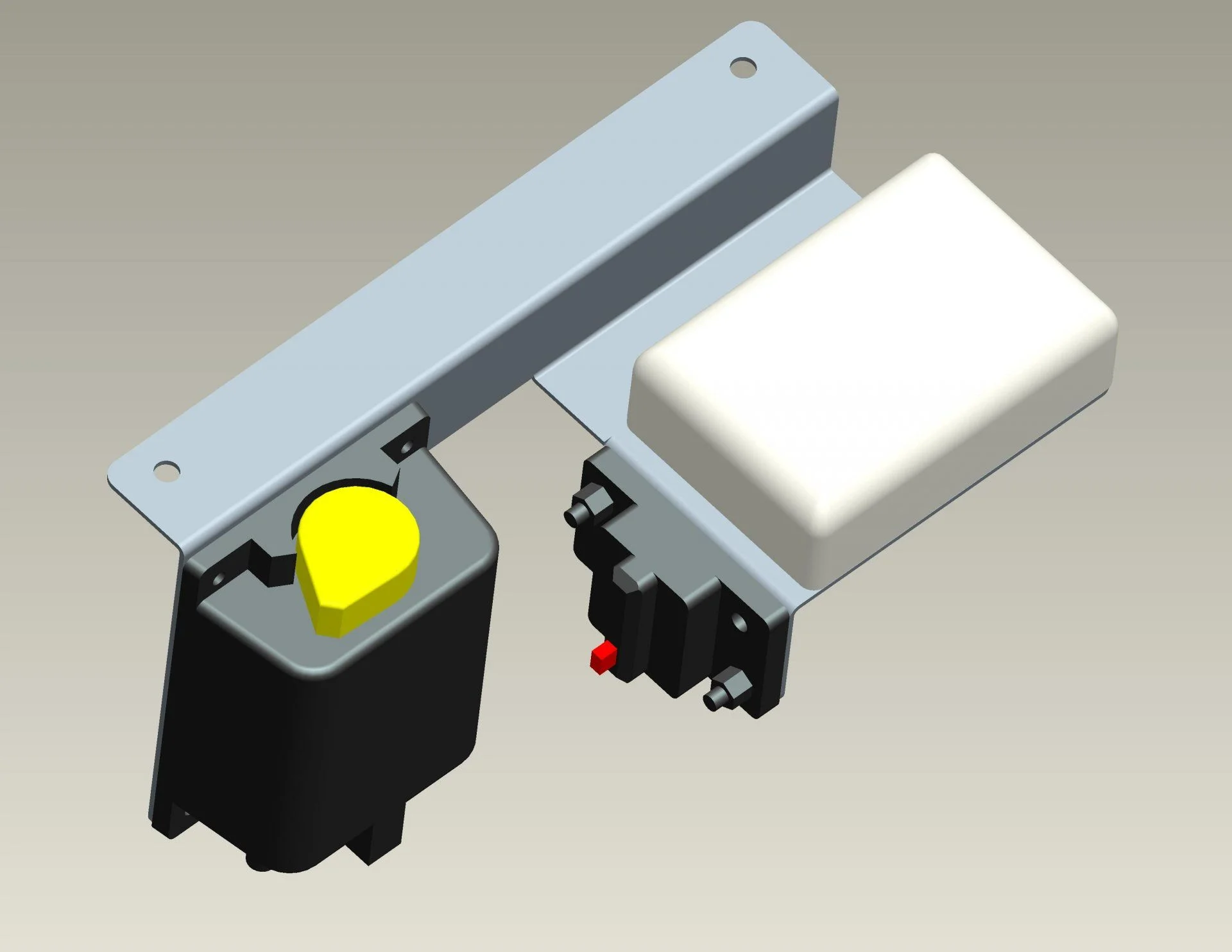

I have a viairp300 and a 1.5 gal tank will that work with your under vehicle bracket??
The P300 is the portable unit which technically could be made to mount by removing the bottom plate. You can fit the 1.0, 1.5, 2.0 or 2.5gallon tank. Each would require drilling new holes but it's really a non-issue.
