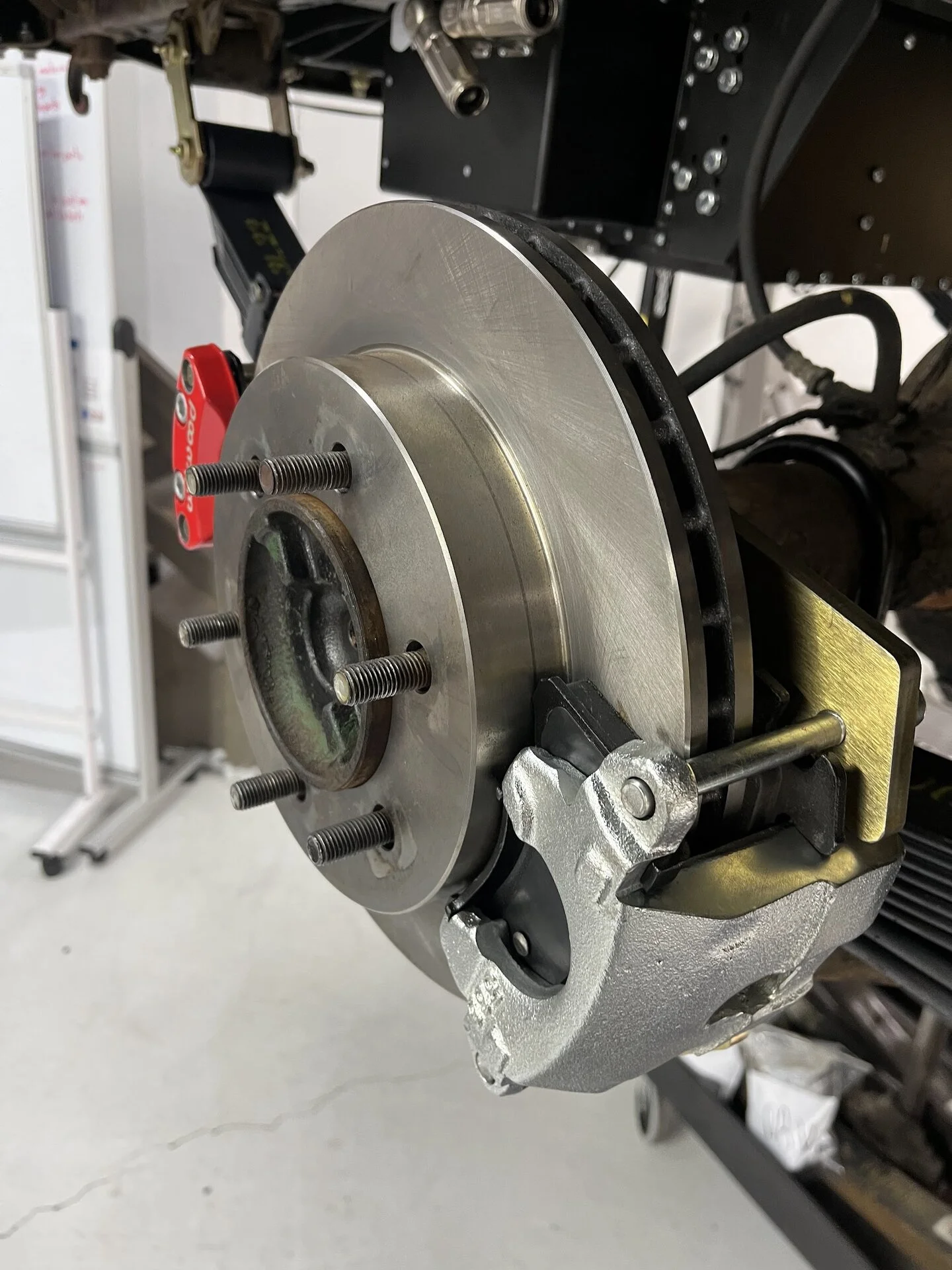

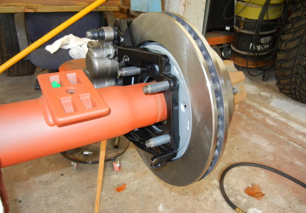

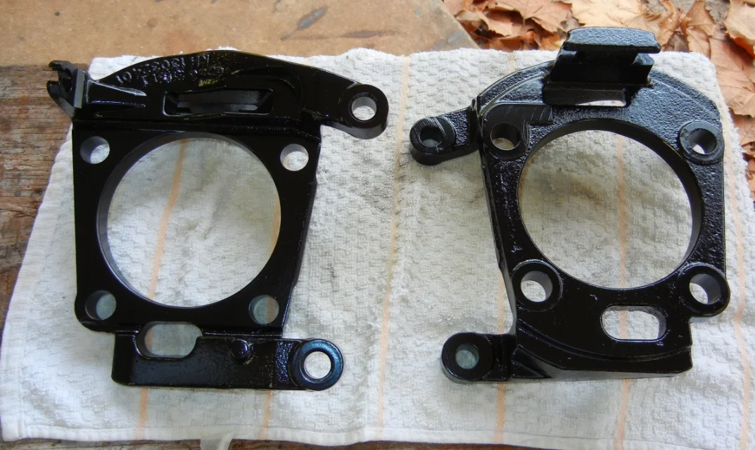

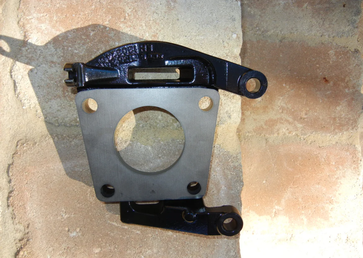

1) disc brake callipers with E-Brake. Nothing new, but they may work with my ‘79 Chevy rotors and brackets… still looking into. This picture shows the Eldorado callipers on a 8 bolt disc because I have been looking for disc brake options for my Dana 70 dually axle.
2) Sterling 10.5” backing plates that would with a drum e-brake in the centre of the rotor. The original rotors are 8 bolt and I don’t know if a 6 bolt rotor could be found with an e-brake drum in the middle.
I’m tracking down backing plates and hardware for a disc brake conversion on my Dana 70 axle. I probably won’t go ahead with that until the drums are worn out… I’m on the second set of shoes, and I’m pretty sure they will be beyond turning before I need a third set. When I get there, I’m going to check if they will clear a 15” rim… or if running them on my 40 would require a larger rim. I’d rather not change my 40 rims so it would be a deal breaker if they don’t fit under a 15” rim.
Here are pictures from fordmann.com | F-250: Dana 70U Rear Disc Conversion - https://www.fordmann.com/F250.Dana_70U.htm

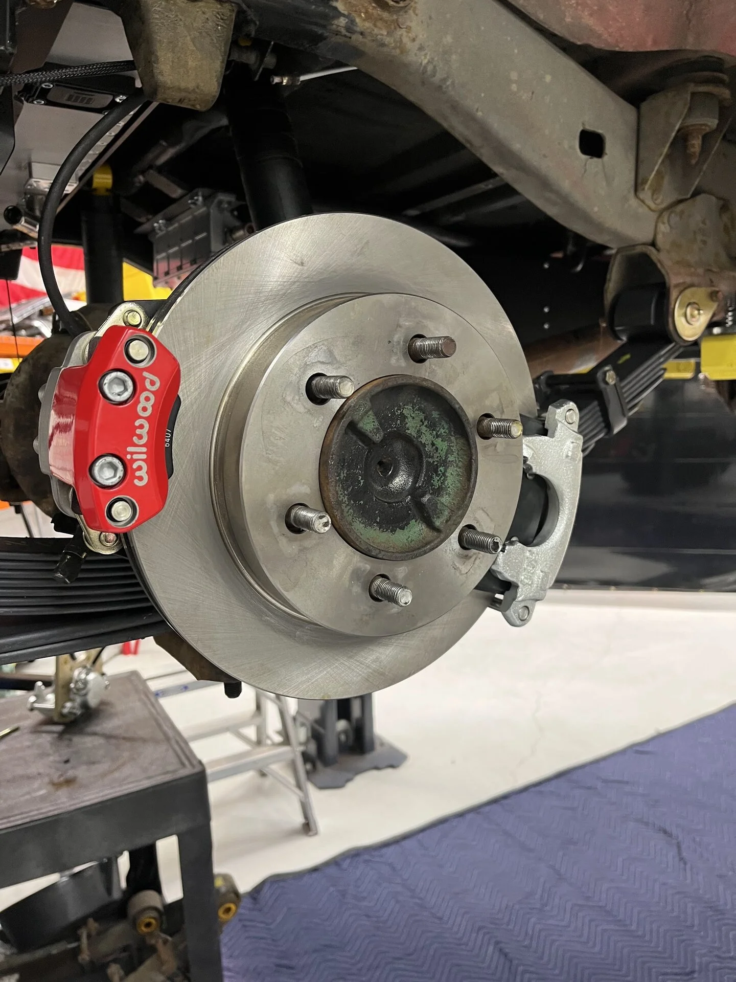

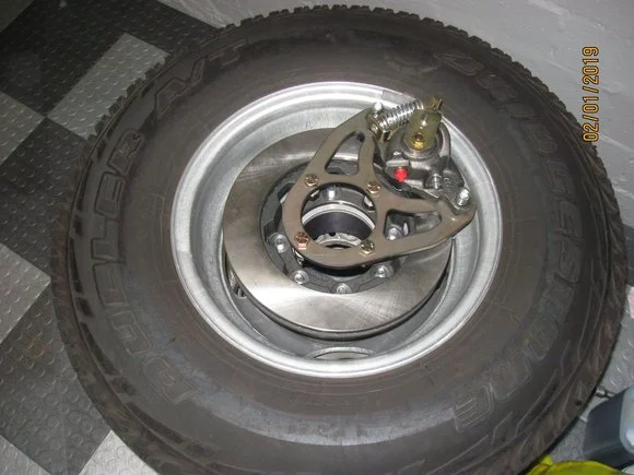

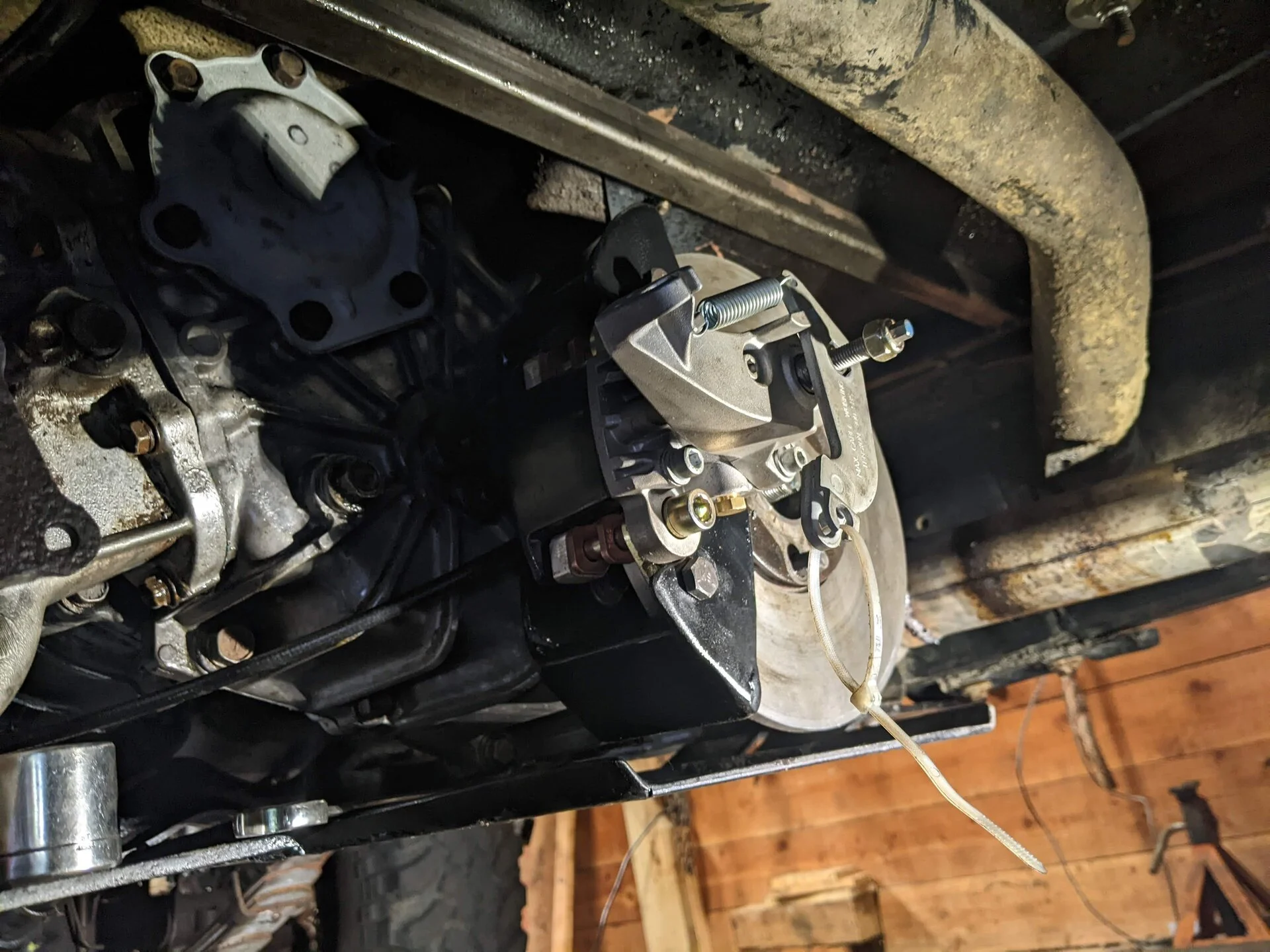

I used a Wildwood mechanical caliper on my tcase disc ebrake but it's kinda mediocre. Doesn't hold on much of a slope.

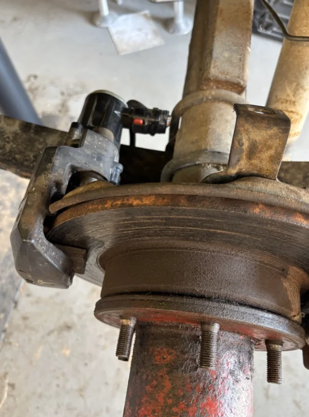

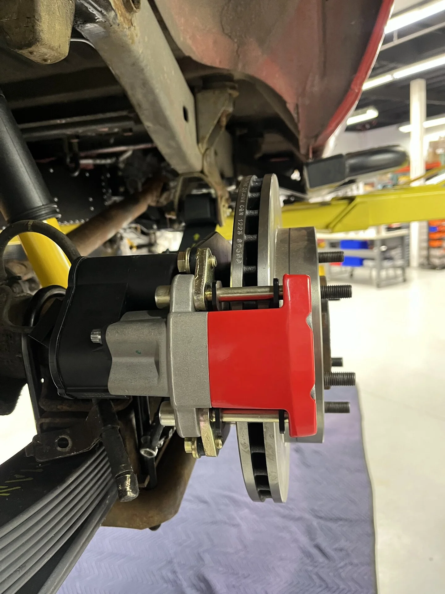

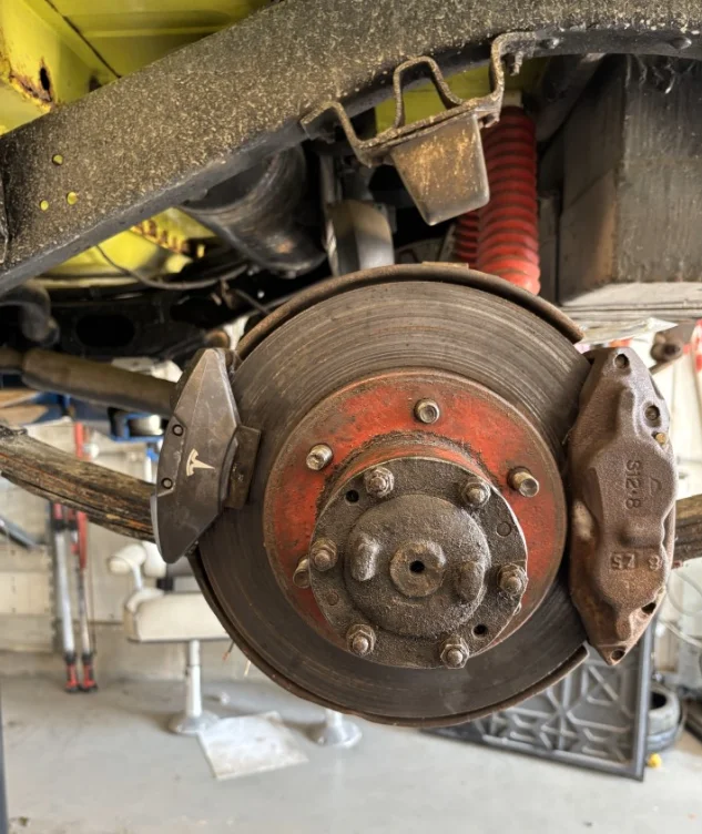

I got one side installed this weekend and tested it with 12 volts. It could probably be modulated to apply pressure gently but judging by the size of the pads, I'm not sure how effective it would be as an emergency brake. As a parking brake, however, it seems to have plenty of holding force. I'm going to wire it to a smart relay, activated by the factory parking brake handle. These come from a 2012-19 model S and say Brembo on them. I think the model X was the same.
If the rig didn't already have a working disc brake conversion using mini-truck stuff I would have looked at an integrated hydraulic/electric caliber. There are lots of options. The wreckers have lots of six-bolt Acadia/ Encore types of rigs that look right.

I'll give my mechanical one another adjustment before I bail on it. Think my cable is stretching or the jacket compressing. I always seem to be at the end of the pull levers travel.
