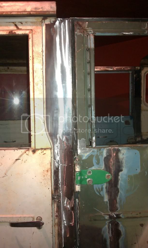

Kling-on, yes the top will not be coming off. Justin and I could not come up with a good idea on how to make it a complete two piece that would look good and give the b-pillar the strength to take the abuse as the door strike and secure the hinges for the abuse of second door opening and closing. Does this make sense?

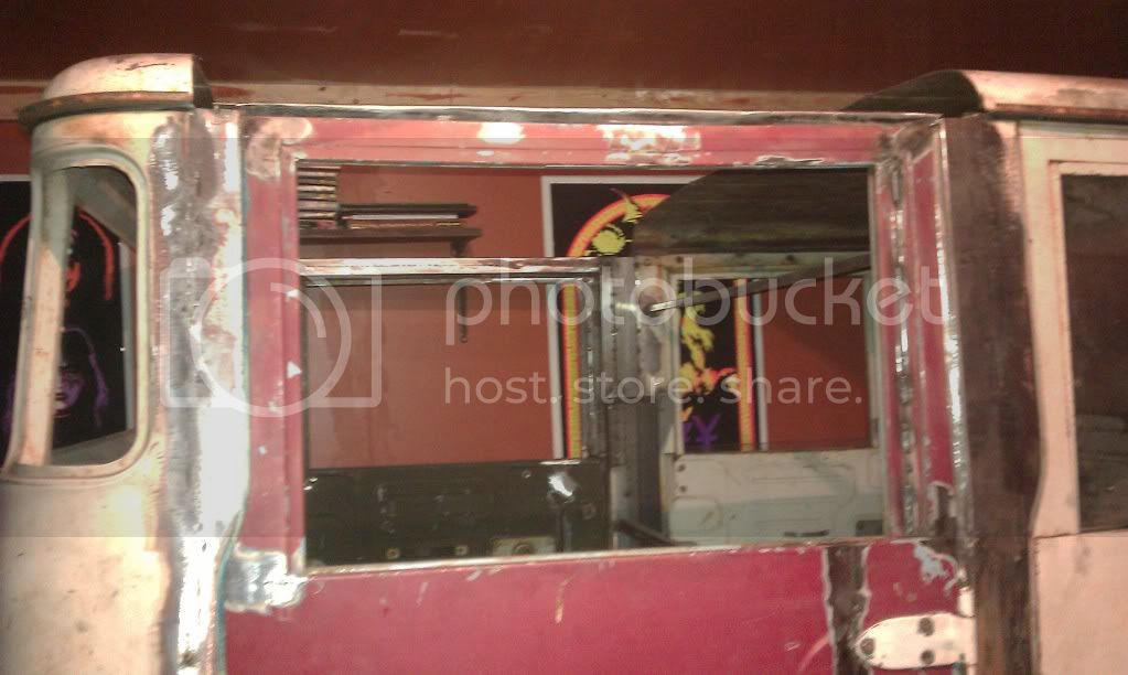

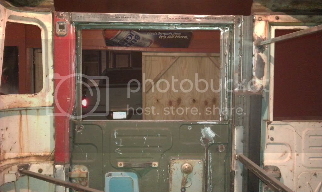

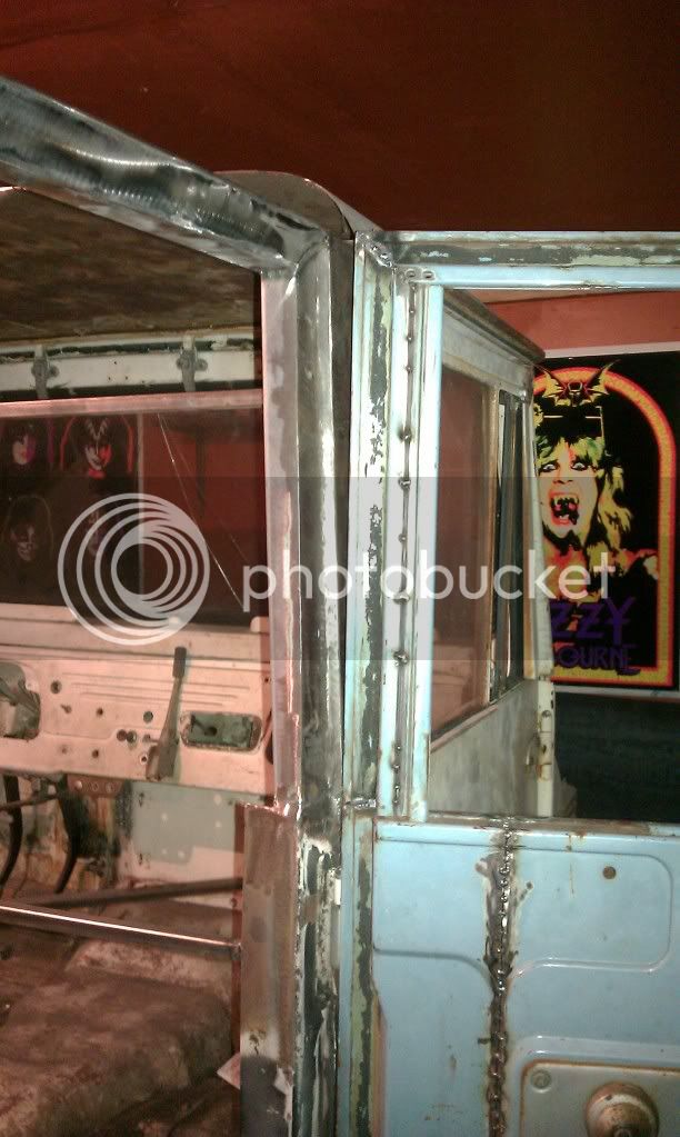

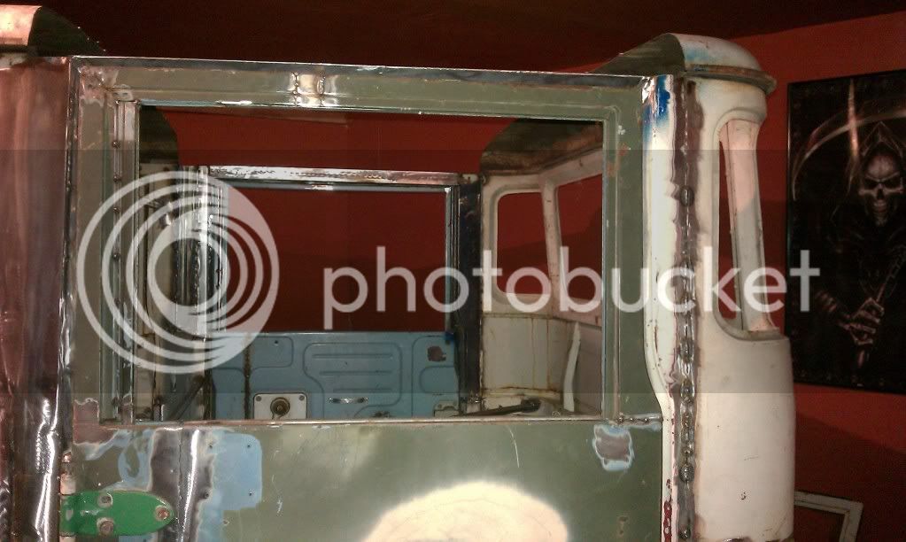

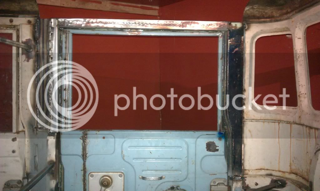

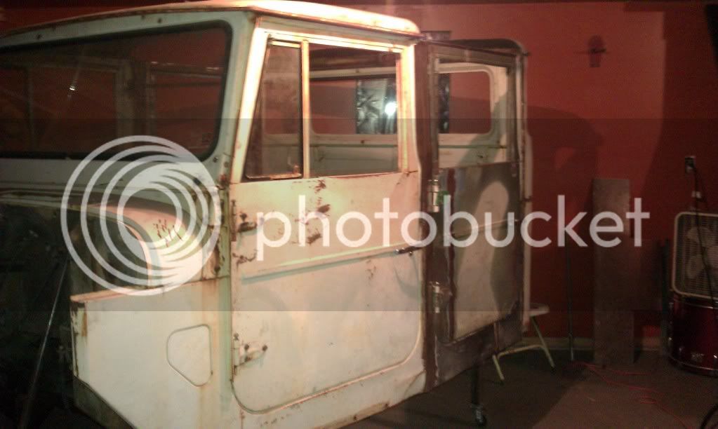

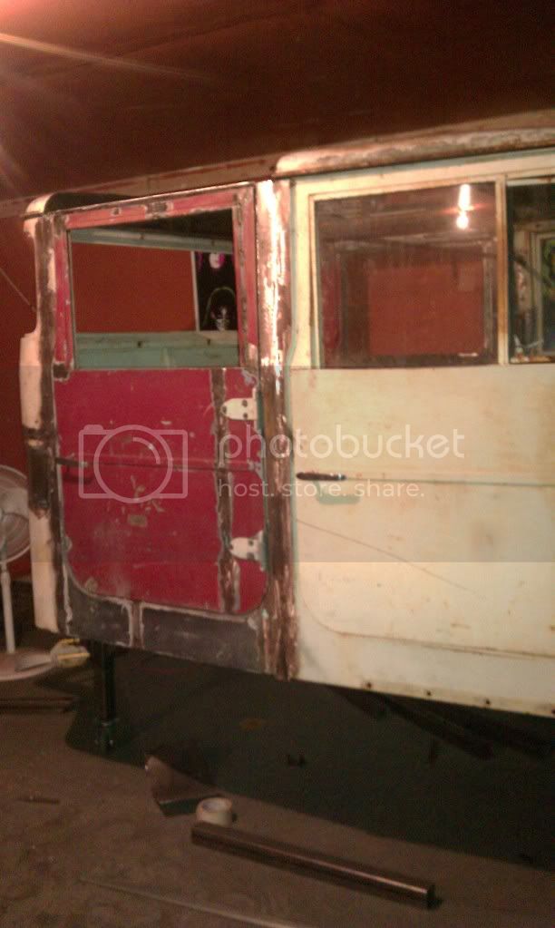

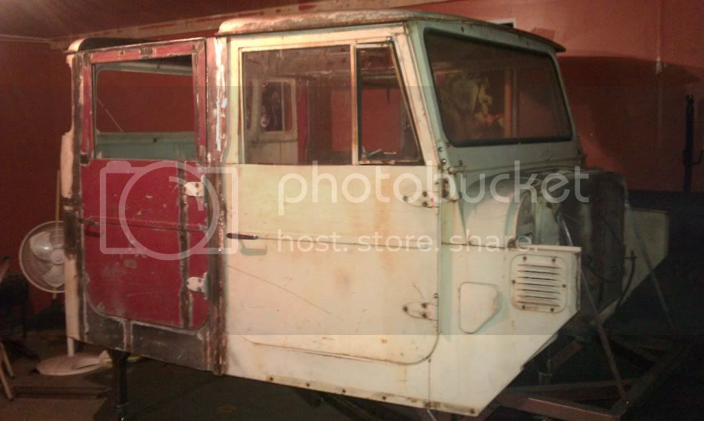

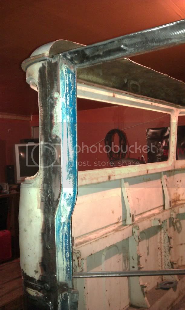

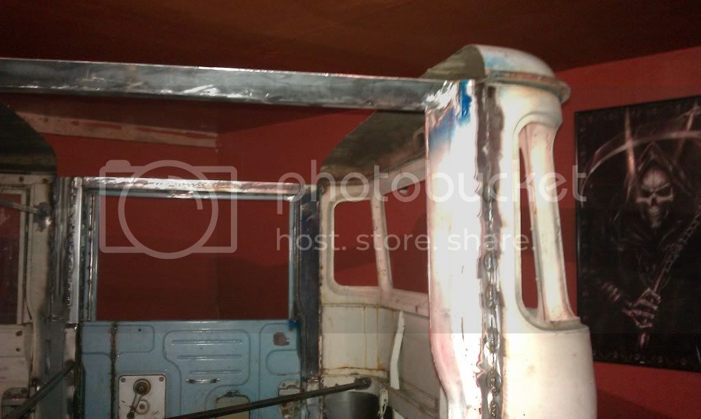

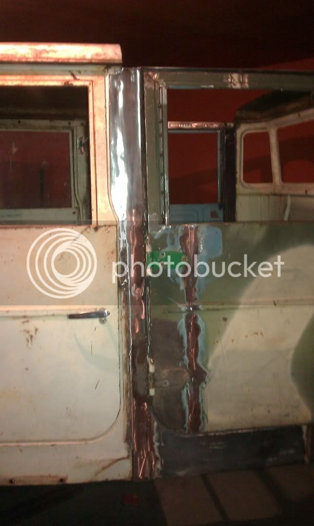

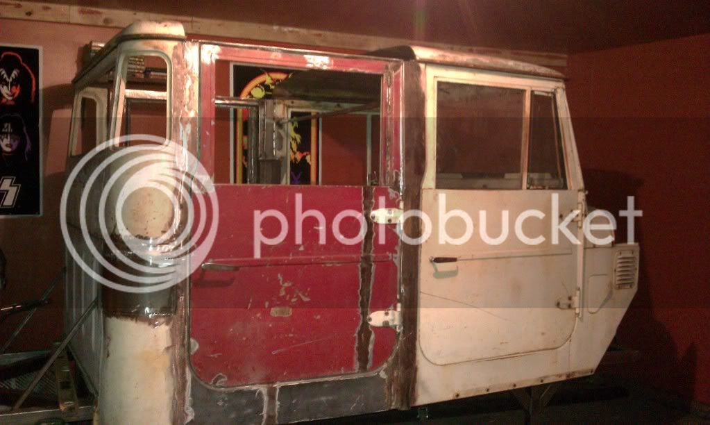

Well its been a week or two since I last posted-and here is where we're at. Most of the cab is done, both driver and passenger sides are done and everything is lining up pretty good. Still a little adjustments here and there, but I'm very happy with the progress so far. I'm hoping to have the roof done as well as floor fabricated by the end of the week and then finally off to the media blaster
I will post up inside length dimensions tomorrow

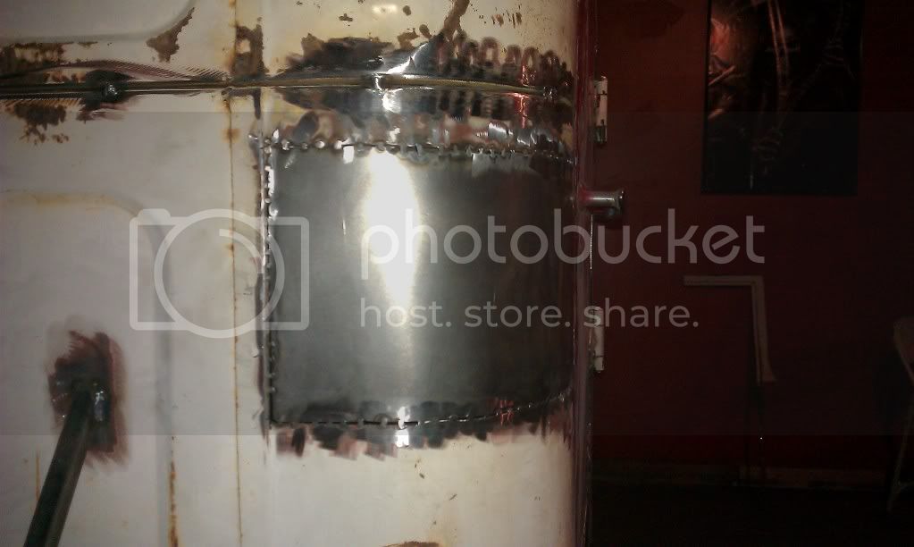

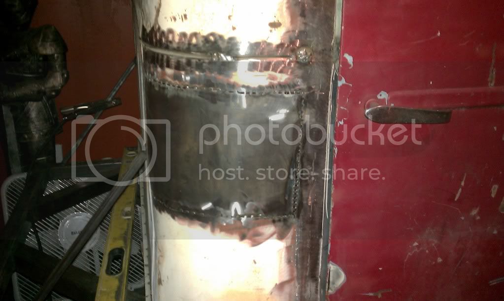

Frank did the cut out and welded the cover for the gas opening
We used 18 gauge steel

lenross1-we wanted to use 16 gauge steel, but with out a rolling tool it's real hard to make that bend with such a small piece. 18 gauge bends a lot easier and makes more sense to use for rounded corners. We will try and use 16 gauge for the roof as well as the new floor.
