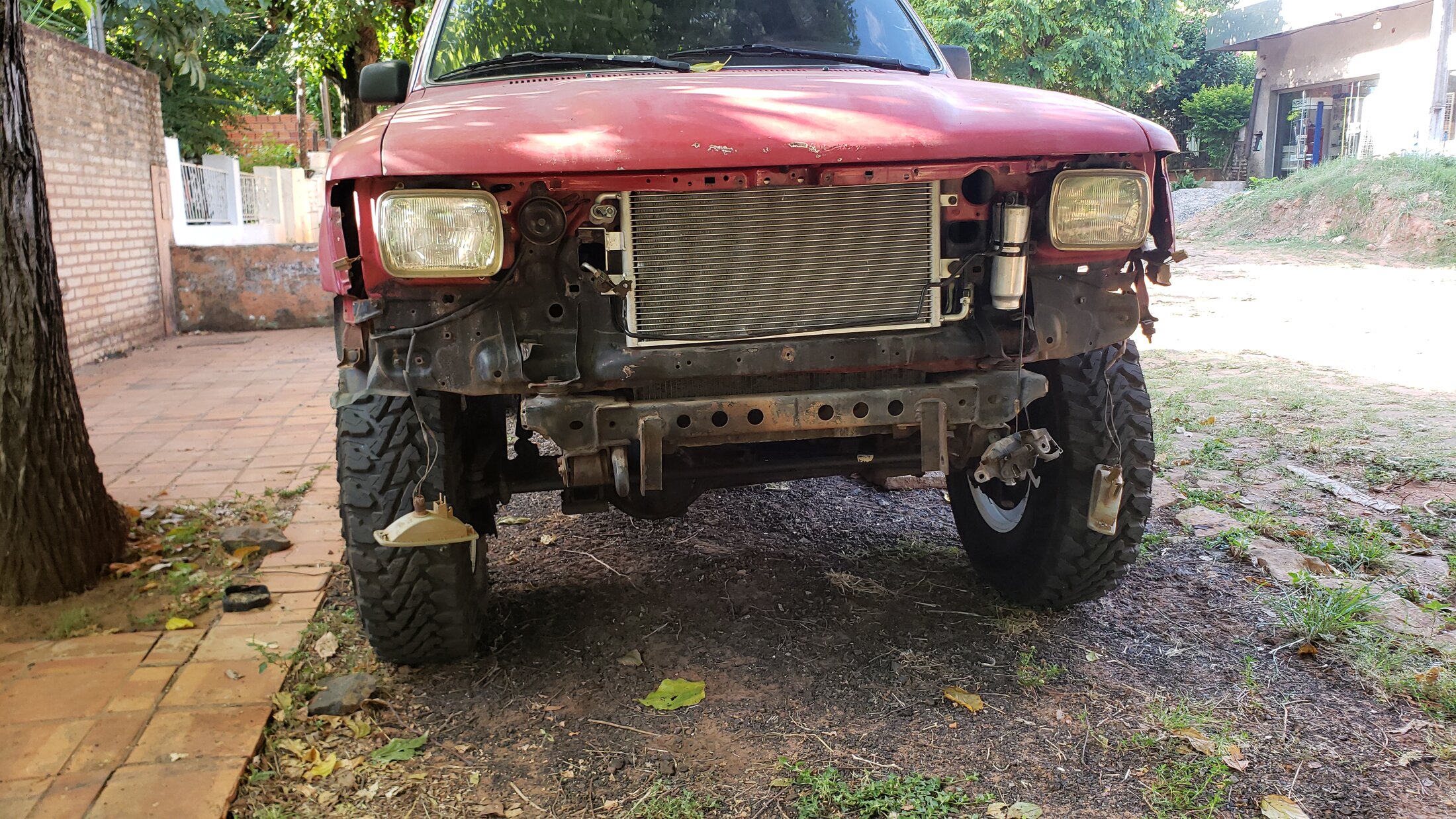

tore the rest of the junk out today. turns out the pump had also been eating itself, so im glad i went to all new bits.
got everything on the exterior dealt with. need to finish assembly of the evap box. im going to rewire and properly attach the condenser fan.
might actually have functional air by tomorrow afternoon.
the condenser fit was ok... really would have liked a denso. but such is life. still just constantly bewildered by people's inability to copy available parts. :rolleyes:
in hind sight it might have been worth chasing all the r134 parts, since this mission has taken months anyway :bang:
hopefully this will be the last time I have to touch or think about this system for a long while 🤣
so the old fan wouldn't fit...of course. it wasn't the correct oem part anyway.
i went ahead and finished up. dodged a bullet with a crossthreaded fitting. it was a massive leak. simple removal and it went back together properly. thankful the al is forgiving.
pulled and held vacuum. took a charge and now i have nice cold air.
