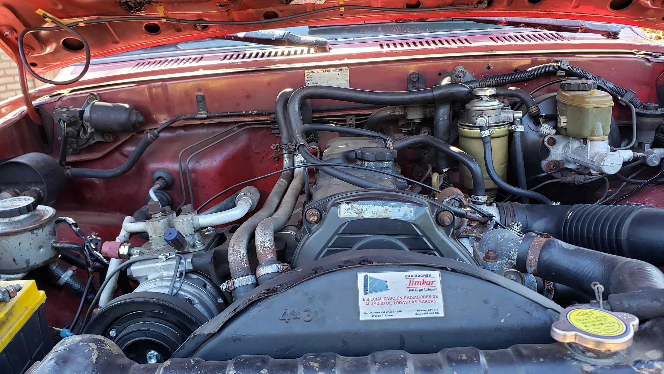

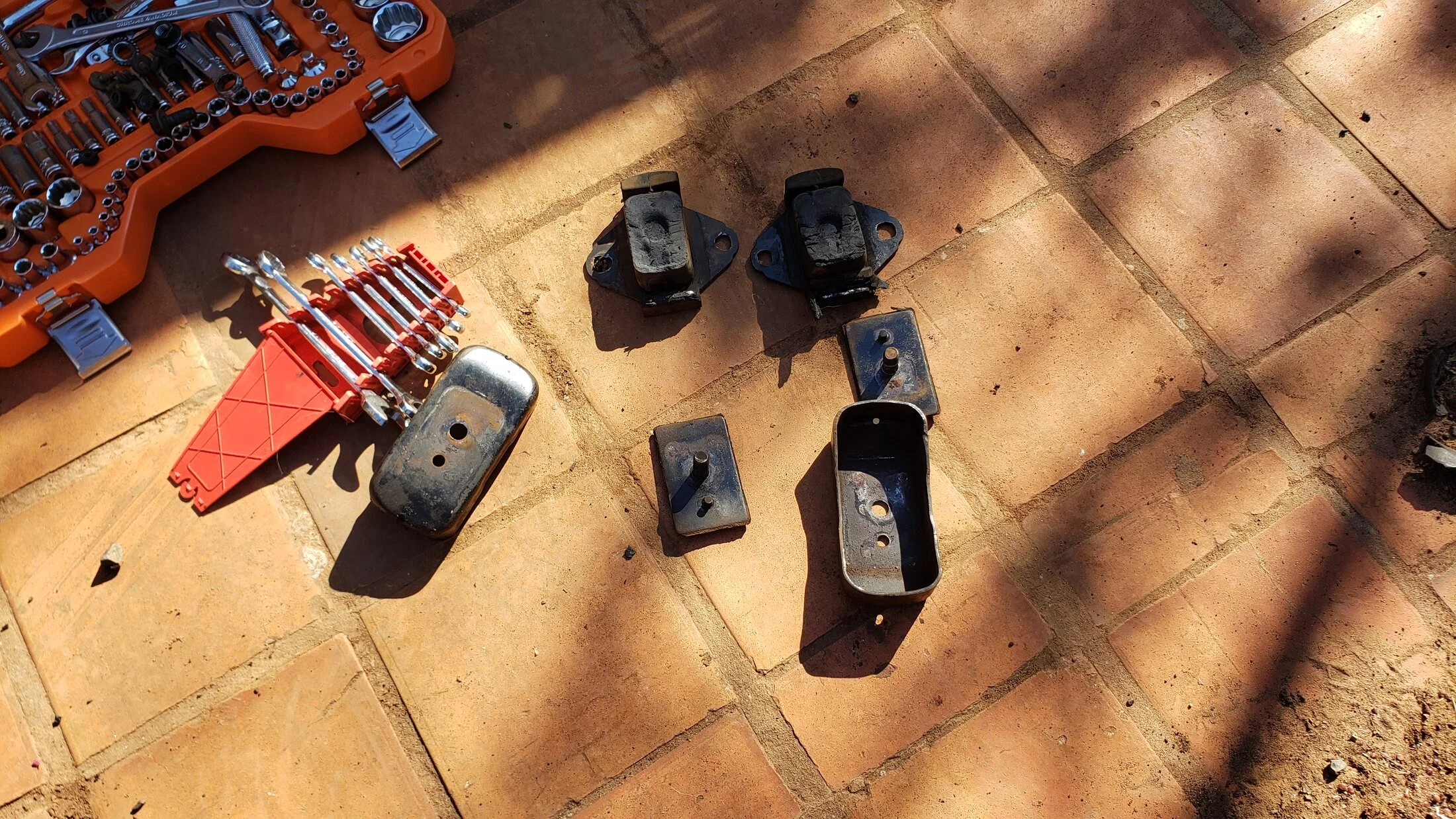

today shyt motor mounts sent the fan into the shroud. in reality i should have been all over this earlier but such is life. not like this thing is making hp or anything. mashing speed bumps too hard finished things.
local shop had replacement parts. blew this out pretty quick with minimal cussing

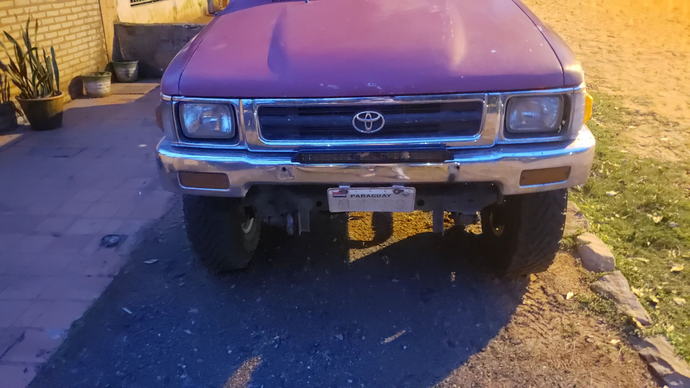

i also have a new headlight harness to install. Paraguay has a law about headlights and the wiring is questionable at best. i don't really like unnecessary convos with jackboots. this should remedy any chance of said encounter.
probably will pick up a light bar as well.

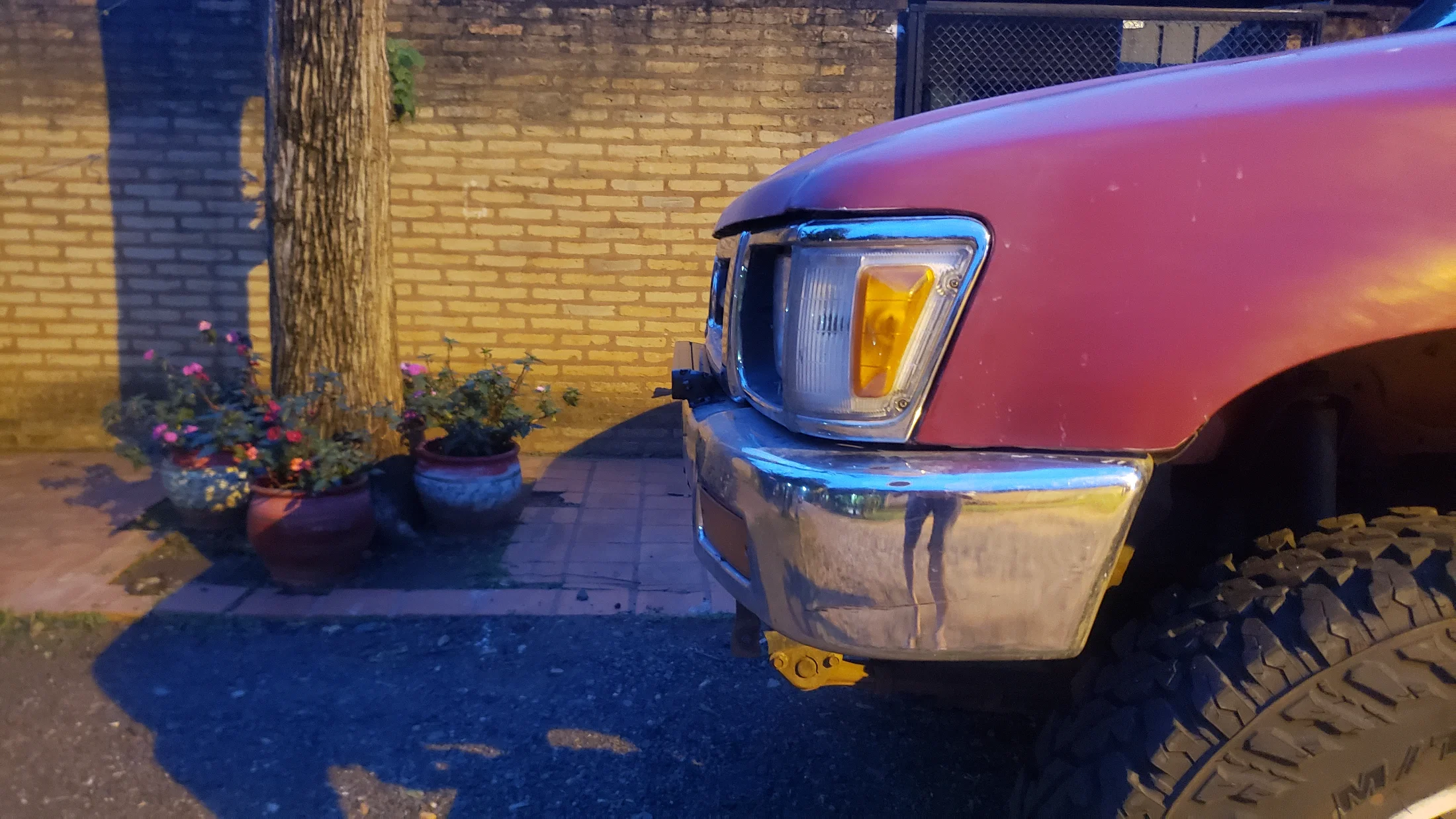

i added the headlight harness but it really didn't help much. kind of thinking these reflectors just suck aşş.

I tried doing upgraded wiring harness and new parts store 5x7’s in an old F250 and they still light up the road like sh!t. The only real upgrade anymore is Hellas or going to projector retrofits/HIDs it seems like
idk. my 89 is fine with old skool sealed beams. i just cranked the adjustment up a bit and they are good enough. i do still have a 100w bar on it but didn't really use it much on road.
these are h4 drop ins. they are depo brand reflectors, and they just throw a shyt pattern. some of the surfs here use an oe kioto reflector. i might try a set of those at some point.
my 2000 used to eat drop ins every year. to say that im less than impressed with this style of bulb would be a vast overstatement. imo they are absolute garbage.
just took this bar for a drive to check adjustment and its exactly what i was looking for.
The patterns has been my biggest issue and I tend to notice a s*** pattern with the seal beams that are considered the "brighter" ones. They also were tiny little squares even with upgraded wiring harnesses which is why I did the HID kit on my 84.

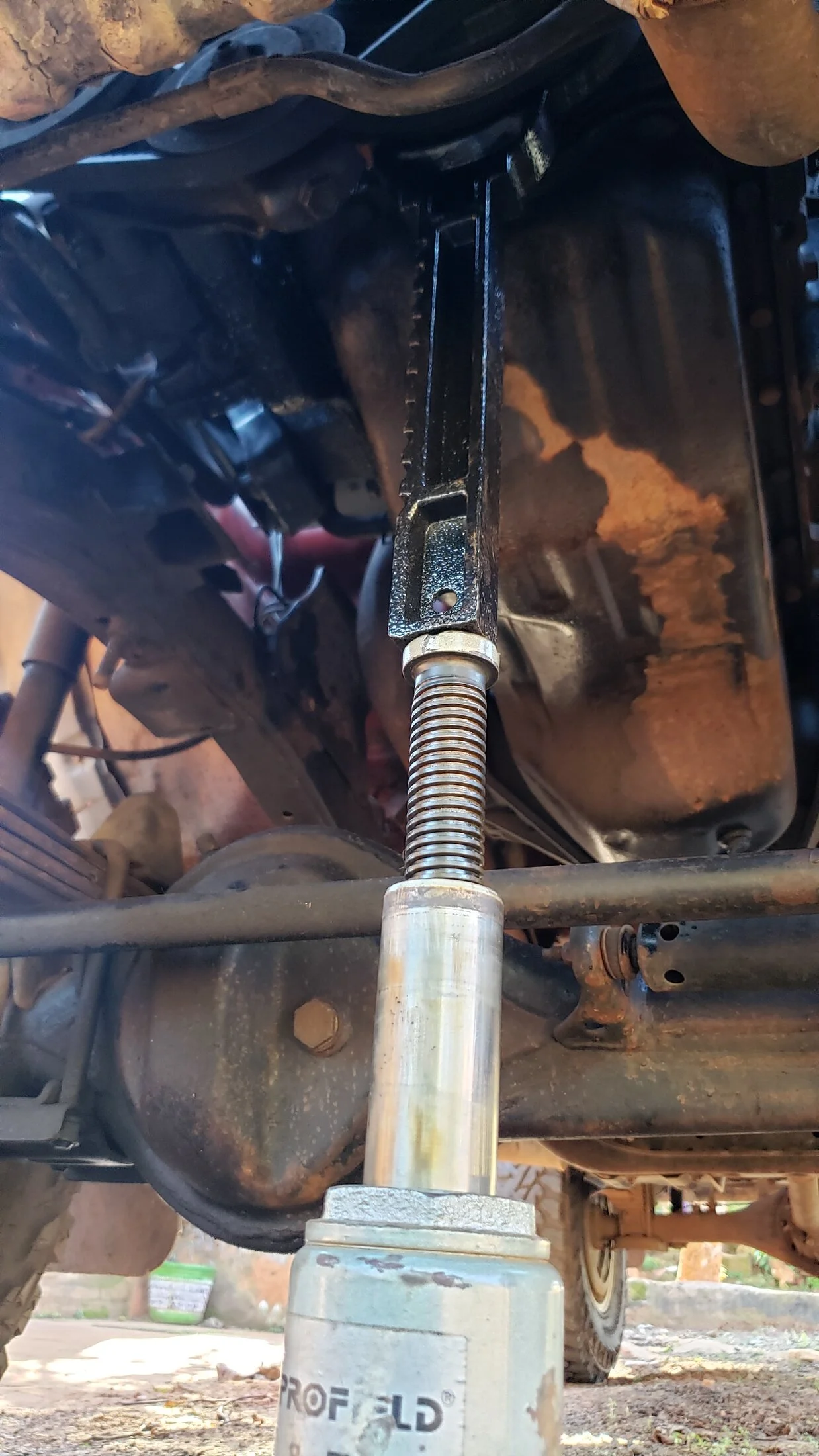

today I put this back together. was slow because of being my first time being this deep.
i scored a good used pulley, timing gear, keys and plastic cover. i changed the tensioner and regreased the other tbelt idler. new crank seal.
i modded another crank pulley bolt to work here.
it appears the root cause of the problem was the incorrect pulley bolt. it looks like it was bottoming out the threads before clamping the pulley properly. the bolt shown had the stock 5mm washer with another pos stacked. there was also another piece of something living between the pulley and timing gear that didn't belong there.
new bolt was installed with copious amounts of loctite 😂
