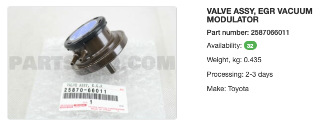

The time mine failed smog, passed everything except for the vacuum test, all I replaced was the EGR Vacuum Modulator. Then retested for free and passed with flying colors.
