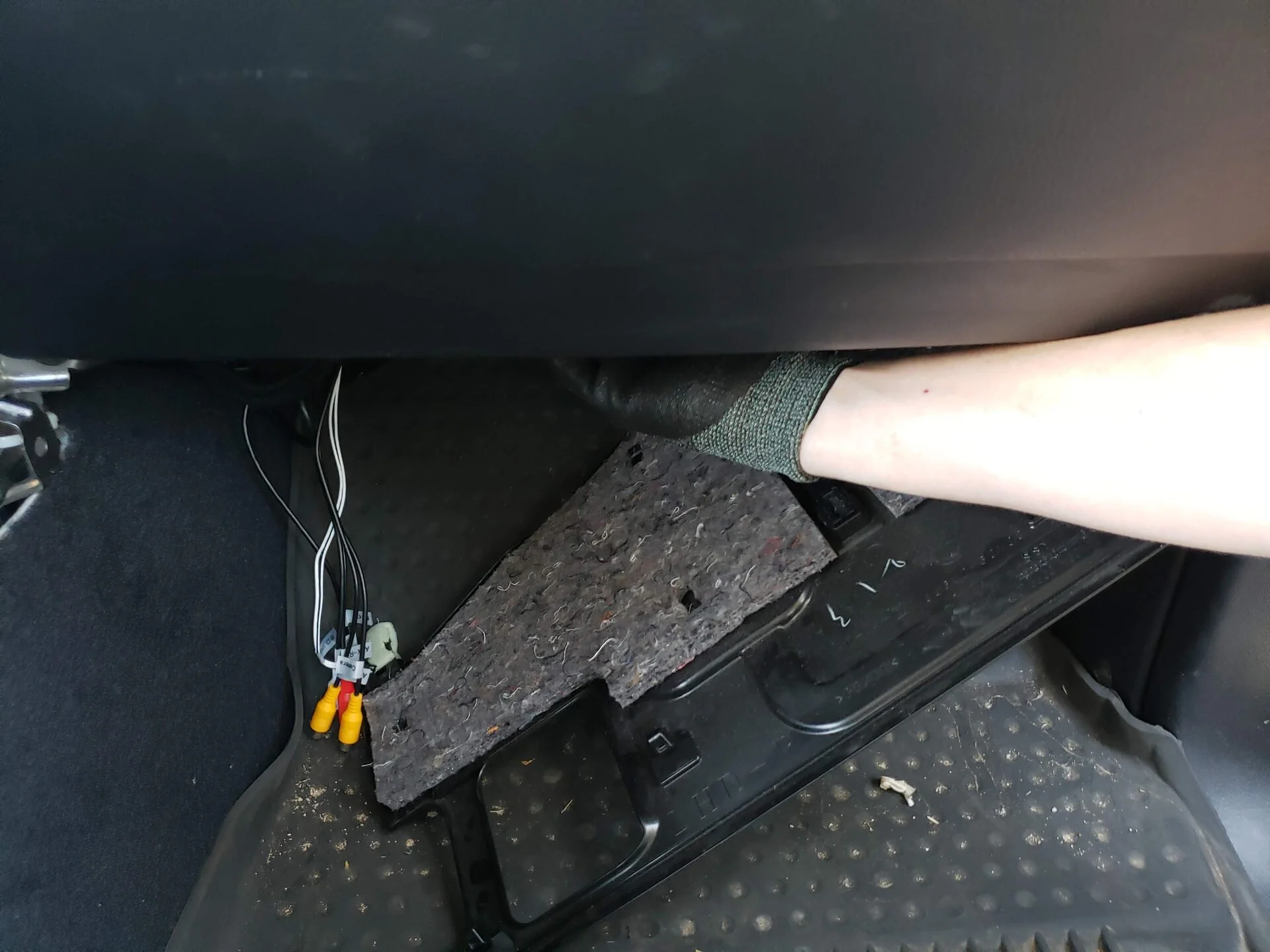

I'm in the middle of an install and am wondering what to do with the yellow RCA. It says in the instructions "plug it into the module" My CD player/module has no RCA jacks. Is this perhaps because I have an HE and no rear screens? Anyone know what to do with all the RCA cables, especially the yellow as it was mentioned specifically?
Yellow RCAs are for video, so no, you don't need to connect those.
It's not used. I don't see it mentioned in the instructions? (I've attached the instructions I used). Even those of us with screens in the back don't use it, since we have to use a separate HDMI cable for that.
