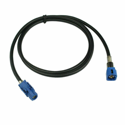

I sent in a video of the wiring setup to EC and they told me the LVD cable was kinked. Mind you, this was the new, pristine LVD cable they sent me for me install was kinked. Either way, it's out of the car. I'm just going to hang an iPad mini off the center speaker with a magnetic case and move on with life.
Anyone have a supplier for these LVDS or LVD cables? My wife is pushing me over the edge to re-install the EC unit so she can have CarPlay when she drives the 200.
I'd like to stockpile some of these cords since they have been the weak link for me. I checked Alibaba but can't get things narrowed down enough to find the supplier.
I have a bunch of them. I got them from here:
Nevermind, this is not what you want.
@Cincodemustache But wait... Hold on. I think those are just extensions, and might be different on one end from what you want. I think I might have misinterpreted the picture you posted. Check first, and post back here?
Thank you. You are correct. It’s a split cord. I’ve searched the labels on the tag too.
Inlet for factory plug
Plug to OEM screen
Plug to interface unit
How many times have you replaced yours?
My issues ended up being the entire unit, which they replaced, but I would be down to have a spare or 2 of these just in case.
I’ve been through 2 cables. For me, they were getting bent just slightly enough to cut the video feed to the screen/flicker. EC confirmed it is a common issue.
Interesting. This must be what's been happening to mine the past few weeks.
FWIW, I'll be putting my entire interface module unit, complete with the cables, up for sale at some point. I switched over to one of the Tesla style units and am certain that I won't be switching back. If any of you just want the LVDS cable though, I suspect we'll be a bit too far apart on price for it to make sense.
