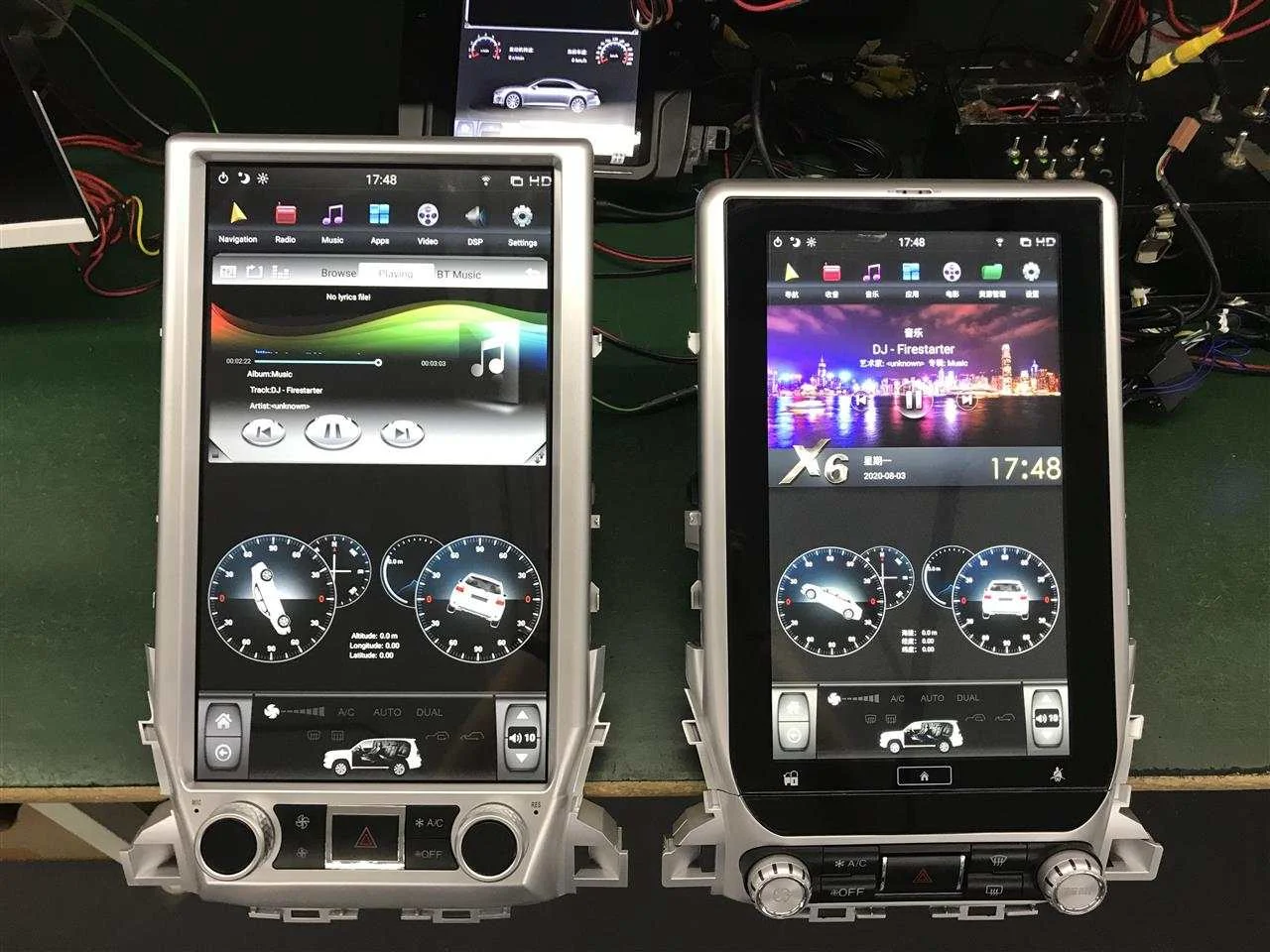

On another note, I currently have a Tesla style head unit on order that will hopefully arrive for the upcoming long weekend (it depends on how fast it moves through customs, etc. on the way here), so my current EC Offroad interface module will most likely be going up for sale in the relatively near future and also means that I won't be paying as much attention to this thread or updating the first post moving forward. Of course, if the Tesla style head unit ends up being a disaster, I'll switch back to what I have now and the prior couple of sentences can be ignored :). For me, the biggest problem with these interface modules is that we end up still being stuck with the low resolution screen the LC comes with. The Tesla style unit should take care of that and make navigation apps a lot more pleasant to use.
^^Definitely looking forward to hearing how the TESLA style unit goes…
I'll keep you posted. The tracking info claims Friday is the delivery day. Fingers are crossed as the long weekend would be a good time to do the swap and give me time to get comfortable with it before the trip I have planned later in July...

I would suggest starting here as it's probably the most relevant to our 2016+ Land Cruisers:
That thread is discussing the product I ordered and is where I'll post about how my install goes and any new tips that I have to add beyond what the OP has already found. The OP in that thread has done a pretty good job of explaining the install process and overall experience so far. Unfortunately, he didn't post detailed photos of the exact connectors that were used, though it sounds like it didn't differ much from the EC Offroad videos he linked to the first post.
Compared to buying from EC Offroad, the purchase process is a bit unnerving as it's sort of through alibaba, but not as an official alibaba transaction. Payment has to be sent to the manufacturer via wire transfer, so there's a time period (a few days) between sending the money and getting a tracking number where you're left wondering if you entered the correct info for the wire transfer. But the price ends up being less than half of what EC Offroad charges for their Tesla style unit.
