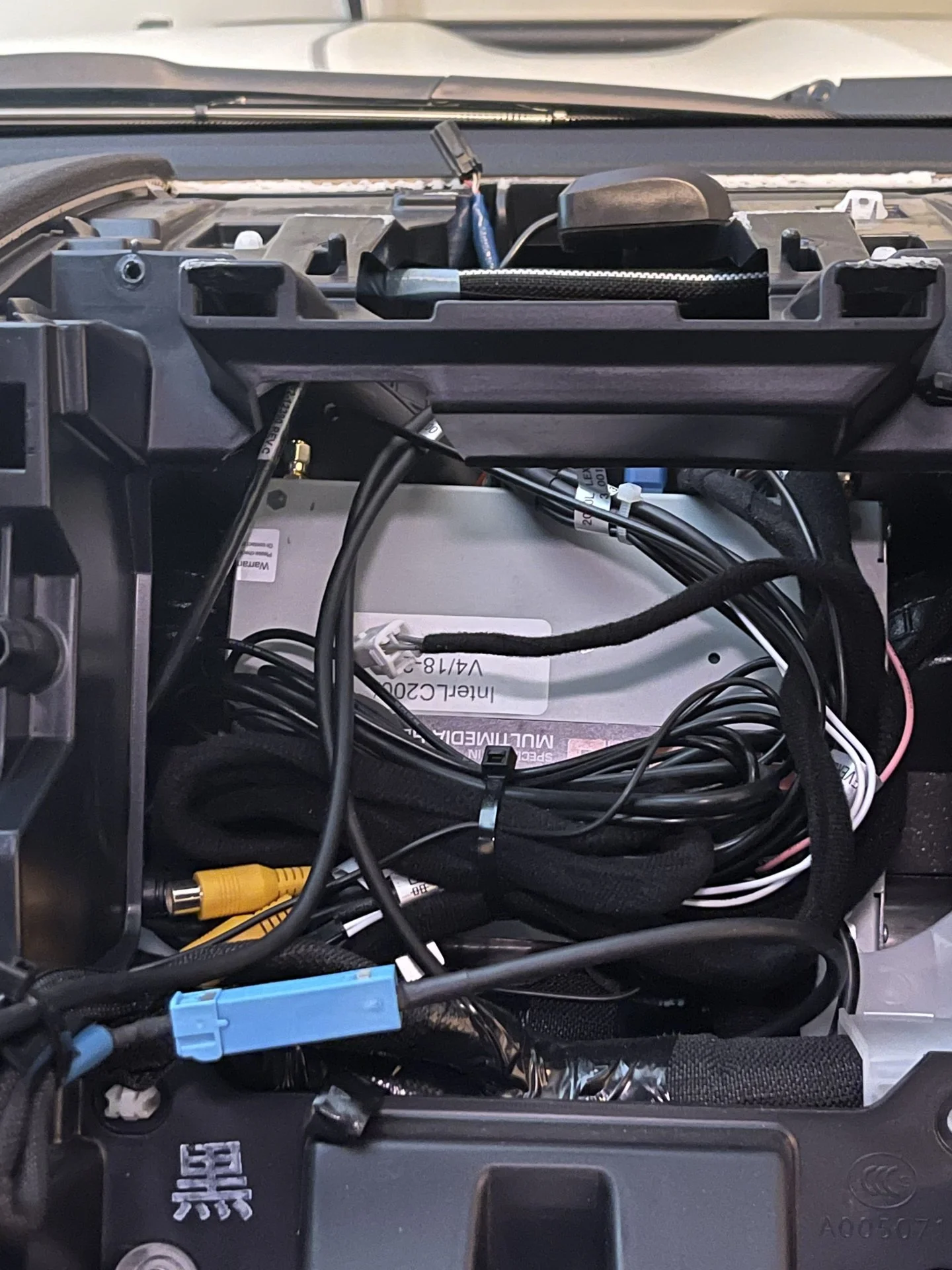

So my replacement LVD cable is arriving today so I went ahead and pulled the dash apart so I could replace it quickly and get to testing.

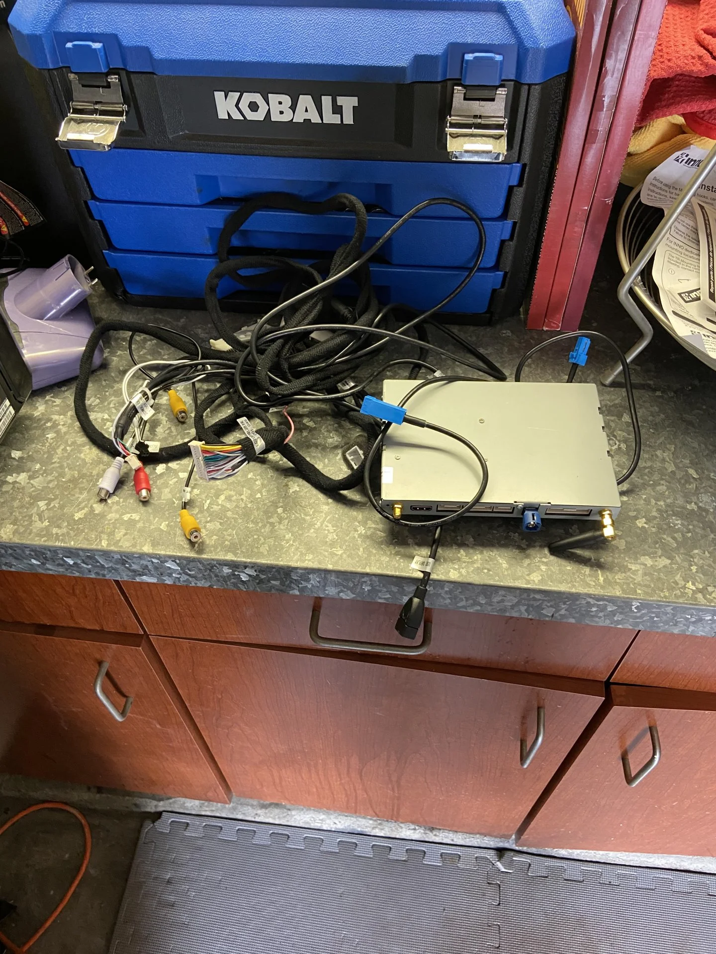

What is the preferred orientation of the ecoffroad unit when mounted behind the display? Mine is pictured below, the plugs are all facing up and they are having to maintain a fairly tight bend. Are you securing it in anyway or just letting it sit in there?
I'm not sure if there is a preferred orientation, but mine is not attached to my display, it's attached to the flat area that's in front of the display such that it remains in the vehicle if the display is removed. It has been quite a while since I installed mine and I didn't take pictures, but IIRC I have the plugs facing down. My vote is to go with whatever orientation puts the least stress on the cables. Tight bends are generally not a good thing especially for fiber cables such as the LVD used for the display.
I hear ya on the sharp bends. I guess I’ll play around with it and find the least ‘wire bendy’ way and go with that.

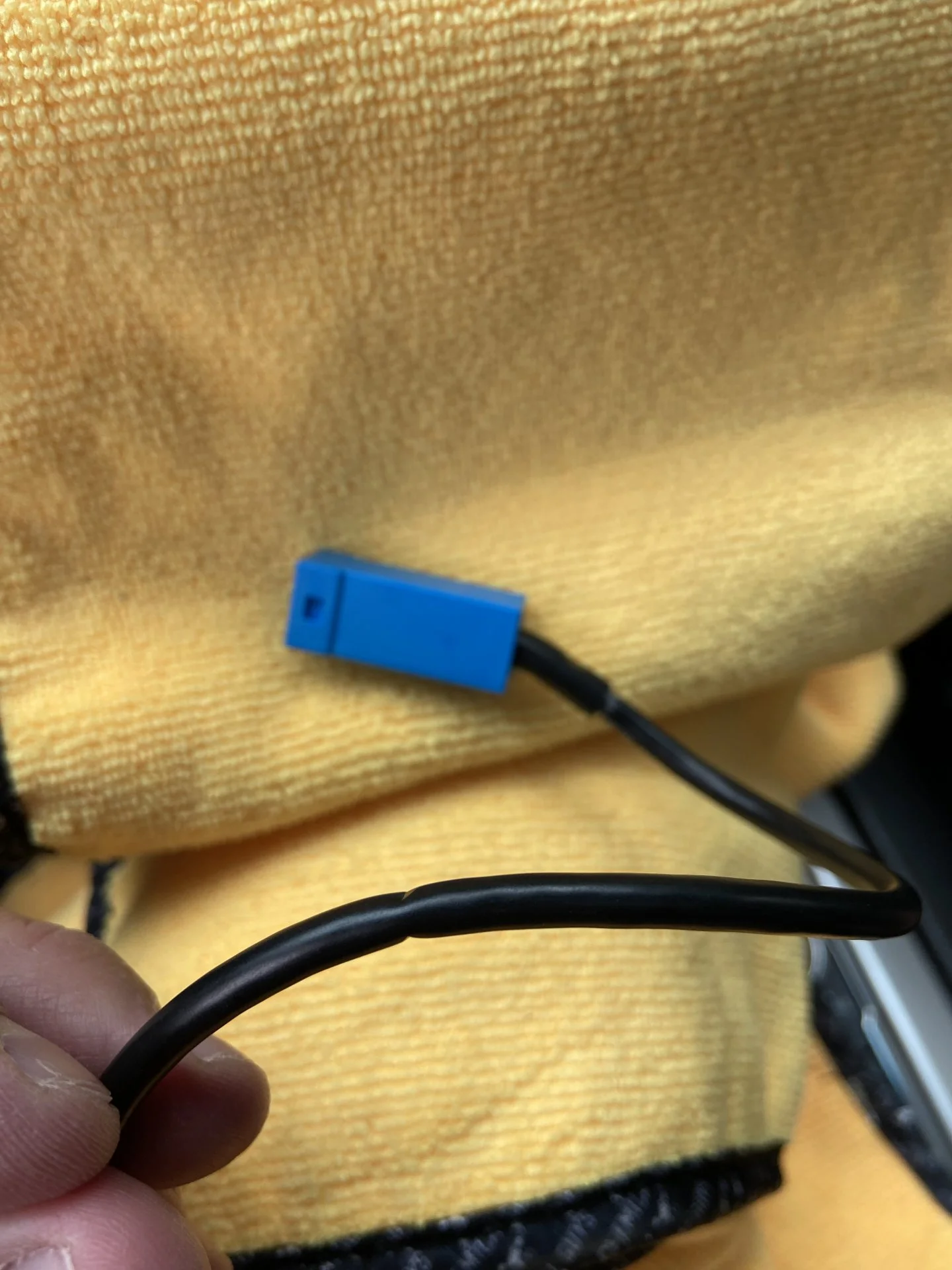

Update to replacing the LVD cable.
The process to remove the display was really easy as was replacing this cable. First start up I got the EC Off road splash screen the …. BLANK SCREEN 😵. I shut my he vehicle off and waited a few minutes then restarted…unit works as expected. Unit continued to work as expected for next 4 vehicle starts. I’m still concerned the problem still exists since it was intermittent before hand it makes sense that it would continue to act the same way.

This seems like an improvement. If the screen continues to intermittently blank out with this new cable, then I bet there's a bad solder joint at the connector for that cable. That would make it finicky depending on temperature, humidity, cable jostling, etc. and maybe you got lucky this time with how the cable is pushing against the connector in such a way to keep the solder joint contacting enough to work.

I sent in a video of the wiring setup to EC and they told me the LVD cable was kinked. Mind you, this was the new, pristine LVD cable they sent me for me install was kinked. Either way, it's out of the car. I'm just going to hang an iPad mini off the center speaker with a magnetic case and move on with life.

Issue solved with a new LVD cable. Here was the issue…just a pinch point was all it took.

As for the LVD cable I had blackouts/flickering on the OEM system and they sent me a replacement right away which solved my issue. They told me it was an optical cable so defintely want to be careful with bends etc on install. I re-positioned my box to reduce fatigue/kinks. Zero problems since.

How do you have yours mounted and situated behind your dash? You can see mine in post #302.
