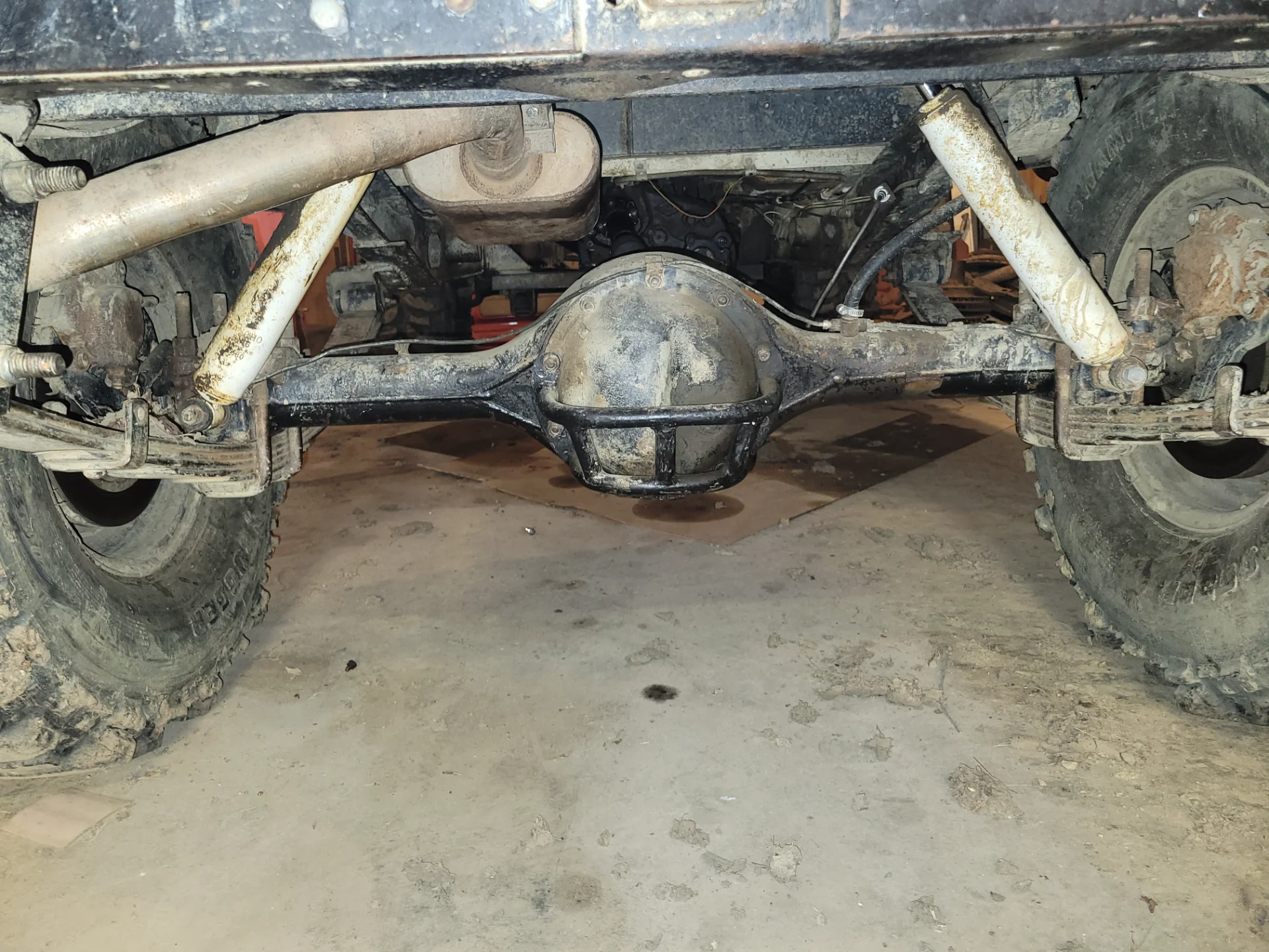

I run a sbc/sm420/dana 20 case with 2.46 low range, and I centered the 40's rearend. It has a Detroit Locker and 4.88's.

It's probably cheaper to center the 40's rear than buying Ford 9". Then you can spend the money you saved on a tcase adapter. It looks like Novak has a short one for a dana 300 and th400. The tcase can be altered for a true twin stick. One stick is for the rear axle and the other is for the front.
