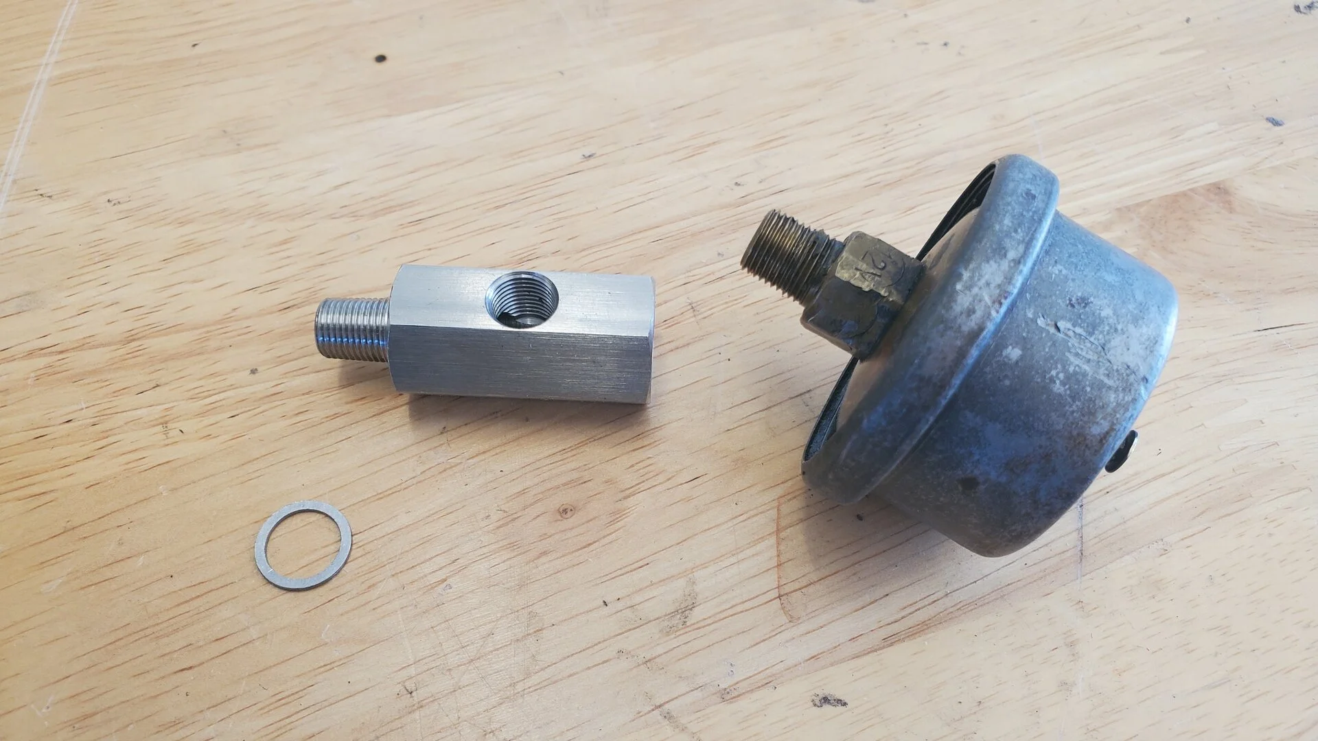

Just get a Tee from your local Ace Hardware store and screw it into the same place that the stock sender is at.
Not so fast. I believe that the threads are BSP ( British Standard Pipe). McMaster-Carr sells a BSP Tee then you can buy an adapter to screw on a NPT fitting. I have all the part numbers if you need them.
That's the same adapter that I bought a few months ago, it works perfectly.

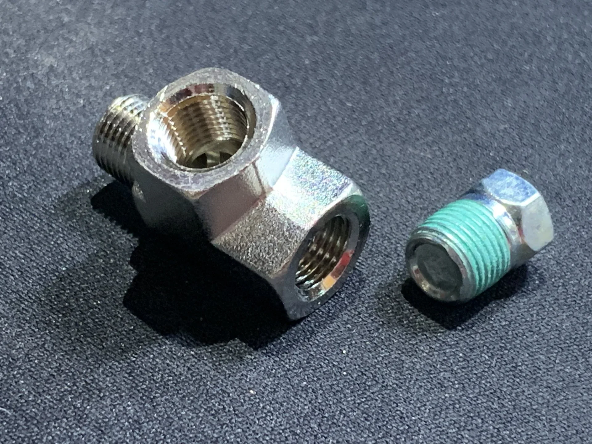

you can force-feed whatever from where-ever , home depot or auto zone , then soon regret this and all that when it leaks , and fails in the short term , or strips out your oil cooler or stand alone filter mount / F1.5 drivers side lower engine block cast iron too .....!
or
you can set your self up for success here with the correct custom made to ALL
JIS pipe taper threads specs , solid brass , that's then nickle plated to my strict as hell BLING-status standards too ....
- the included OEM TOYOTA little service / delete plug w/ factory green pre-coated GOOD STUFF on it , is geared towards the folks that desire a as needed service port to install a manual stand alone oil pressure gauge to verify a cluster meter gauge read out issue or diagnose a bad oil pressure mechanical sending unit too ....
- i installed one on GHOST when i replaced my leaky oem factory mechanical sending unit , i WILL be adding a OEM YAZAKI 52mm gauge under the hood for to the metric parsec second info when i need it when want it .......
- THIS IS THE WAY .....
