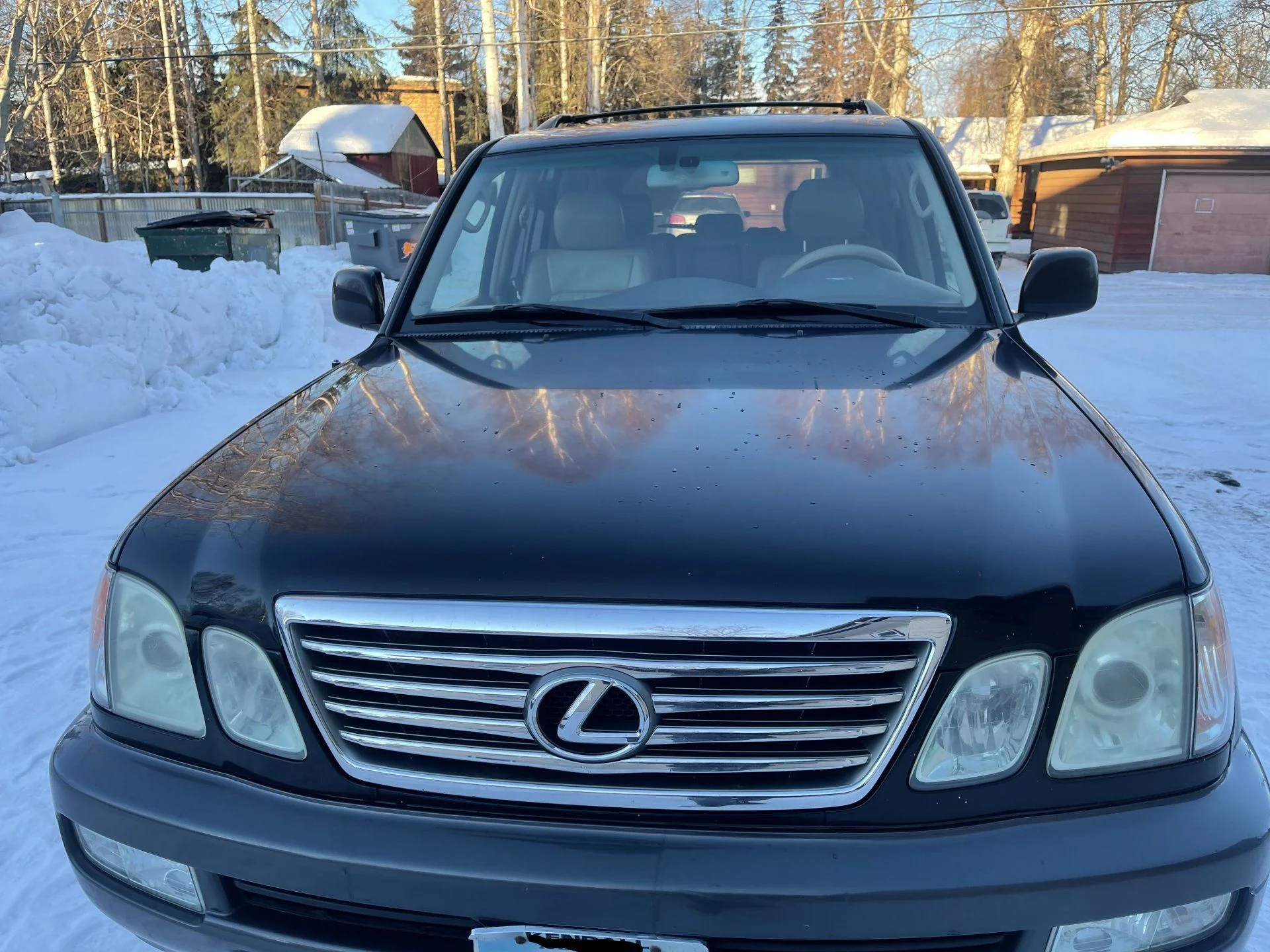

Hello everyone. The cruiser I bought few months ago had foggy headlights. So I decided to use a compound polish that I already had before wasting money on expensive headlight restoration kits and the result turned out to be amazing. It doesn't require any polisher or sander. Just 5 minutes of elbow grease. Here is the before and after pictures of the headlights and the compound that I used. Hope this helps everyone.

Looks awesome! Don't forget to seal and protect or they'll haze again soon. I just did mine this weekend too.
How do you suggest sealing and protecting? Need the longest lasting protection. Meguiars kits last a year it says on the box. I’m guessing the suns UV destroys protection(?)
Would like to know too, my lx and 4Runner headlights are baaaad.
My issue is moisture building up inside the headlamp, this seems to be a harder issue to fix
I've re-re-re-restored my headlights several times - tried a couple sealants. Clear coat is apparently the only thing that lasts. So, polish then paint...
