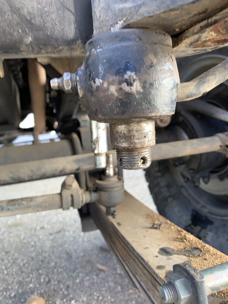

I went out with my early center arm rebuild kit that I got from @cruiseroutfit and ran into a couple of issues.
Firstly, I failed to notice the mangled threads on the top of the center shaft and promptly stripped out my M16 castle nut. For this, I just need to find another nut and re-cut the threads.

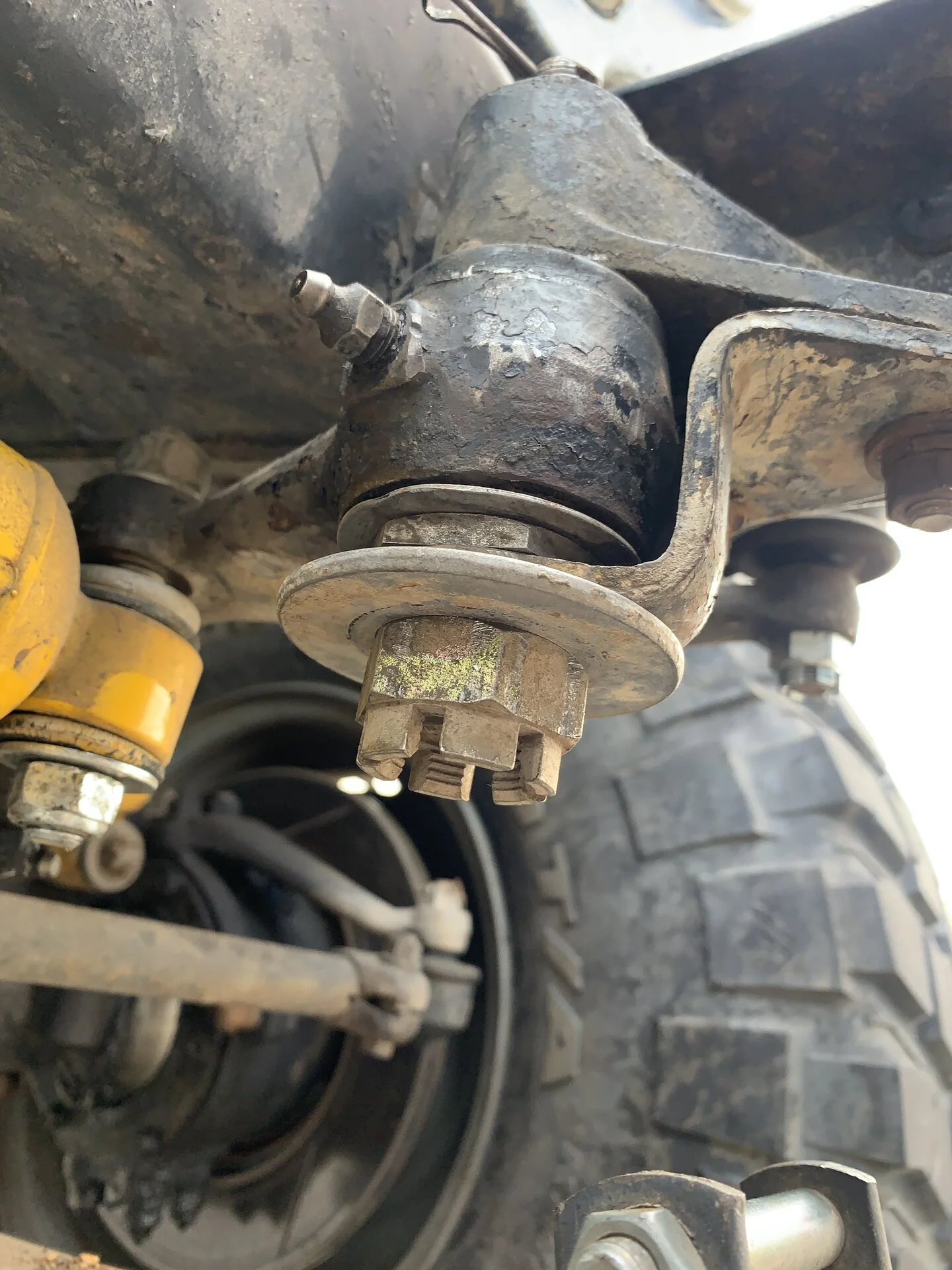

Next, I noticed the nut on the bottom of the center arm shaft was loose, didn't have a cotter pin and was 4-5 threads from being able to even get a cotter pin in place:

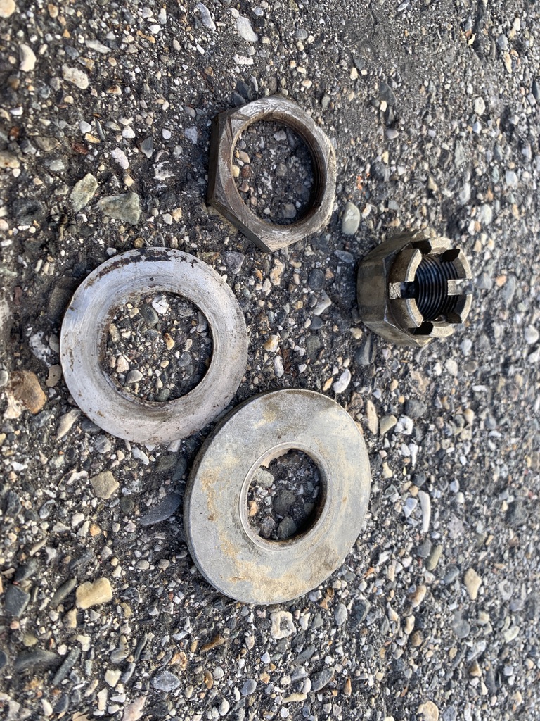

Removing the nut, I have four parts that I don't see on the FSM diagram:
The bigger nut has threads but does not thread onto anything.
Were these washers and oversized nut added as spacers?

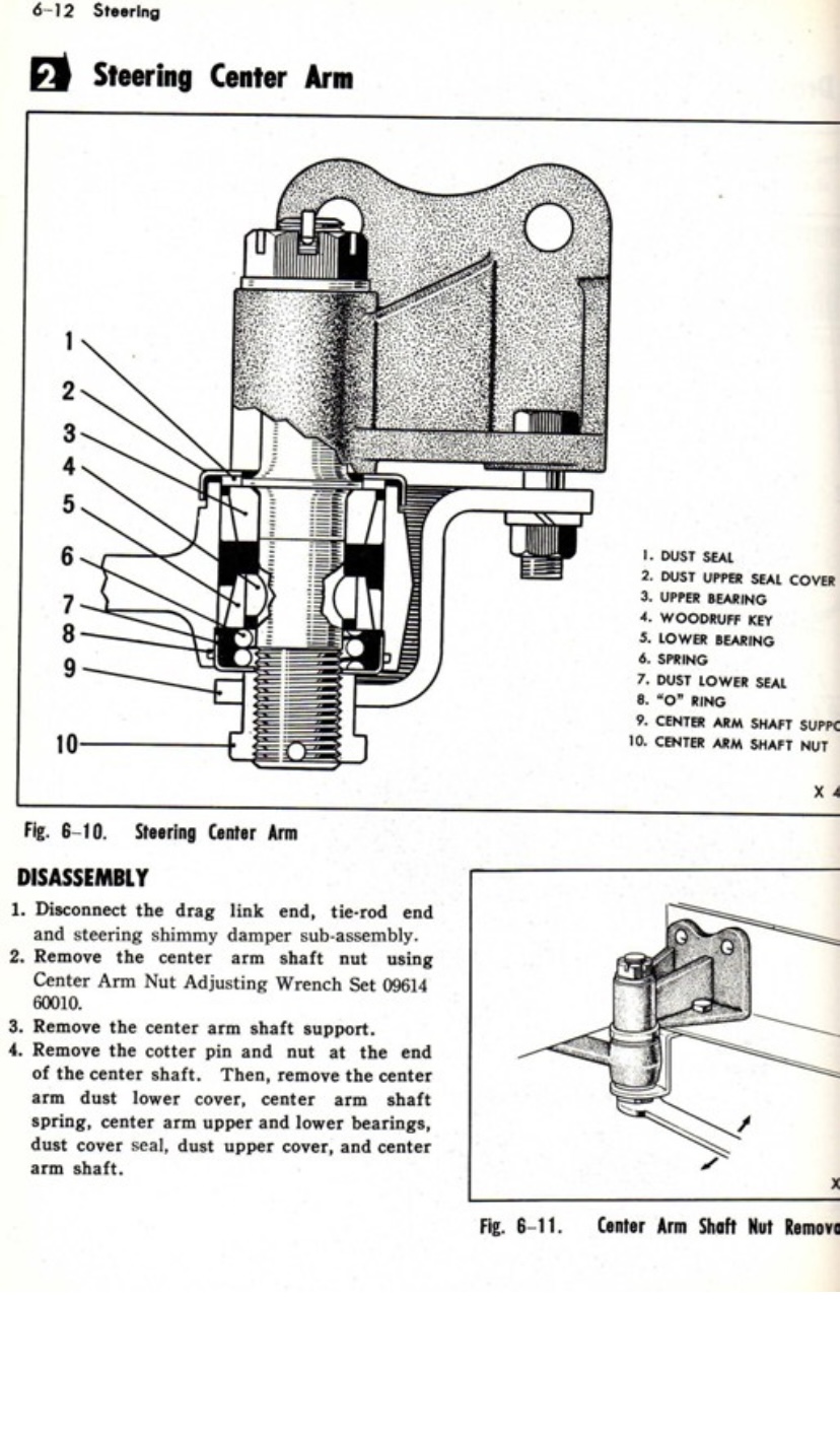

FSM diagram:
Is my center arm shaft nut (#10 in the diagram) broken and seized onto the shaft?
Considering that there is no sleeve that is supposed to be on that part of the shaft, it does appear that someone cut the head off of the original #10 castle nut. That's pretty f-ed up.
You are going to have to get that sleeve off. If I had to face that situation I think that I would try and cu a vertical notch across as much of it as I could with a dremel, then try and crack it with a cold chisel.

The more I look at it, I think you’re right. Either the head of #10 was cut off or broke off being reassembled incorrectly. I’m thinking I just repair the top threads, throw on a new castle nut up top and live with a couple degrees of slop. I’ve driven it this way for 11 years now so….:oops:
