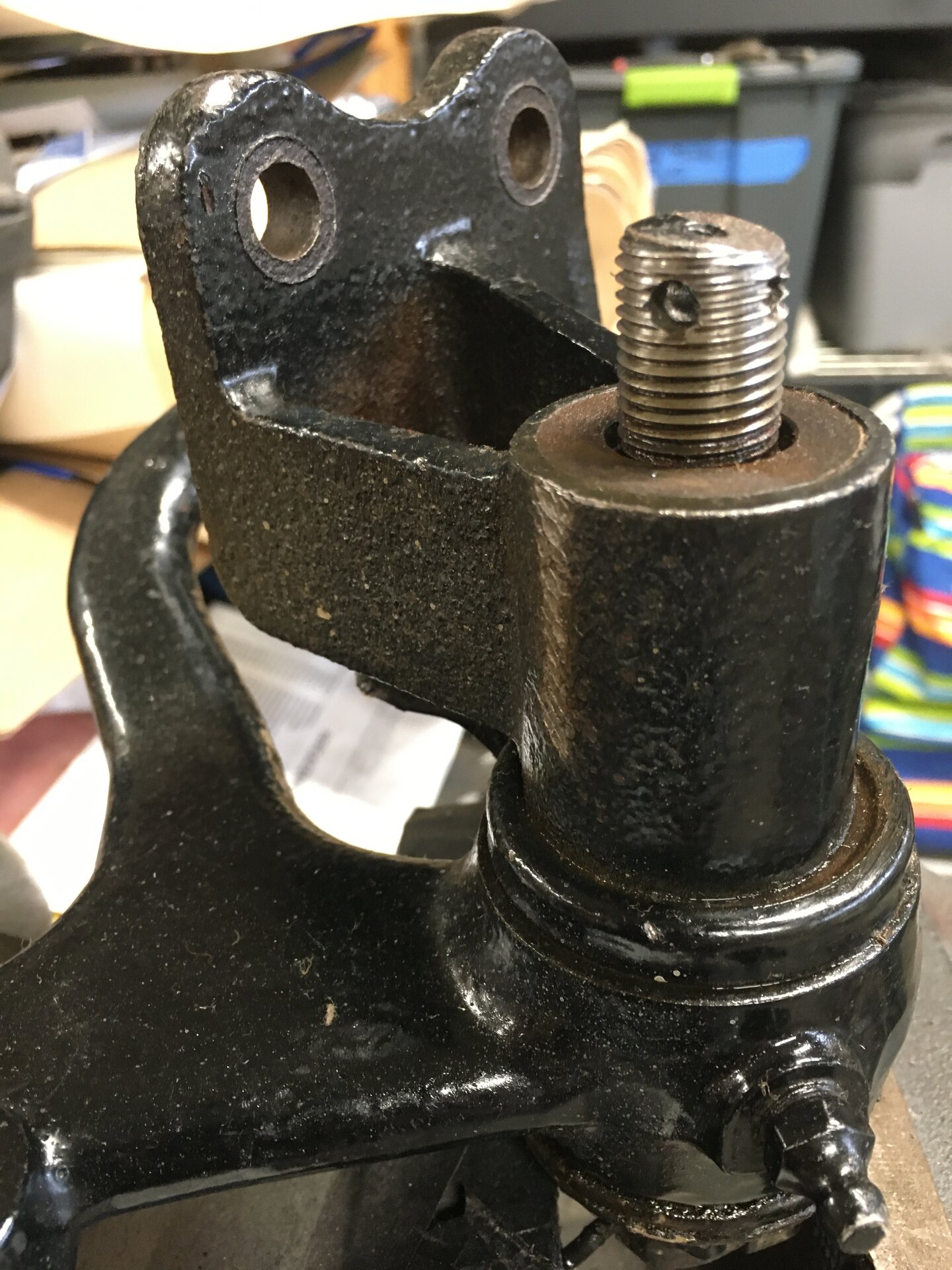

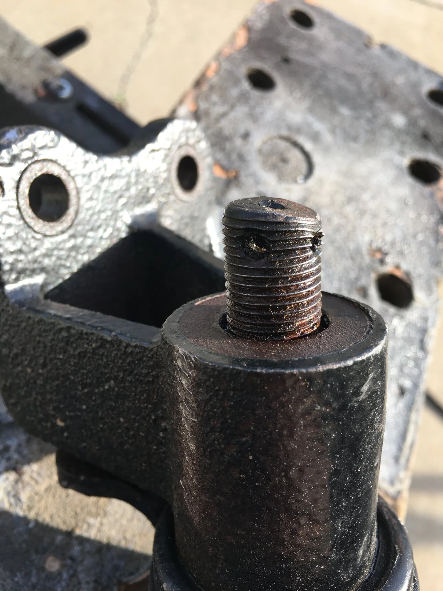

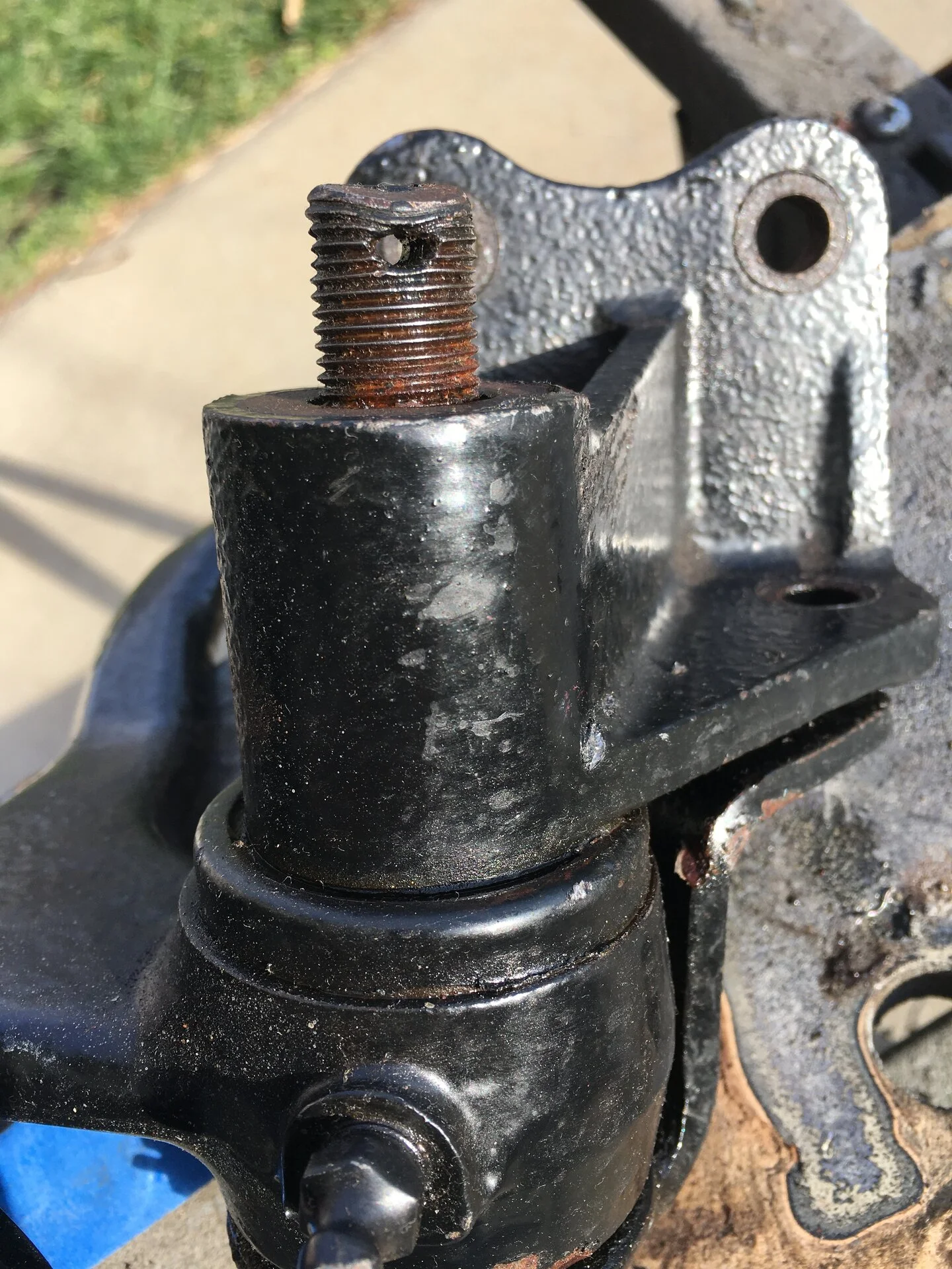

Early center arm assembly that appears to have lost a battle with a BFH. Was a little rusty when I picked it up and definitely seems worse after some cleanup.
Anybody have any tips or tricks that may be able to salvage these threads?
Anybody have a replacement castle nut and spacer they are willing to part with? SOR has it listed for $40 before shipping, can't stomach that idea yet. How about details regarding thread pitch and nut sizing?

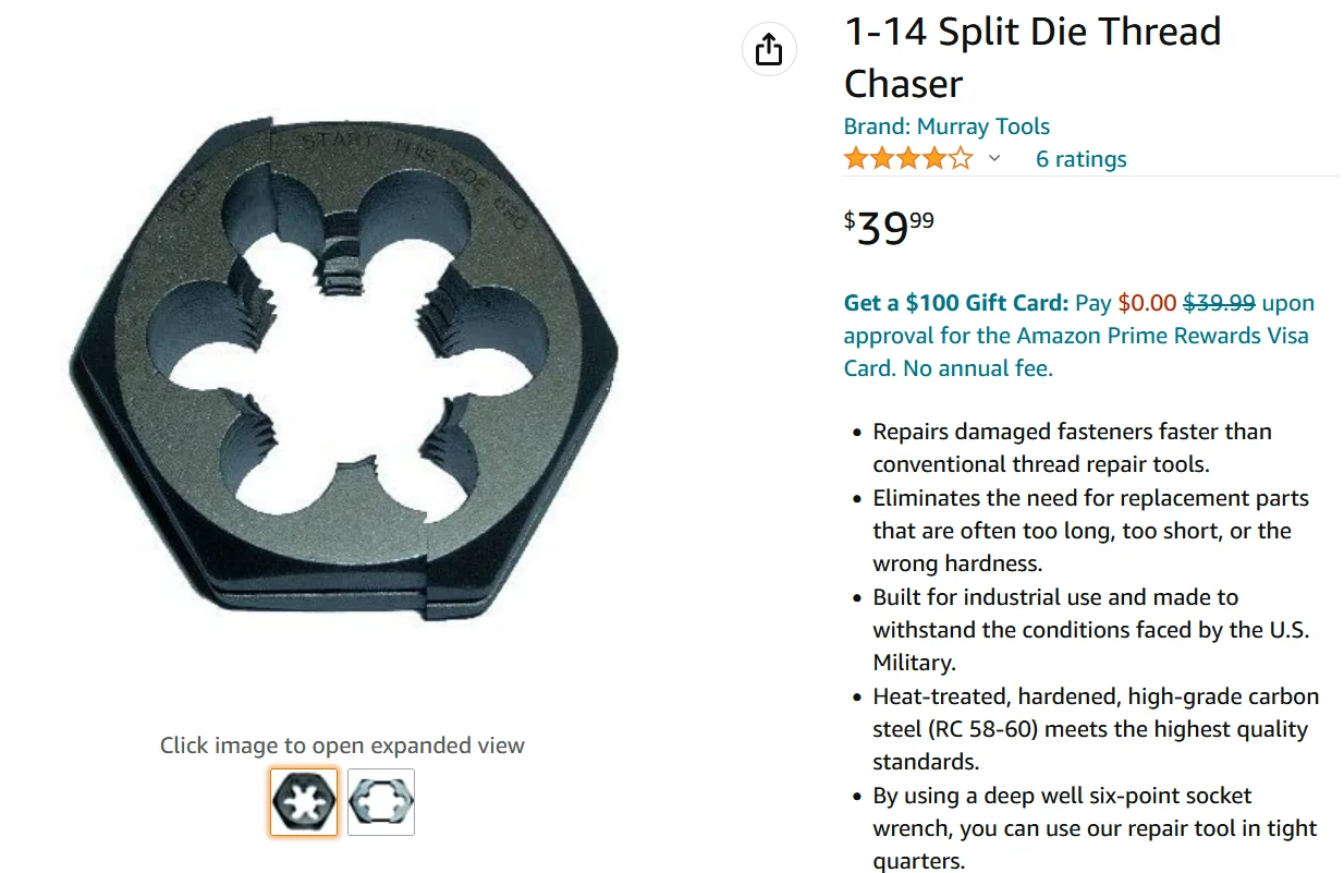

Drill the pin hole out and use one of these split dies: (of course, you need the correct size, natch)
That'll get the threads straight again. You don't need the first two for holding anything anyway. Or you shouldn't; good rule of thumb is to leave at least two threads exposed so that you can visually inspect the torque.

Unlike a standard die, instead of orienting the "start side" down like for cutting new threads, you want to assemble the die below the damaged area with the "start side" up. With the die mated to the good threads you would back it off the stud which would either reform or cut threads that will line up with undamaged portion of the center shaft. The biggest problem I can see is actually finding a die with the correct threads. The cost is also pretty high for a one time use tool. You may actually be better off buying new/replacement parts.

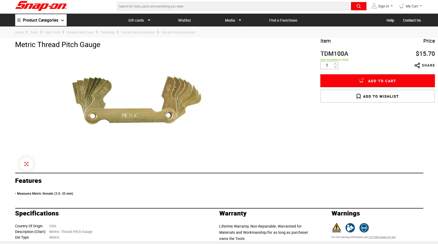

A thread pitch gauge is invaluable:
It doesn't have to be this one; they all work the same. You may be able to pick one up at the hardware store.

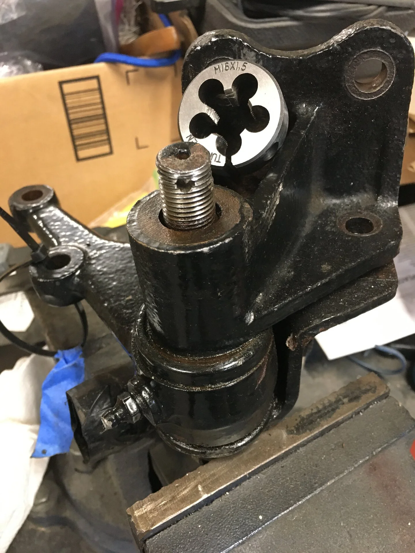

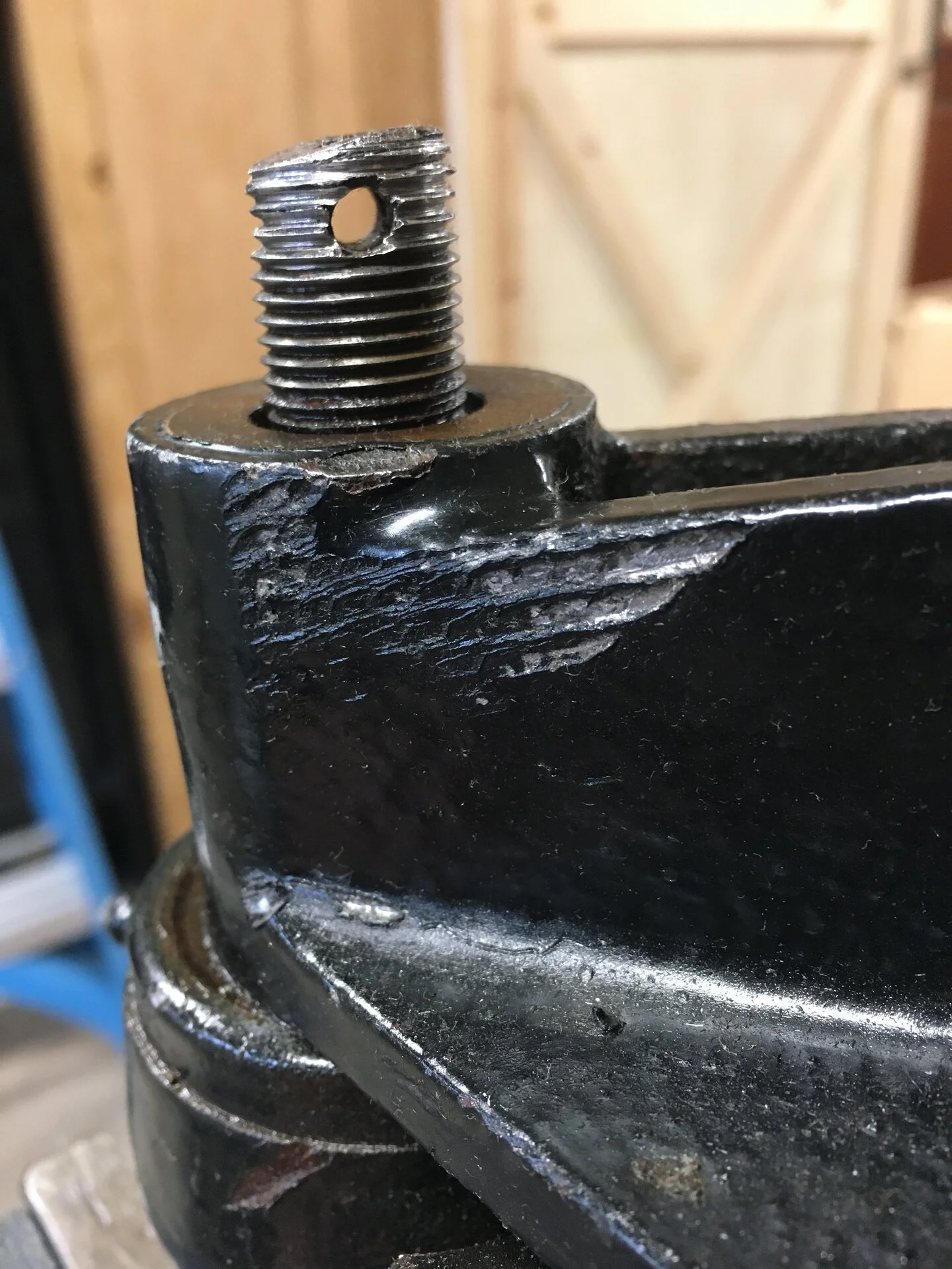

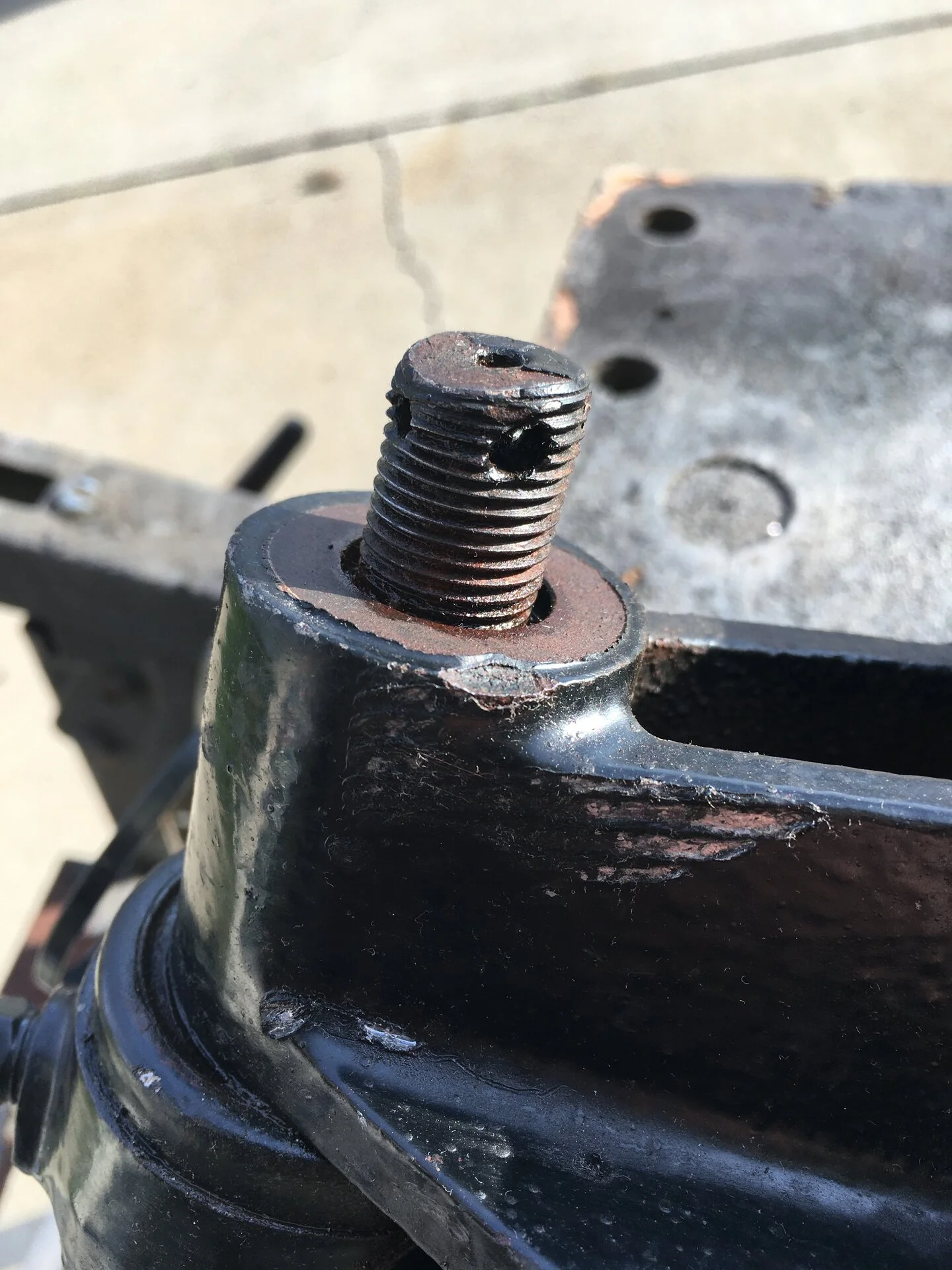

Thanks to all who have contributed here, I do now have some new tools on order. Here are some progress pics. With some help from Malleus and some dial calipers, calculated that outer thread diameter @ 16mm. Thread pitch was either 1.25mm or 1.5mm. Some internet research help me to identify that 1.25 is almost impossible to source tools for and had limited parts supply. This combined with me already having a 16x1.5 die narrowed next steps to going for it. I was hesitant to use any power tools on the "thread grinding" ideas from above, so just did some hand filing to knock the high spots with the smashed threads area. There was enough of the "good" threads available to help guide the die correctly. Once I can get the correct nut, will use this as a guide to level out the top of the pin a little. Still playing squirrel and looking for that nut (and spacer) but have a few options in progress and will update again with final resolution.
So.... pre-'69 center arm top threads are M16x1.5
