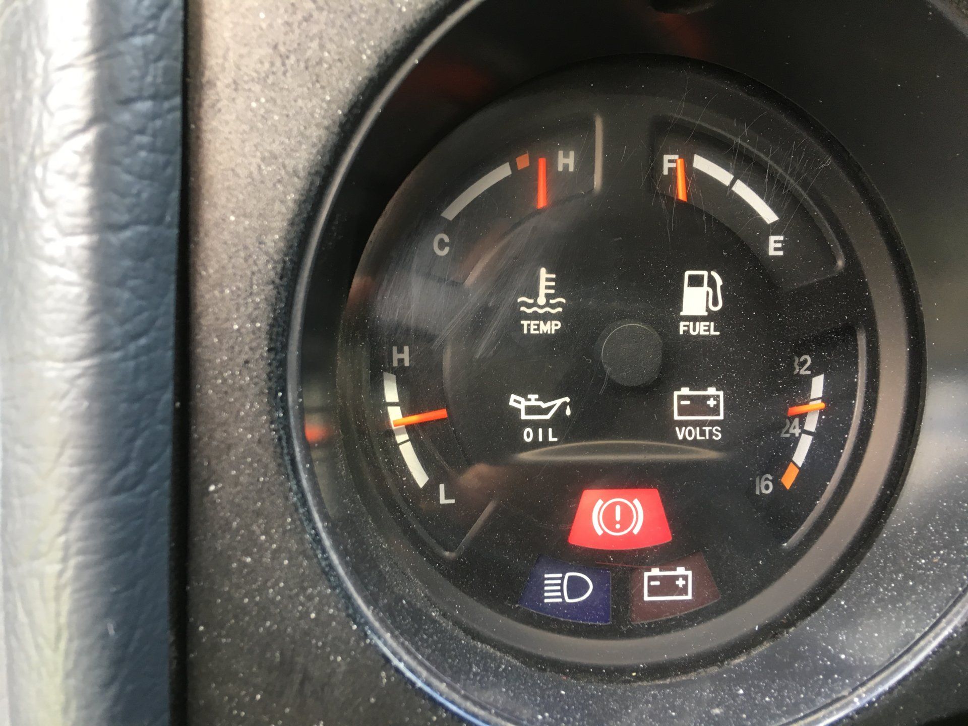

My dominating wench... I mean, truck gave me the double finger today and I came near to an MI while getting to the side of the hw at the same time.
Scenerio... 65mph, raining, wipers on, lights, CD player, heat on med... Noted alt gauge fluttering from 12-10-12. When the peg of the water temp and fuel occurred and I pulled over I shut the music off and lights. Dual fingers dropped simultaneously. I got back on the road and drove annoyingly defensively. At this point 65mph, no lights, no music, the volt gauge is now where it belongs between 12-14. Peg occurs again at least twice, up and down together.

If both gauges spike suddenly, ignore it. Well don't actually ignore it, kinda keep an eye on it, but it's just an electrical malfunction with the fuel gauge, not an imminent engine fire. I know that's easier said than done. But it's a good exercise in faith management (if there's such a thing).
I've watched my old gauges spike to the hilt many a time. Pegged there for several lip biting minutes as I continued charging on at 75 mph- then they would both calm down & return to normal. I never liked seeing that, but when they both spike, you're ok

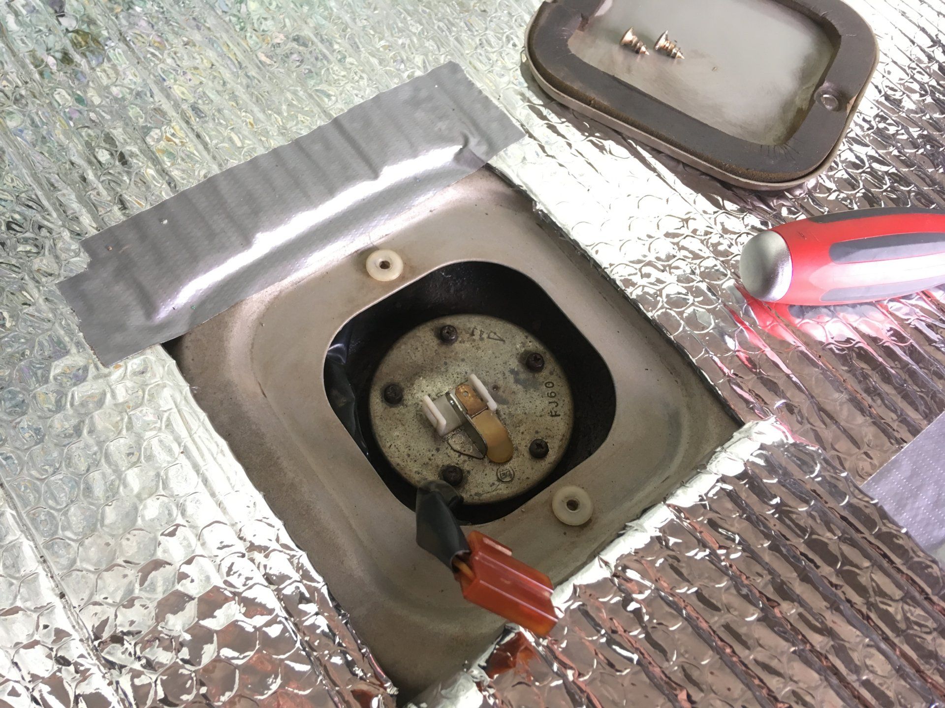

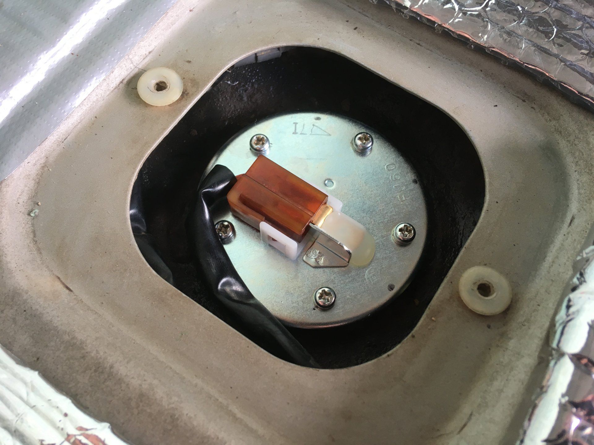

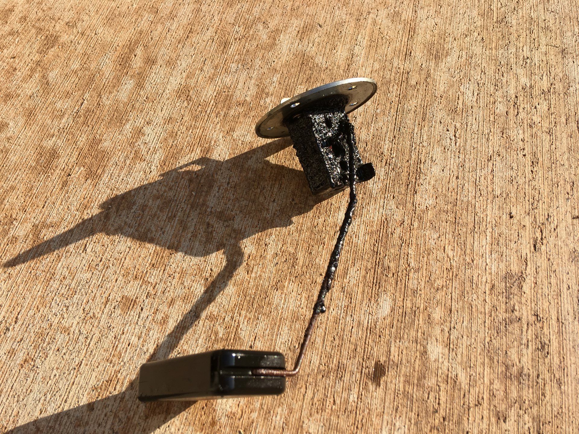

Yes, I went against the advice of nearly everyone on here about cleaning up the contacts behind the dash to fix my temp and fuel spikes.
I was a bit nervous to take the dash off and break something else! When Mr AlohaJen took out the fuel level gauge in the back, it was obvious it was part of the problem.

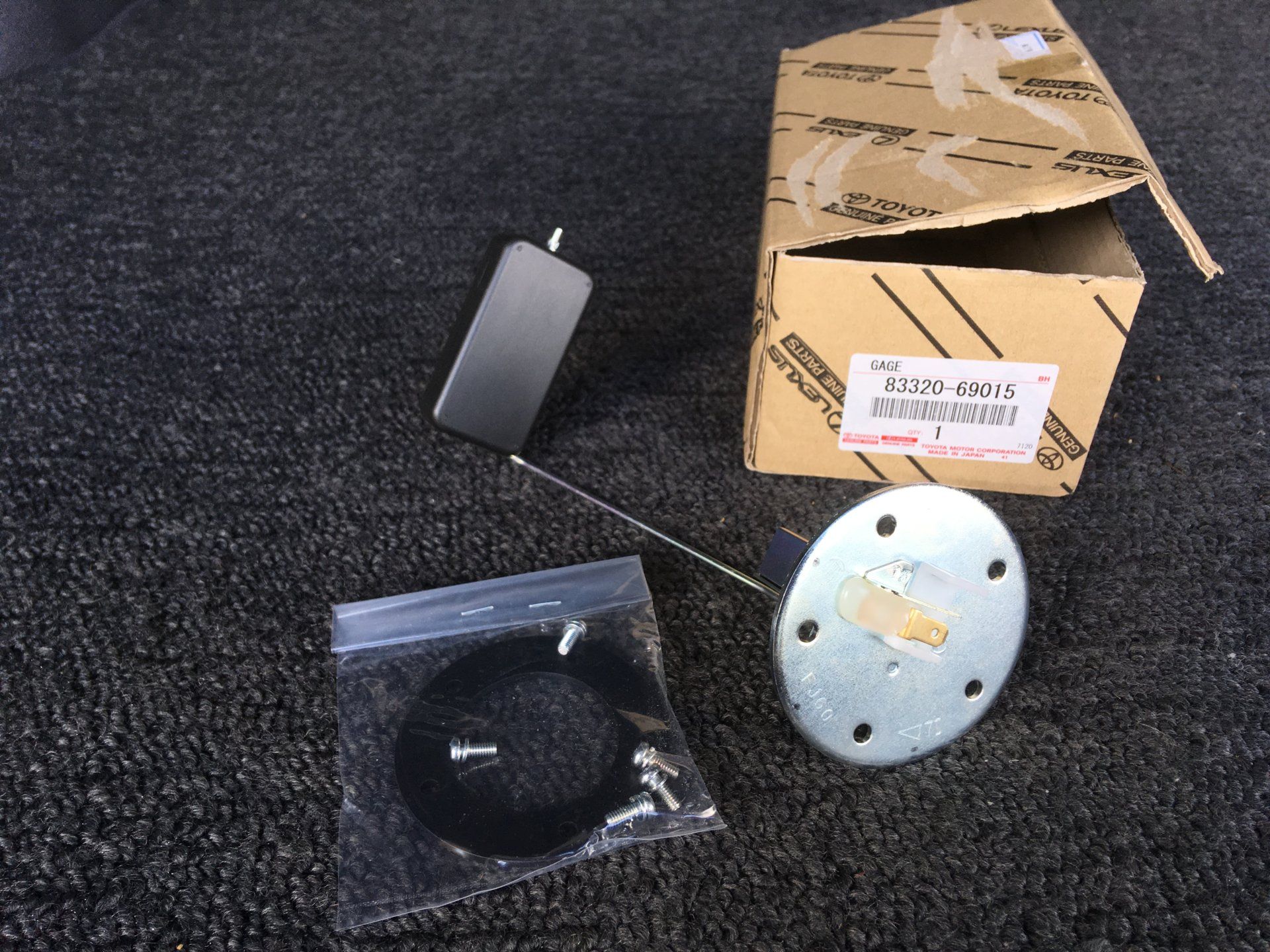

A brand new shiney one from Toyota was only $85 bucks, so it seemed worthwhile to swap it out. Got mine here: Toyota 83320-69015 (8332069015) SENSOR, FUEL LEVEL - Amayama
But the Toyota dealer or most any Mud vendor can get it as well. I had other stuff coming from amayana, so just got it from them.
It’s a five minute job total. Just locate the hatch in the back and remove the old one
Clean up the electrical contacts, change provided gasket, drop the new one in and screw it down
It went from constant gauge spikes Before, to never happening again since. Its been about 8 months and maybe a thousand miles and still no spikes. So my dash will stay in place until I see it happen again.

Welp I just put in an order for that fuel pickup. Seems like the more logical step than a band aide of a new used cluster. If the pegs start up again @Dynosoar I’ll reach back out if that’s cool. And @Jaric00n I’ll keep you in mind as well. Thanks all.
I checked the part number Jen gave on TPD w/ my trucks info and it said it matched. I then ordered the fuel pickup from the Amayama site.
