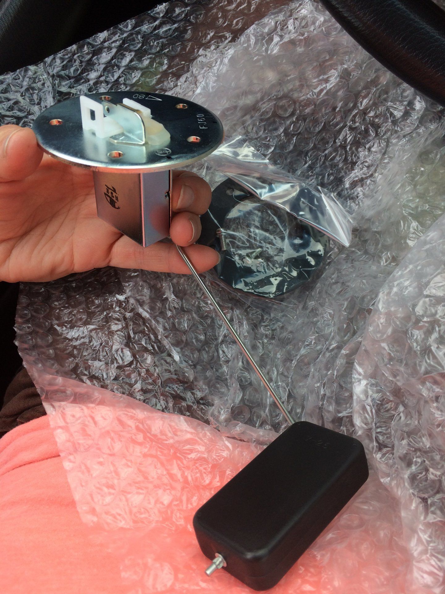

My first official parts package from Japan. Purty!

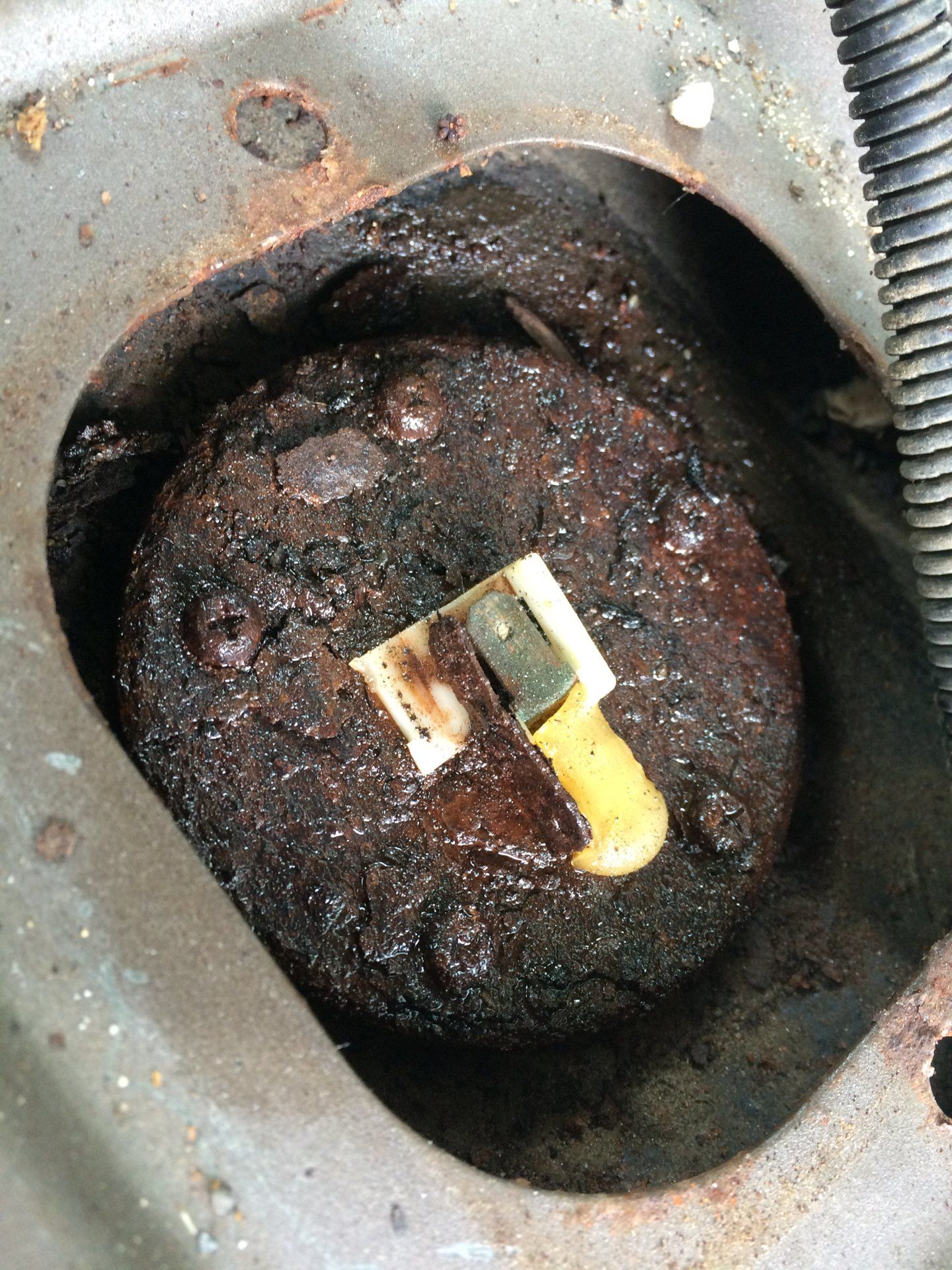

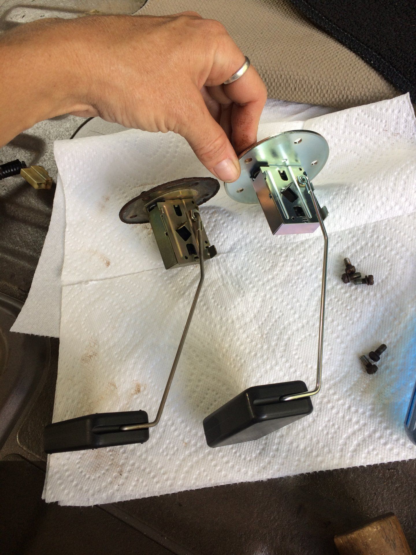

In and out. Had to chisel the screws out. Old sender honestly was in darn good shape other than the top being wicked rusted. Will see how the gauge reacts while driving.

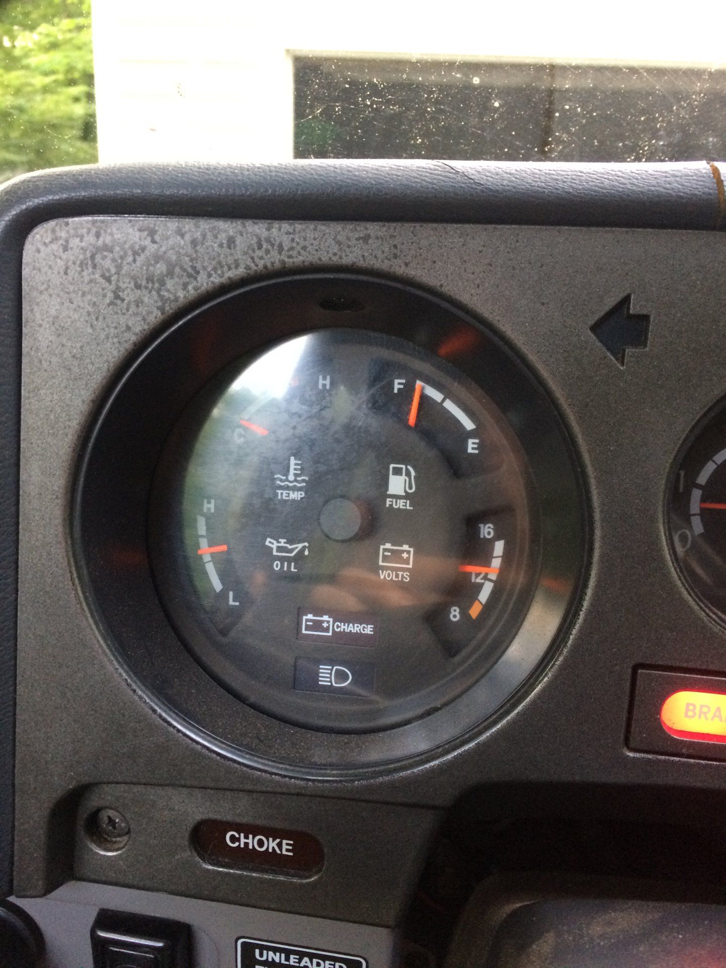

Fuel gauge now working. Took the truck for a ride on the hw twice and back roads and no peg. :)
Thanks @Aloha Jen.
That’s great!!! Hope it fixes it for good, relatively inexpensive and easy fixes are the best!
