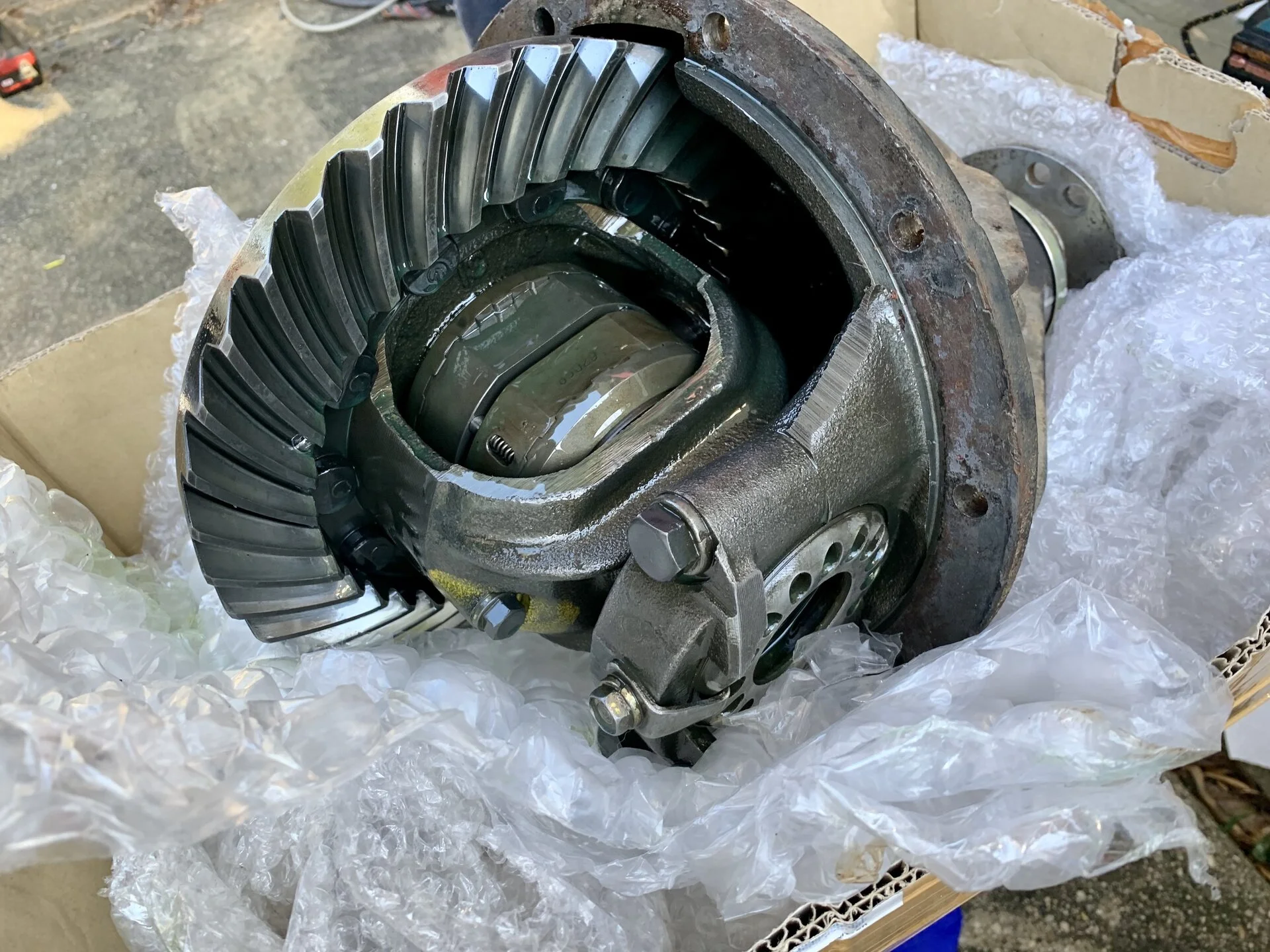

what happened to it?
shear the pin ?
shear the pin ?
i get anxious when i close my eyes and Loud BANG accompanied by THOR and ODEN 's sledge hammers hitting my rear bumper 's Fame Rivets at the same exact instant , would cause my precious GHOST to LURCH forward at a 15-20" angle one way or the other ...
this got rapidly worse , until driving approx. 35-40mph down a VERY straight road , there was a very very big BANG , at both REAR tires locked up dead nuts SOLID .
i came the closest thing to loosing total control a vehicle during normal steady driving in my entire life , i am absolutely sure it could of ROLLED with me not at all really holding the steering wheel with 2 hands let alone one normally , when the exact moment in time occurred ,
i was able to gain some limited control back again as i ground to a mild side ways skidding dead nuts stop , as fast and hard as it all only seconds earlier without any warning signs my " GHETTO LUNCH BOX Product " had a catastrophic mechanical event failure in a instant ...
- i had GHOST Towed Home via a roll back back to the SKUNK-WORKS Laboratory , because BOTH rear tires remained LOCKED-UP , i did not try to actually drive her again , rather me and 2 TECH's from the UNITED RENTALS store place whom i had more or less skidded into there shop drive entrance way , all 3 at once tried to hand push / roll GHOST with the MTM in neutral , and the E-Brake released fully , NOTTA.....
i had no towing coverage or JACK because , my Insurance had NOT yet transitioned from the VERBAL you call it in after u are handed the TITLE signed by the Previous Owner keys in hand moment liability ONLY coverage , because that's the way it is........... needed 1st adventure drive journey straight the F#CK home ..
- i might be a spoiled T-TEN educated OCD purist hard core fundamentals approach by the FSM BRATT , but who in there right mind out there would not stop at there LOCAL NAPA and SCOOP up there pre-planed and well self-brought up to speed on the 2nd best possible ENGINE OIL available on the market today , next to AMSOIL , ROYAL PURPLE Full Synthetic 20W50 8QTS and already have there OEM DENSO Blue Box Full size canister OIL Filter in hand , so the key turns OFF after you take the LONG WAY across town on your way ho home because your GIDDY as all get out , and its setting in SOLID that this is REAL and this is actually mine now mind set , i don't dare ignite that 3FE again until the UN-KNOWN in the Windage Trays is drained out , because it was basically summer time out , and the PO proudly showed me his mini-horde of both 5w30 conventical and 10w30 conventual 5qt jugs ..SHELL ROTILLA DIESEL Engine OIL ..........:oops:
- my full-on Sermon-TECH regarding the Engine Oil topic , was documented in a 5 part mini-me You Tube T-TEN Technical Channel , a Series of REEL's Shorts , that dive DEEP into your OEM factory Viscosity Charts in your Glove Box owners manual .....

- this product SUCKS because the simple fundamental of a metallurgy Stress contact release pressure point on and off and on and off over a period of time is simple SHOCK AND AWE to your entire Powertrain and Chassis system fundamental parts at there CORE level
- over the Course of the nuts and bolts force-fed job repair i embarked on and did my best to document from a T-TEN Scientific study observe and verify approach , because i truly wanted to learn a needed new SKILL-SET here at the roots , i confirmed and verified 1 of my possible theory's that the constant BANGING SHOCK was completely un-naturale and also , had plagued the PO in the longer-term past , as i encountered a host of REAR drive-train repairs , and NON-TOYOTA replacement parts some of which i have never encountered before ?
- i never to date have googled online to find similar events by other " THIS SUCK - Product " vehicle owner operators ?
- i pondered it for a moment during on-set evaluation procedures jack GHOST up on jack stands safely , confirm the entire power train was 100% immobilized and take her KICKS off for a more then moderate lookie lookie see see .....
- i am done posting my concrete facts above and my story how it was written for me by the TEq Cards i was dealt by the dirty little dealer called LUNCH-BOX ....
- thanks for letting me share , it helps :grinpimp:

can anyone examine my TECH. photos and pinpoint exactly what brand L-BOX was installed ?
- i found out early on my roller ride off near DOOM ,, that LUNCH BOX is a loosely worded term at times , that some folks and places online use to refer to this crude form of meshing mechanical metallurgy into Meyhem ...
