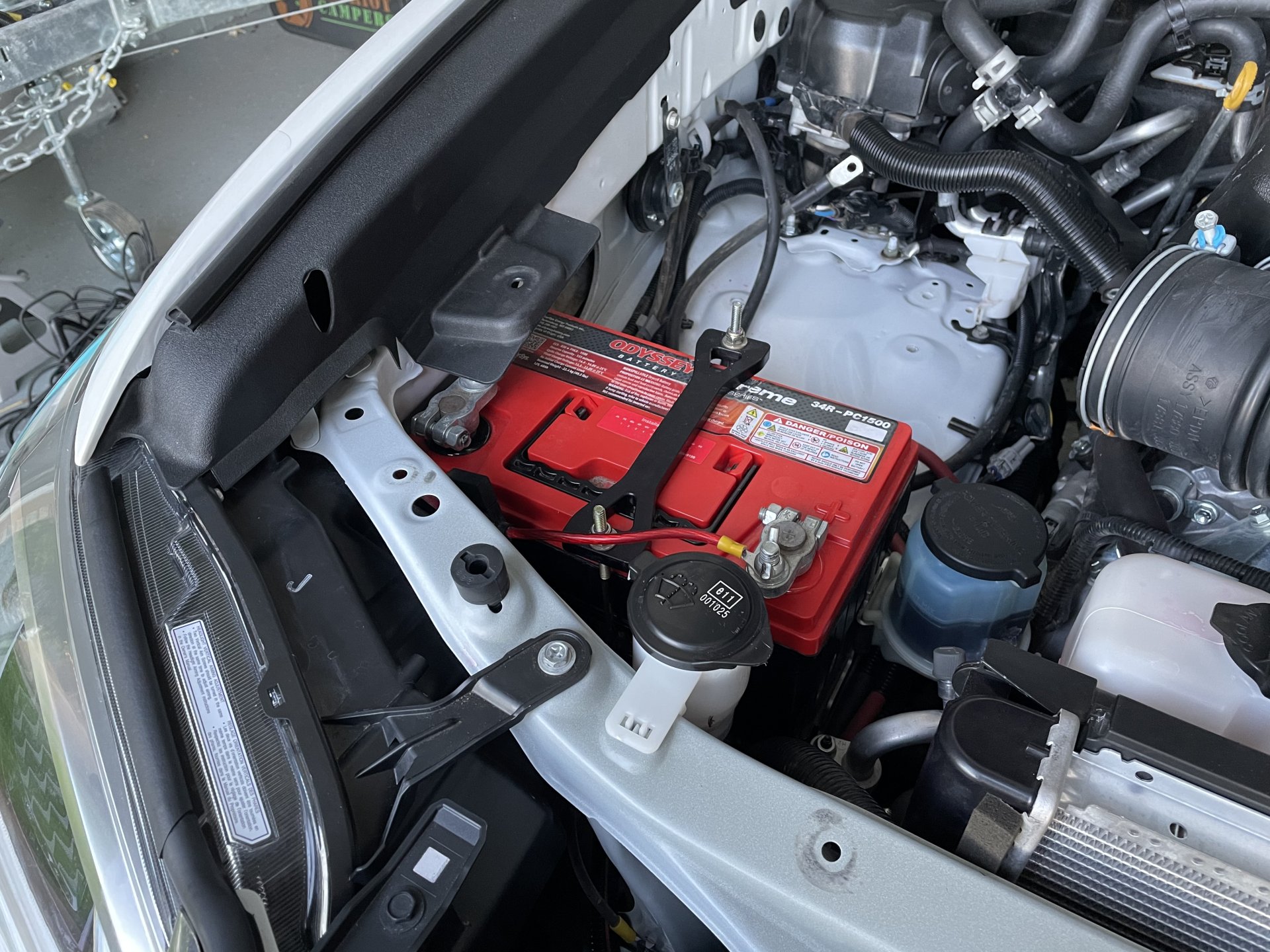

If you go to my build thread: Builds - R2M 2013 Lexus GX460 Overland Build - https://forum.ih8mud.com/threads/r2m-2013-lexus-gx460-overland-build.1104719/
Start at post #3, I have two Odyssey batteries next to each other in the stock location.
YotaMasters made the mount for them.
There should be no problem fitting two batteries in the stock location and using a battery isolator and you should be good to go!

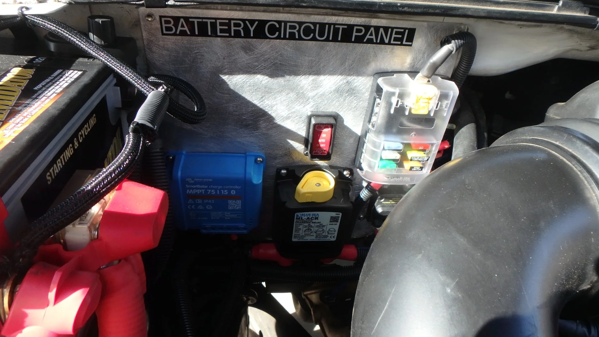

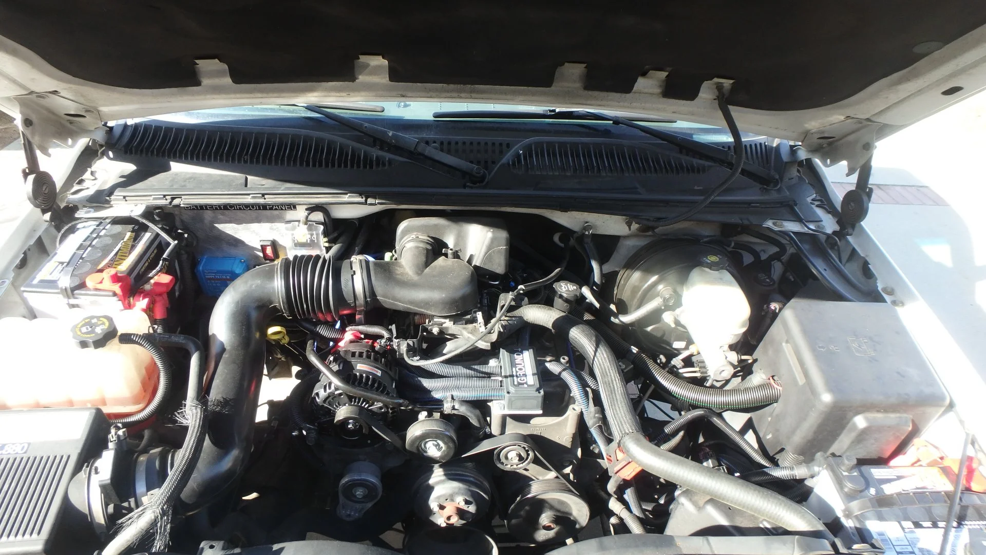

Not a GX but here is my setup for reference:
Just be prepared for some fabrication and most importantly fuse for the wire and not the circuit.

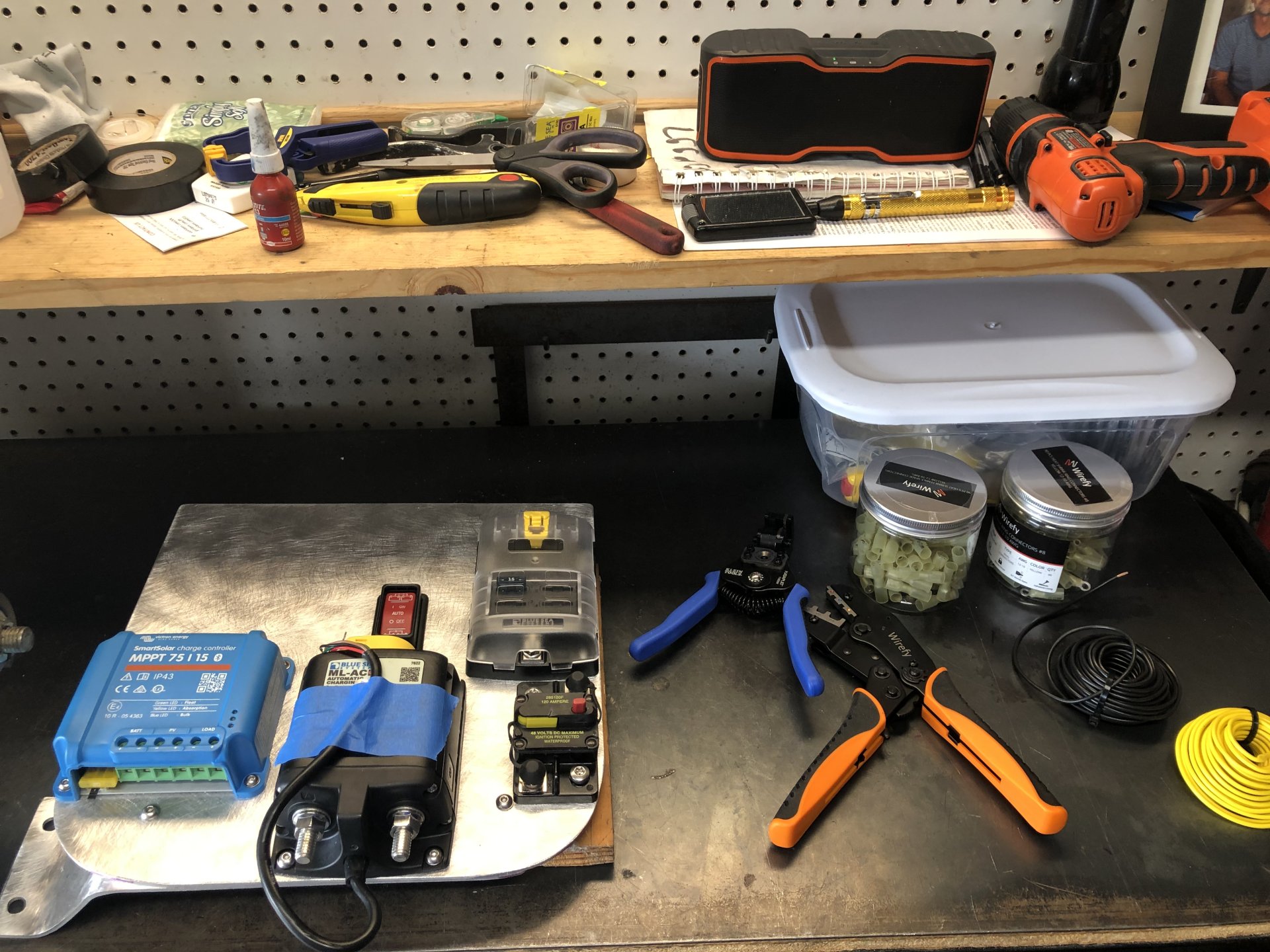

I used the shrockworks fj cruiser tray on the passenger side and oge generic tray with the blue sea systems isolator switch on the drivers side. I connected everything up using cables off Amazon. Everything bolts in and no custom fabrication was needed. I put the air pump behind the air box next to that rats nest of heater hoses.
What size wires are you using? What style connectors? Almost looks like 8 AWG positive and 4 AWG negative? Pretty clean setup though. What are you running off your secondary battery? Where are your fuses and wire loom?
I used 1/0 AWG throughout for everything connecting to ground and charging system. Miss matching wires can open up a whole bunch of electrical issues. I also recommend to not use chassis for grounding secondary battery. Both batteries and alternator need to have a common ground to charge properly.
I got rid of factory grounding system and replaced it by using a busbar and 1/0 AWG through my system. I also stuffed it through my RVC (regulated voltage controller) and ran one of the cables to my headlight ground.
This tricks the "smart alternator" into charging my batteries more quickly. So whenever I turn on the headlights the alternator puts out more amps for the headlights thus going directly to my batteries and keeping them topped off.
The Lexus GX460 needs a voltage stabilizer regulator that performs the same function as the RVC and can be tweaked to work with a dual battery system. Albeit a little differently. You can't just shove a battery into a spot connect it to the other one and expect it to work. If you want simplicity and plug and play the only reliable option is a Redarc when doing a dual battery. Disadvantage of that system is it charges very slow while driving. My system can top off my dead (12.3 volt) AMG battery in a little less than one hour while driving.

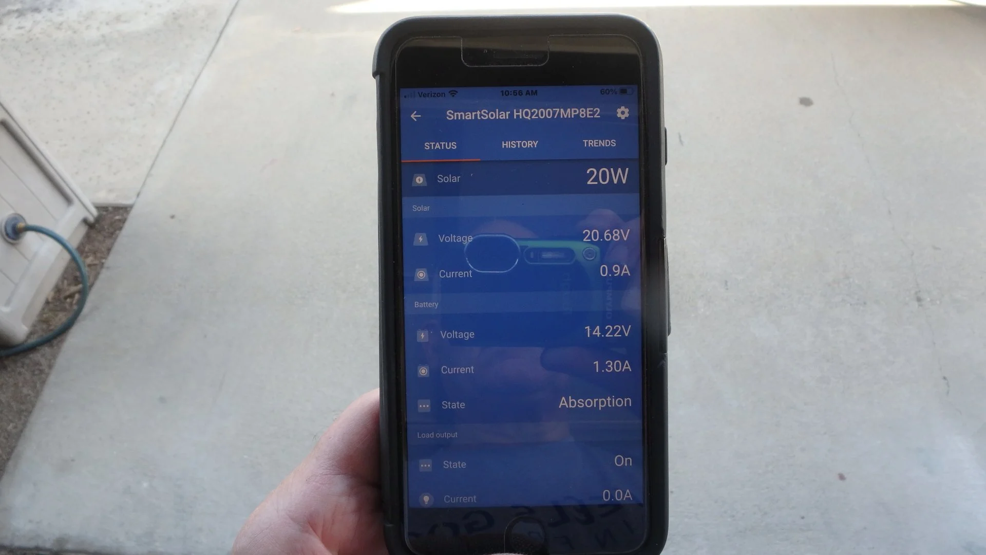

I also have a solar charge controller that is set up for AMG battery and has automatic float/bulk/absorption algorithms that keep my batteries charged and ready when I'm camping or vehicle is parked in the driveway.
One thing that is very important to remember is the ground is used to detect the path of voltage/amps and the power cable supplies it. This is with any modern vehicle.

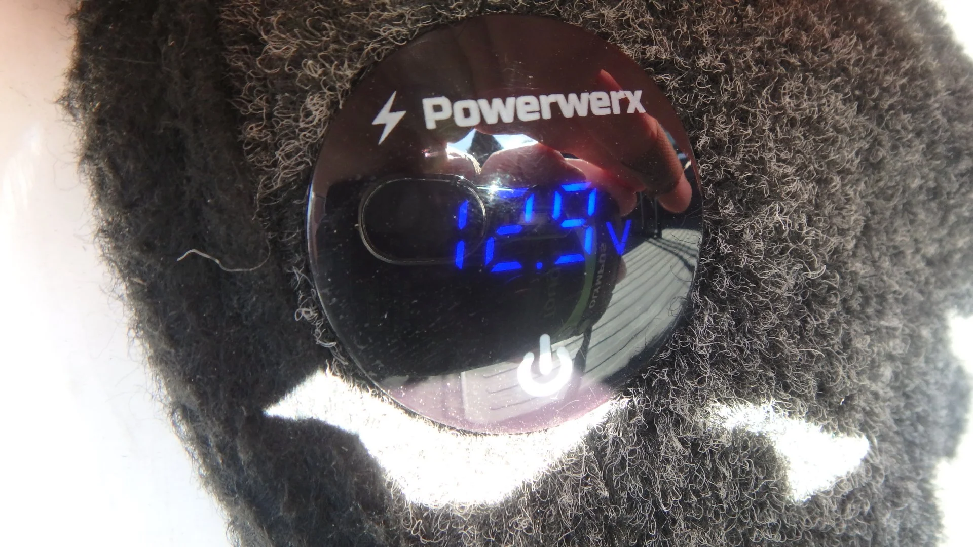

System wiring is 2 gauge. Each battery has a negative to the chassis and another connecting to each other. Stater battery has its factory ground as well. It’s thoroughly grounded. Positive goes from aux battery to the isolator switch then from the switch to the starter battery. The smaller gauge positive wire your seeing is a 10 gauge wire for the rear blue sea system accessory panel that runs the fridge.
I use this to keep the agms topped off:

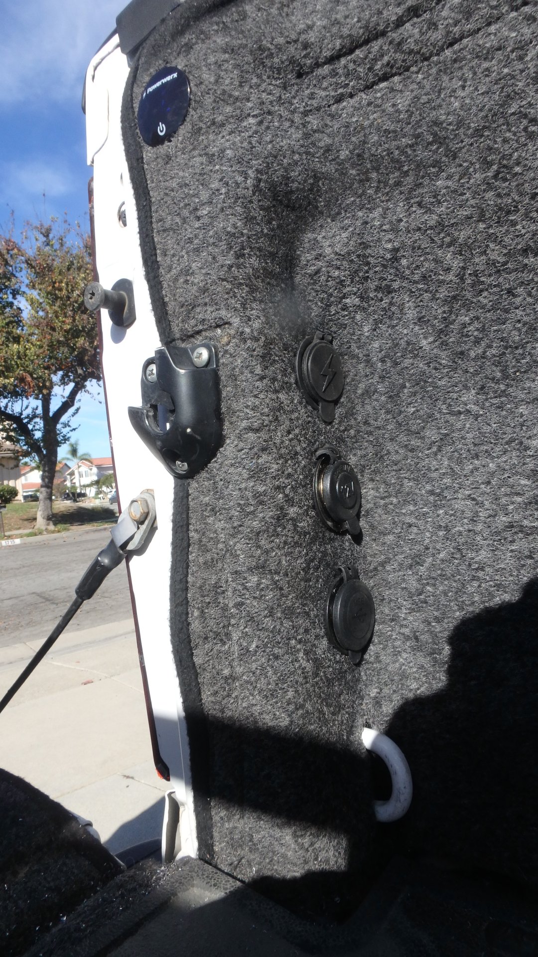

Right on and great Job. I to used 10 gauge wire for all my plugs in the back of my truck bed. I ended up using fused wire going through a circuit breaker and then to a busbar that has super HD marine cig plug and Anderson connectors each individual fused from 45 amps for the wire.

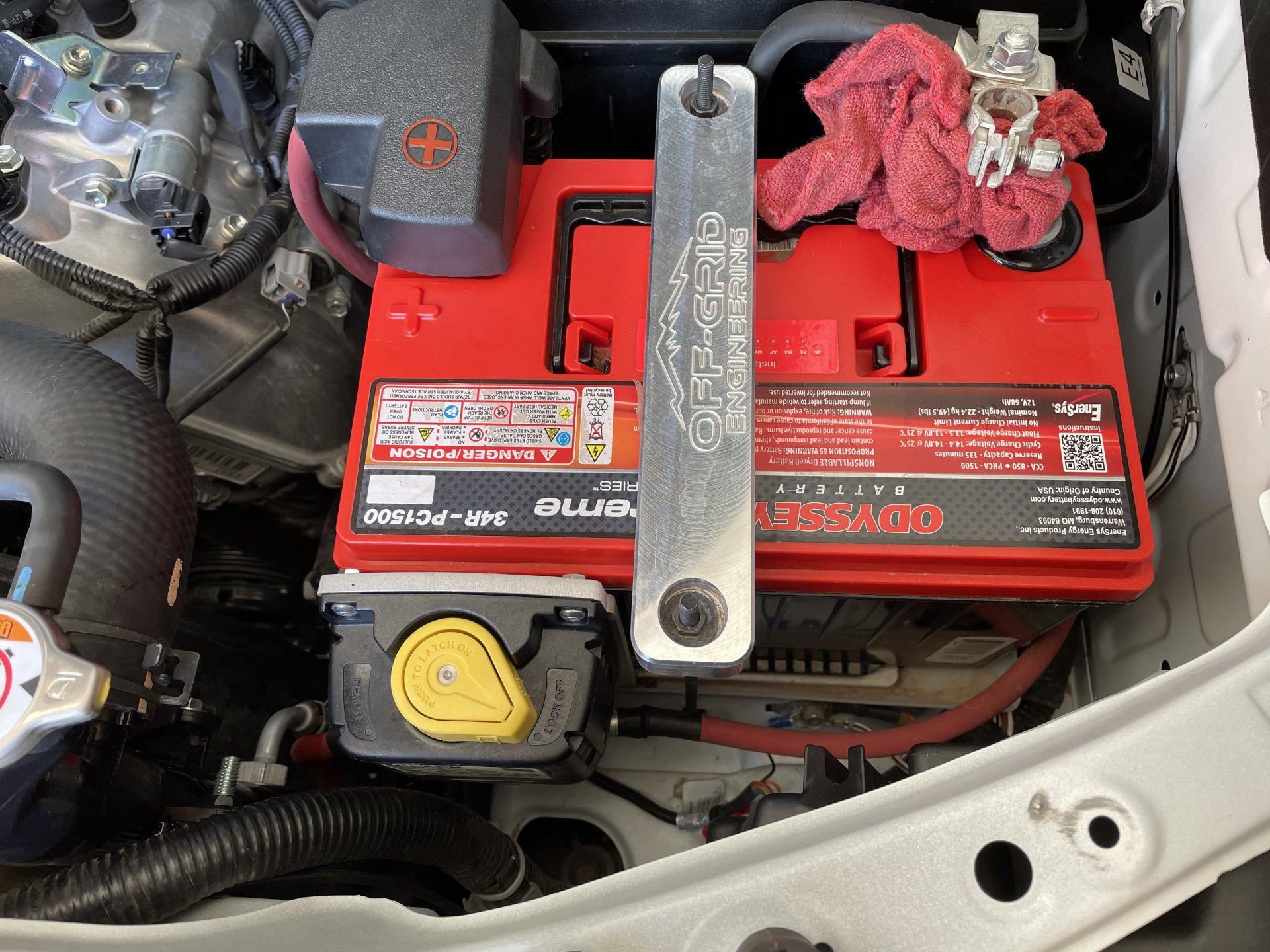

I have the Offgrid system in my 460, works fantastic. no issues, no noise.
It looks like OffGrid kits parts, if sourced directly cost a couple of hundred less than the kit itself. Is that the convenience fee if i get one of the kits or something I am missing from the description given online?
think you're missed the vehicle specific brackets and mounts, not sure how you could order those directly. I just like how well it's laid out. Kits has you move a few things around in the engine bay to make enough room for the second battery. Give them a call.
