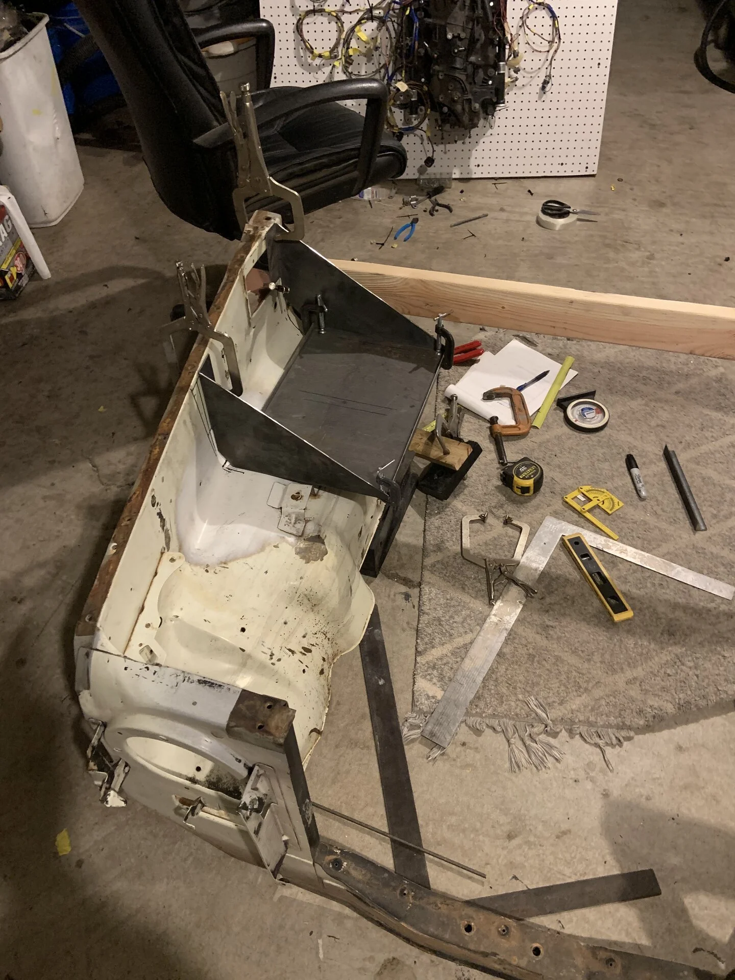

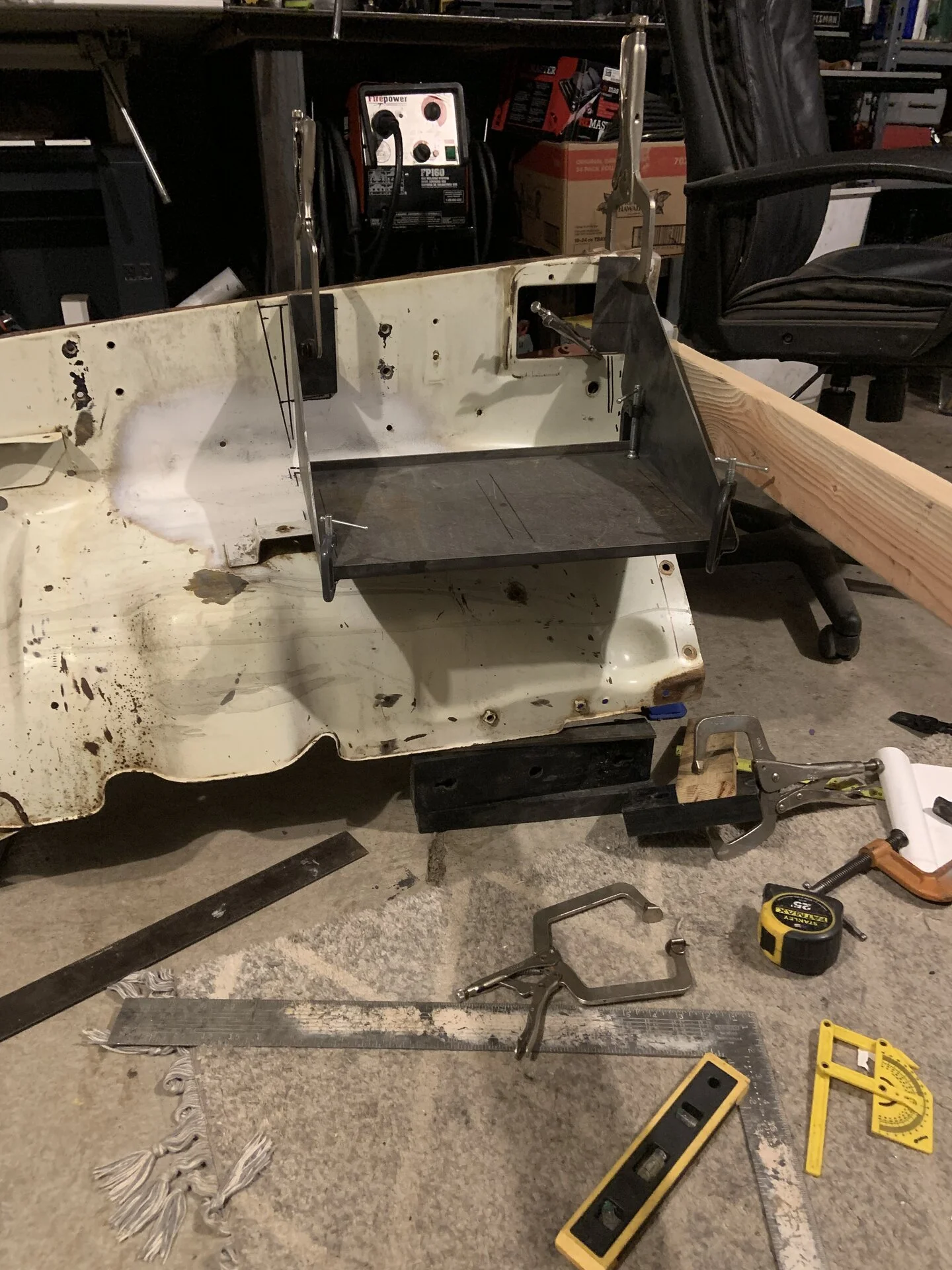

I’m really liking the dual side-by-side setups like Scrappy’s and a couple others. Unfortunately, the guy who built his mount is no longer making them.

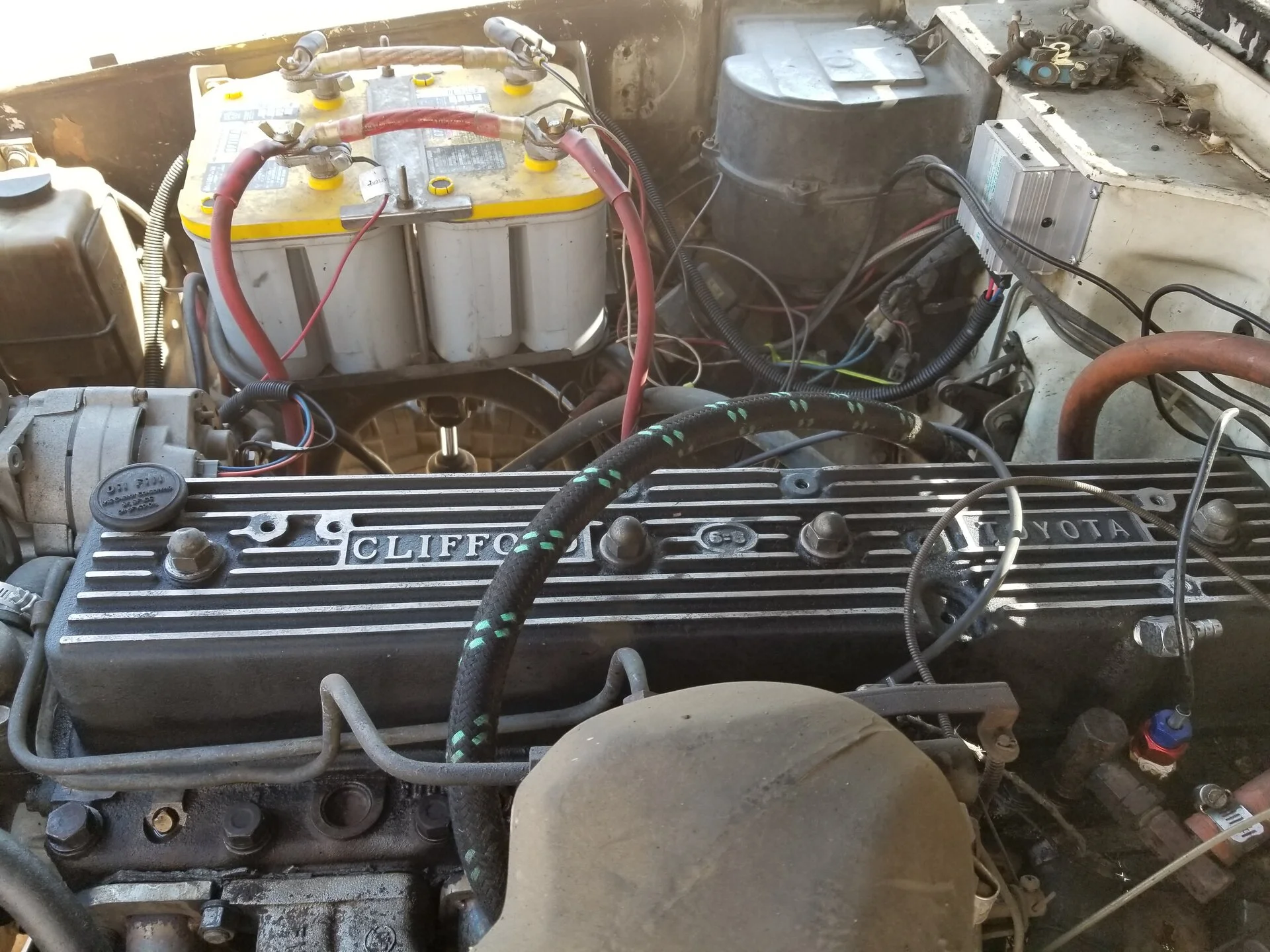

I ran dual batteries in my old 40 series with a regular starting battery and an AGM 100AH second battery. both batteries lived in the engine bay and the 2nd battery was charged by a Voltage Sensitive Relay, basically when. it saw over 13.5v it would join the batteries to charge the 2nd one, and disconnect at 12.8v.. it worked fine and the AGM lasted plenty of year but I've gone slightly different with the 55.

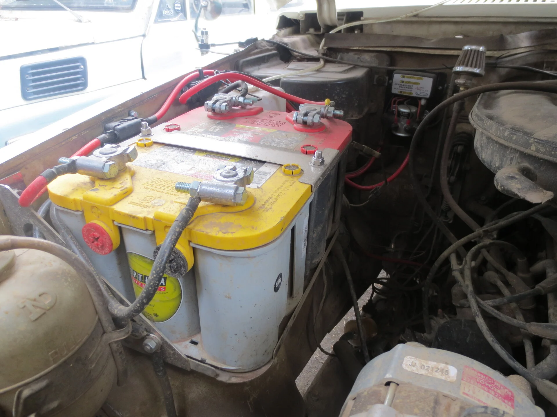

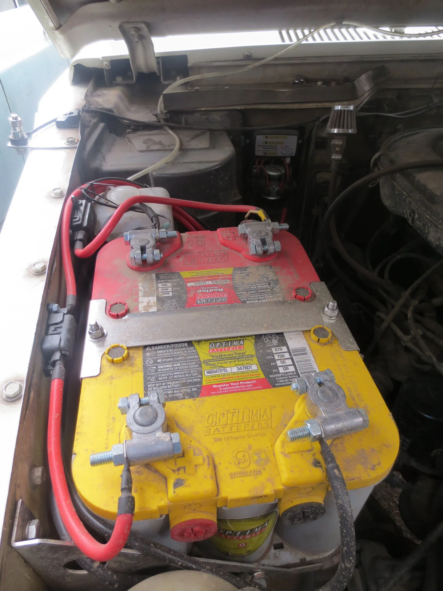

These are old pics... I'm running two Optima yellow tops currently. Paired with an old National Luna unit. Stainless double tray-from back in the day. I dig it.

22 years ago I bought two stainless FJ55 battery trays from guy here in Reno. One in stock area and one mirror image on opposite fender.

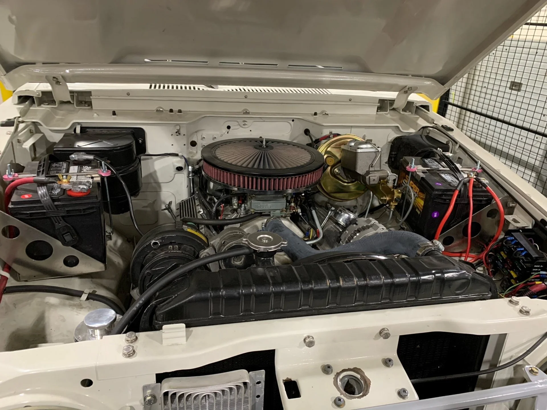

Sorry for the hijack , But can i see that Transmission ? cooler ? Looks different than most ?
Also thats a nice clean Chevy swap
Thank you for the compliment. Yes Transmission cooler. Bought off ebay years ago.
I remember when I ordered, he said mine was the last one and had to be pieced together from other trays and that was years ago. Maybe time for another run of them.
Post your dual battery set ups with Pros and Cons and length of time you had your system. To help others with a selection 😘👈👉🧠
I got one of those. I got the prototype dual optima tray too. I talked to that guy in Reno, i might have sent him a stock 55 tray, i forget. He brought me the first one for a test fit and left it with me. That had to be 20 some years ago. I bet i posted pics at the time.
I ran dual redtops first, switched to yellow tops later. Ran them connected in parallel for years, just recently added the isolater. Thinking of removing it though.
