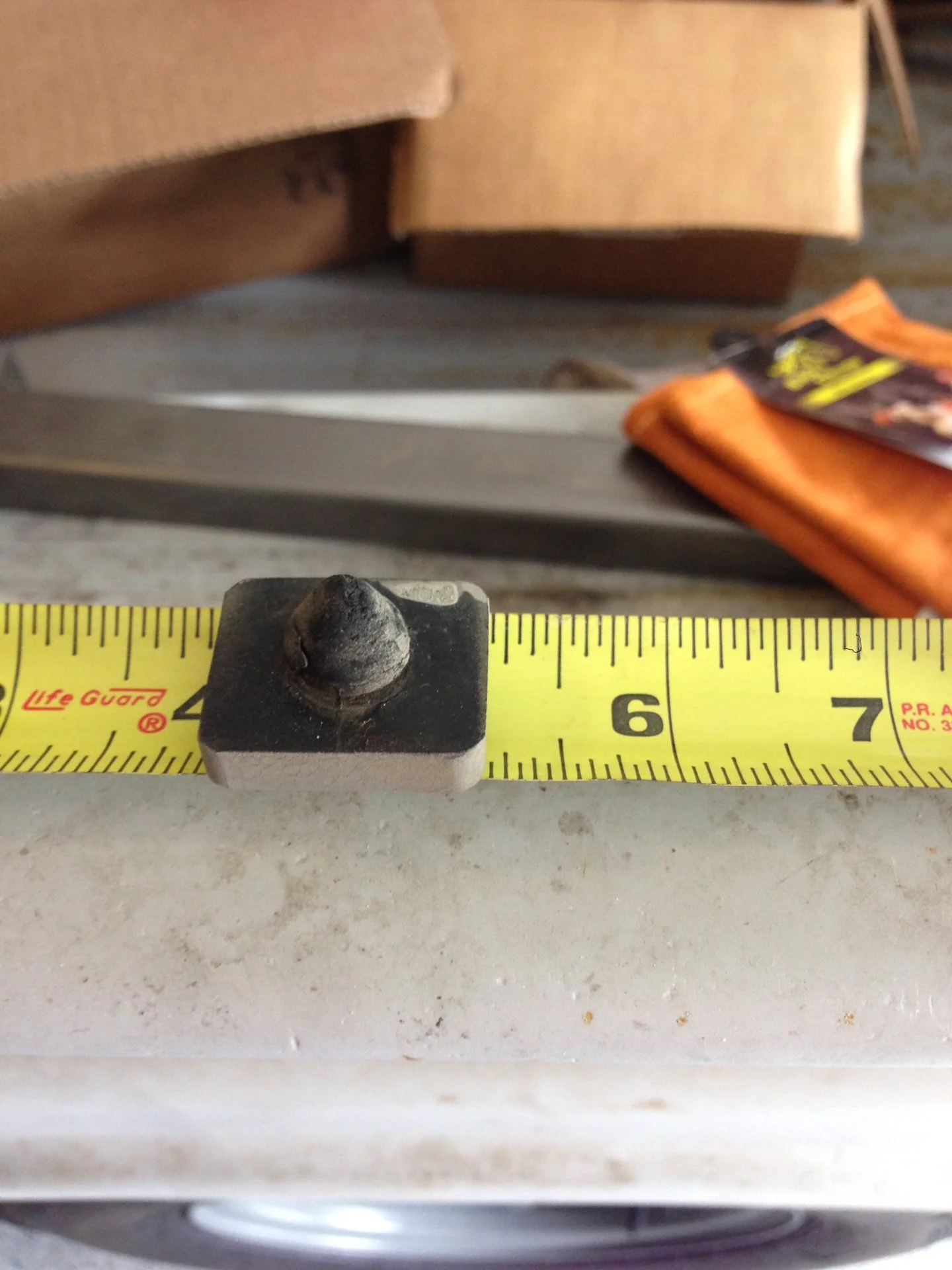

THERE ARE 2 TABS BEHIND MY DRIVERS SEAT THAT USED TO HAVE RUBBER BUMPERS ON THEM FOR THE SEAT BACK TO REST UPON, WELL, THEY ARE MISSING, WHAT YOU Y'ALL USING TO REPLACE? THANK YOU,

I could be wrong, but i think those bumpers were also used somewhere on newer FJ40s and are still available.
I THNK THEY UP ON THE UPPER REAR CAB ON THE NEWER TRUCKS SINCE SEATS GOT HIGHER. IF ANYONE KNOWS WHERE TO GET THEM. PLEASE HELP ME OUT. THANK YOU,
BRANDON
The same bumpers are used for lower window stops in the early doors, maybe source a couple from junk doors?
I found two original, "like new" bumpers in the bottom of a couple of doors. I then found some generic bumpers to put in the doors, because nobody will see them.
I use a small flat blade screwdriver to carefully push the plug through. Sometimes I will use a lubricant also.
