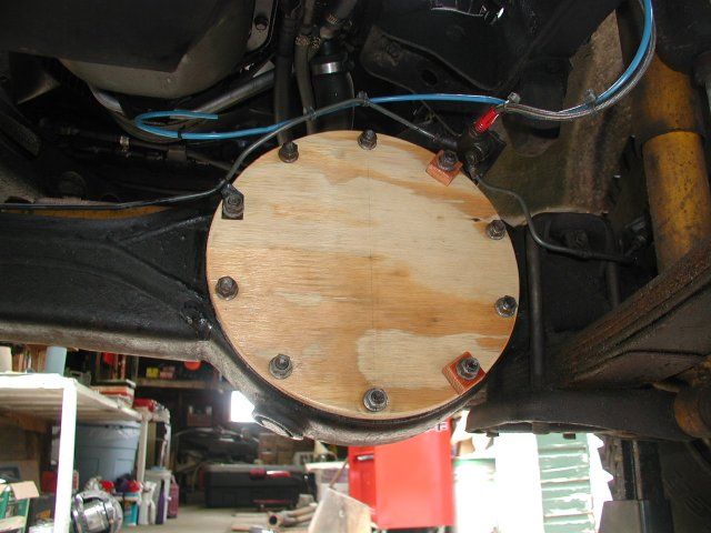

Ha, back in 2003 I was installing an ARB in the front of my FJ62 but needed the truck as my DD so I drove it for a week or so with no front axle shafts and no diff. I cut a piece of 1/2" plywood to cover the gaping hole in the axle. Stuffed rags in the spindles. No issues.
Edit: just remembered I had this photo
