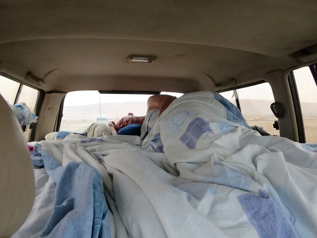

Make it high, so you'll have anough room left to store stuff!

Not my pic, but this is where I got the idea:

Here's a pic that gives you an idea of about what the space is like at my deck height.
