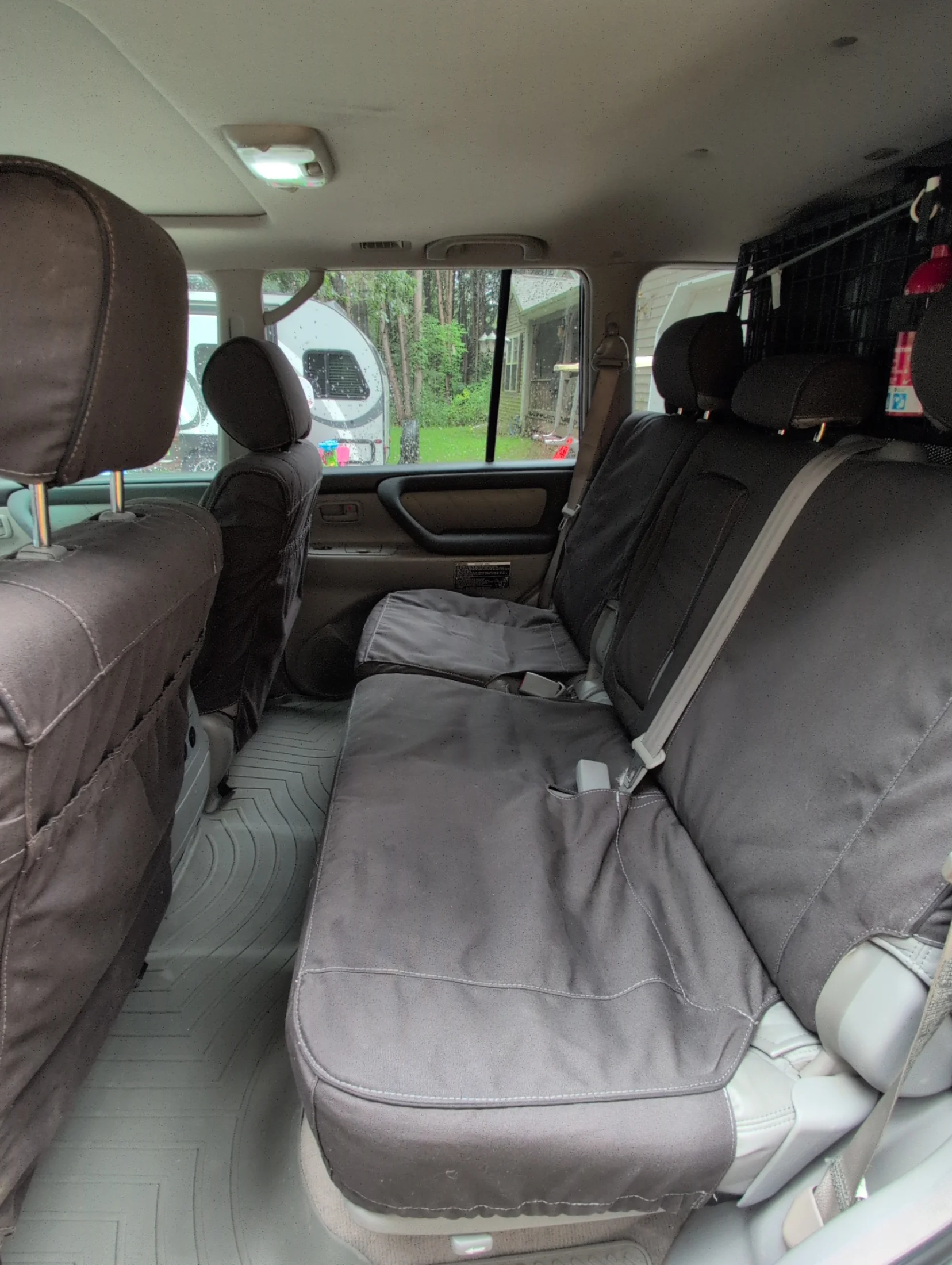

Added the 2nd row Escape Gear seat covers. Usually I run a 2nd row delete with a platform but being this is a family trip there are going to be three carseats, hauling a 4YO/almost 3YO/18 month old. Should be interesting. I already know which one is going to cause the most tension.

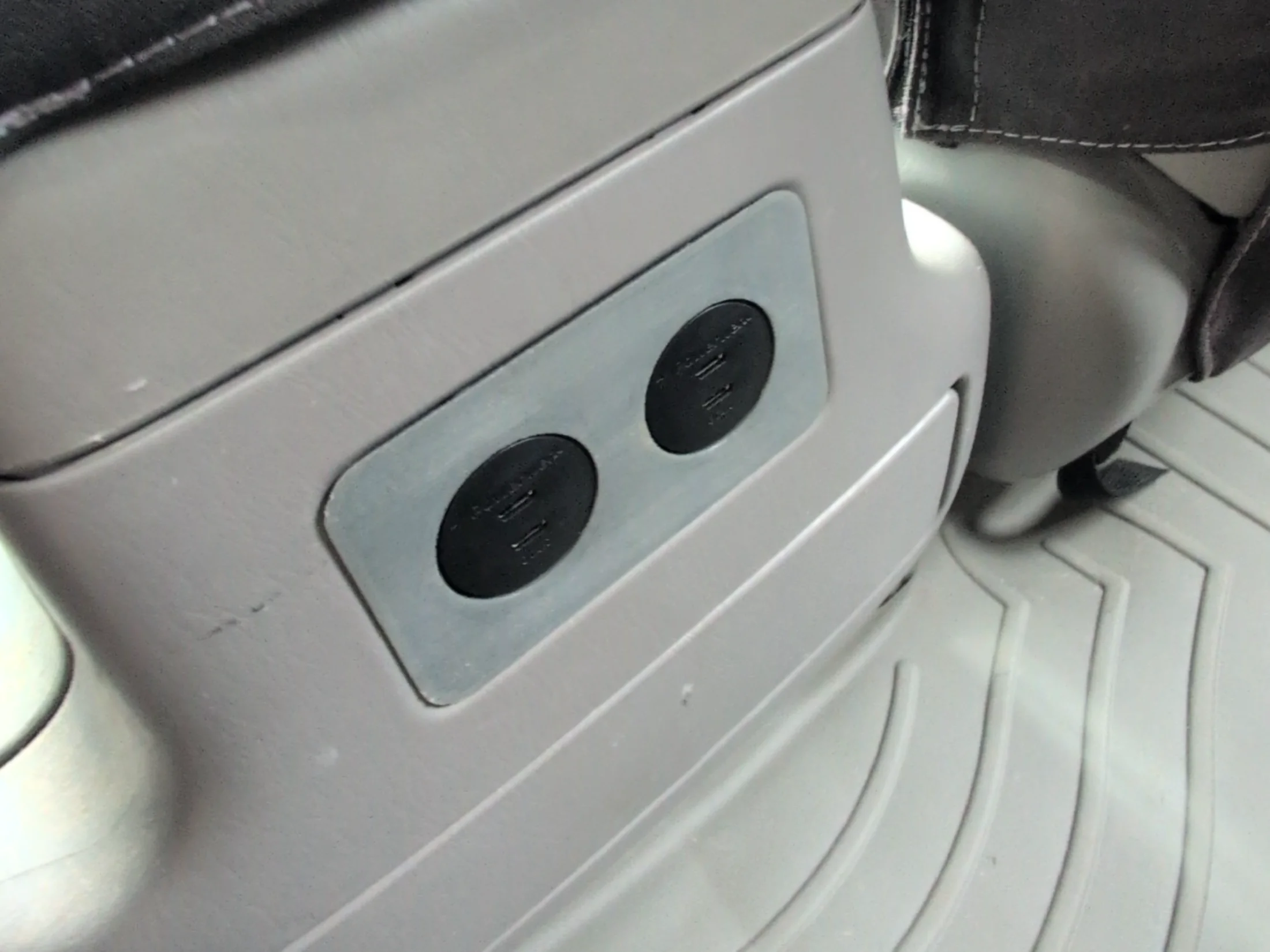

Added the USB-C Powerwerx chargers with a dedicated source. One note if you add these in this spot I found that due to their added length over the standard USB I had to 90* solder them.

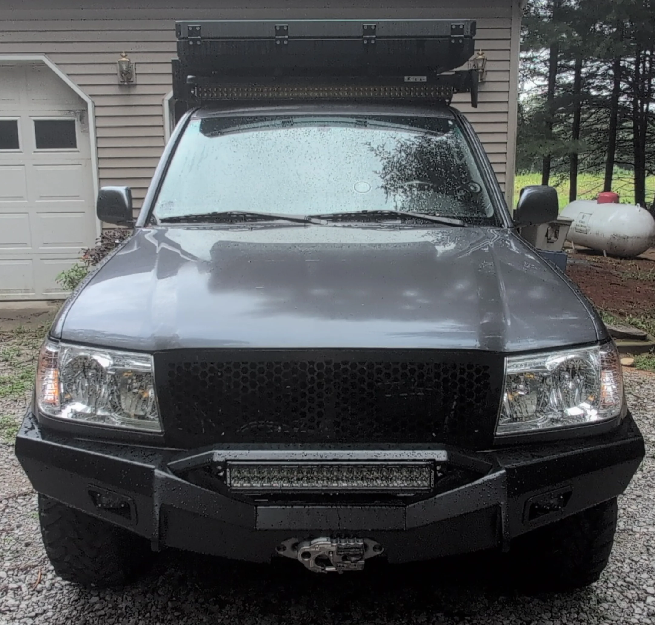

Added the Rigid Midnight E Series Pro 50” and 20”. The 50 is very tight and I had some interesting custom bracket work that took a bit of time to work out but all done. I think the 50 blends in well, both are bright.
Also in the bumper I installed Baja Designs IR lights for some stealth night driving.
Winch is Warn Zeon Platinum 12-S with Factor 55 components.
