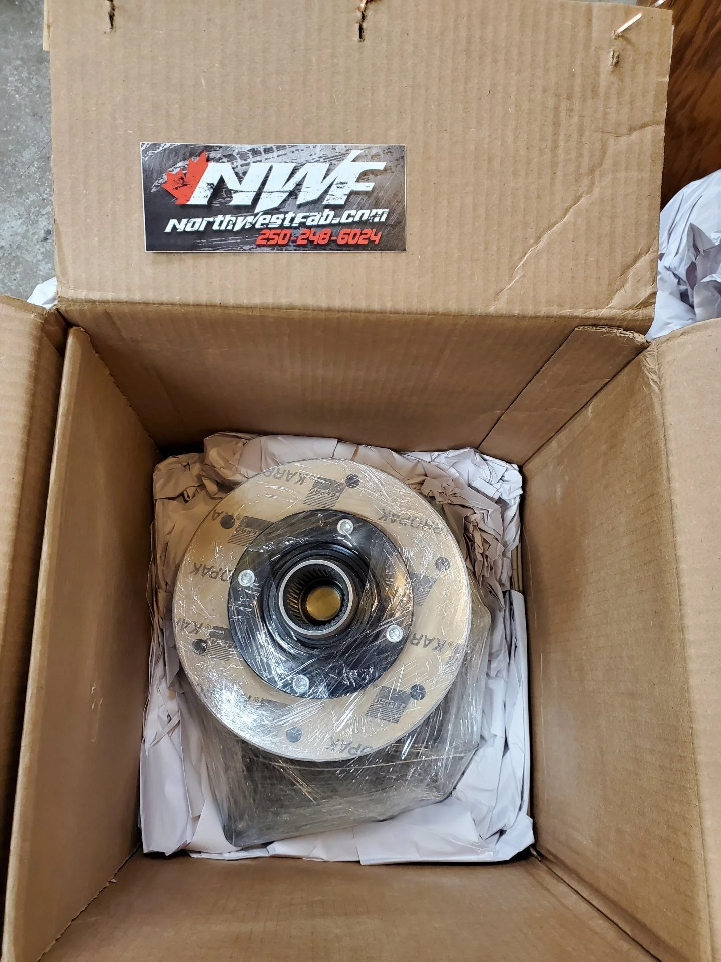

Here it is unboxed. You have vent, fill, and drain ports already tapped, easy to adapt for either a pump or to feed it with ATF. Looking forward to tearing the tcase down to get that mainshaft installed.
Few install highlights. You CAN swap the mainshaft without tearing the tcase down. Though to be honest, I probably would just tear down the tcase if I were to do it again. Goes together pretty smoothly all together, and comparing to the older version, this definitely has a ton more fluid capacity. I know they say double, but it almost looks more than that. And I missed another drain port down low. You have the vent, plus three additional threaded ports to work with.
