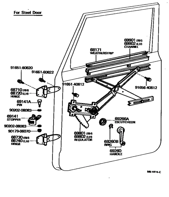

Believe it or not, there is no such thing as door bushings. The original part was just a flat nylon washer. You can see it in this diagram. Part # 90202-08083.

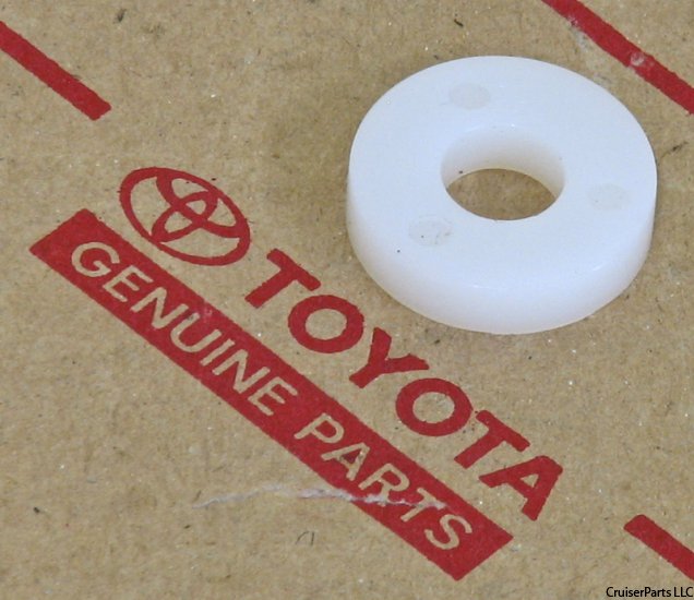

There is a plastic bushing from the Toyota parts bin that looks like the photo below, part number 90386-08004. Mostly you find this style with aftermarket pins. It's not original equipment on the FJ40.
It's not original equipment? Then do u know what is? Looks like your part number is correct. I will check Monday at the dealer. Thanks racer
That's the nylon washer for the door stopper - nothing to do with the door hinges.
This is what is on my doors and I'm fairly confident they had never been removed before I did last year.
This is the bushing for the door stop pin not the hinge pin. I'm guessing the hinge pin bushings weren't available separately when that parts diagram was printed.
I took apart brand new hinges from Toyota to install the brass bushings and the picture shown was what were in the hinge set. So at least in my case these were OEM.
-Geoff
Yup. Upon further investigation, that is indeed the case. Looks like the bushing is not shown separately in the parts diagram. The part that comes with the new hinge is 90386-08004, but I'm not sure if you can get it from the dealership.
