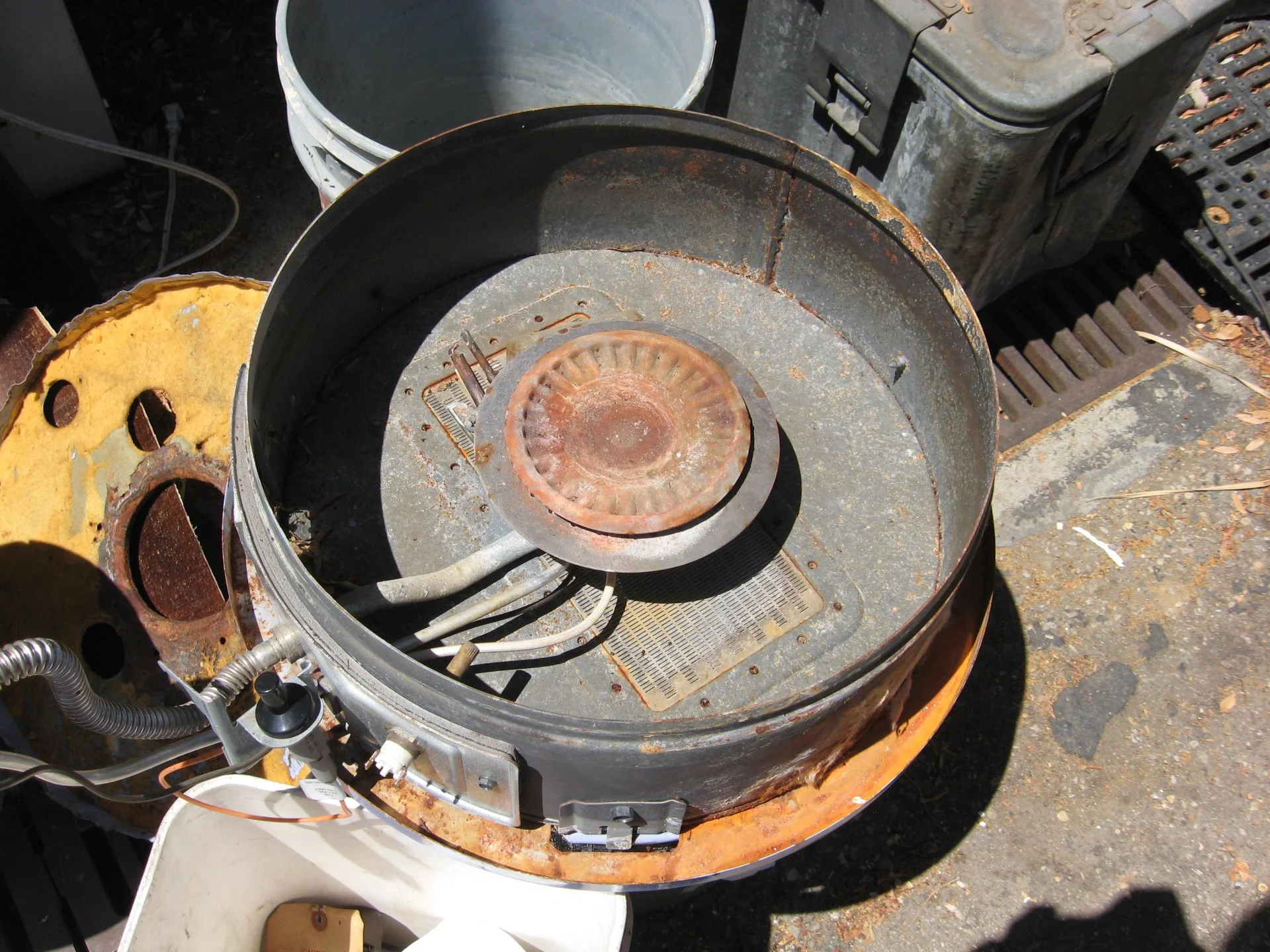

Mine just conked out. I took it apart out of curiosity. Turns out the burner assembly not only separates in one piece but it has a very nice metal ring around it that is perfect as a support for large items to warm up or cook. High power, of course. Built-in air intake, the works.

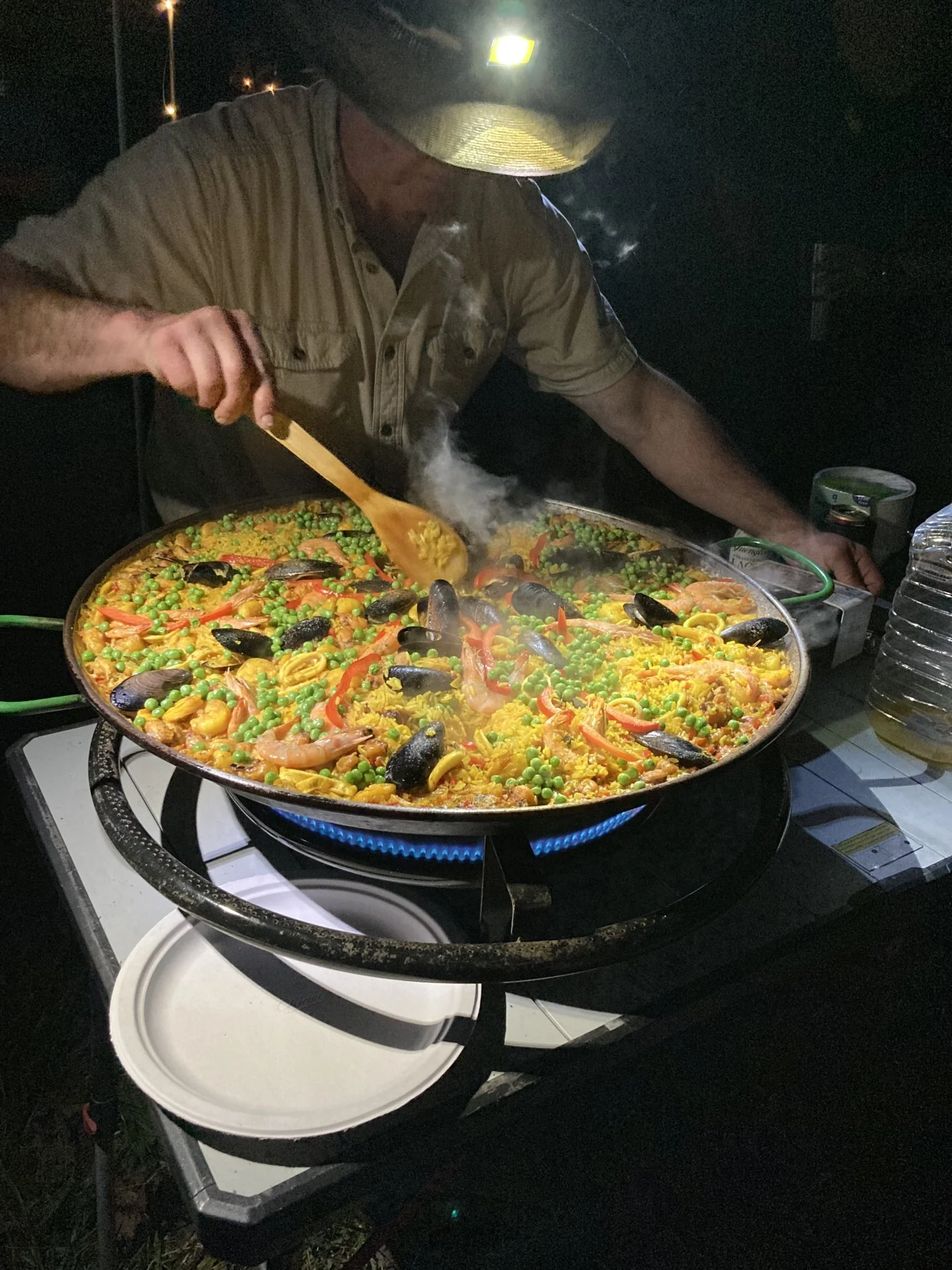

I plan on using it as a paella burner. For others, it may be great as a wok burner or for clambakes, turkey frying, whatever. Nice big burner, built-in piezo starter if you fancy that. Don't plan on using the gas control valve assembly, TBH, but could. May build a grate for it for other things, but amazingly, my paella pan does fit in just right in the ring, perfect size for it, so just few holes for combustion gas escapes along the rim might be fine for that.

OK. I decided I'll use the original gas control valve for now to check things out. So no futzing with the connector. Works. Sort of of.
Used a grate for now because the paella pan would block the gases from getting out without holes.
First, I had to bypass the overtemp sensor cuz that thing was getting way too hot and did shut things down with a pan on top. (Maybe the flue on the water heater would suck the heat upwards and not have the sensor get as hot, unlike here, not sure.) OK, easy to fix (paper clamp below).

If you're into that sort of things, that is a Matfer-Bourgeat black steel pan... a real pleasure to use.
