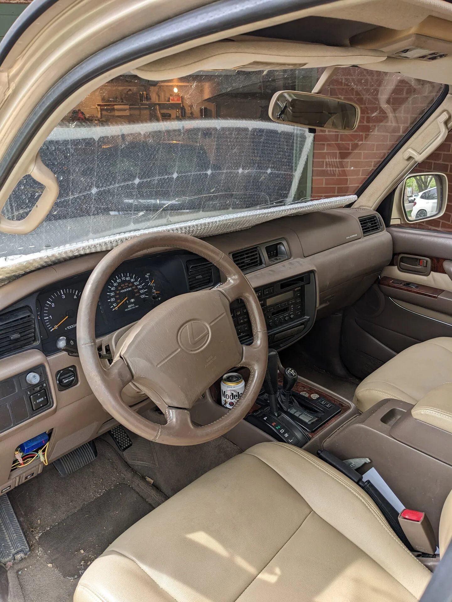

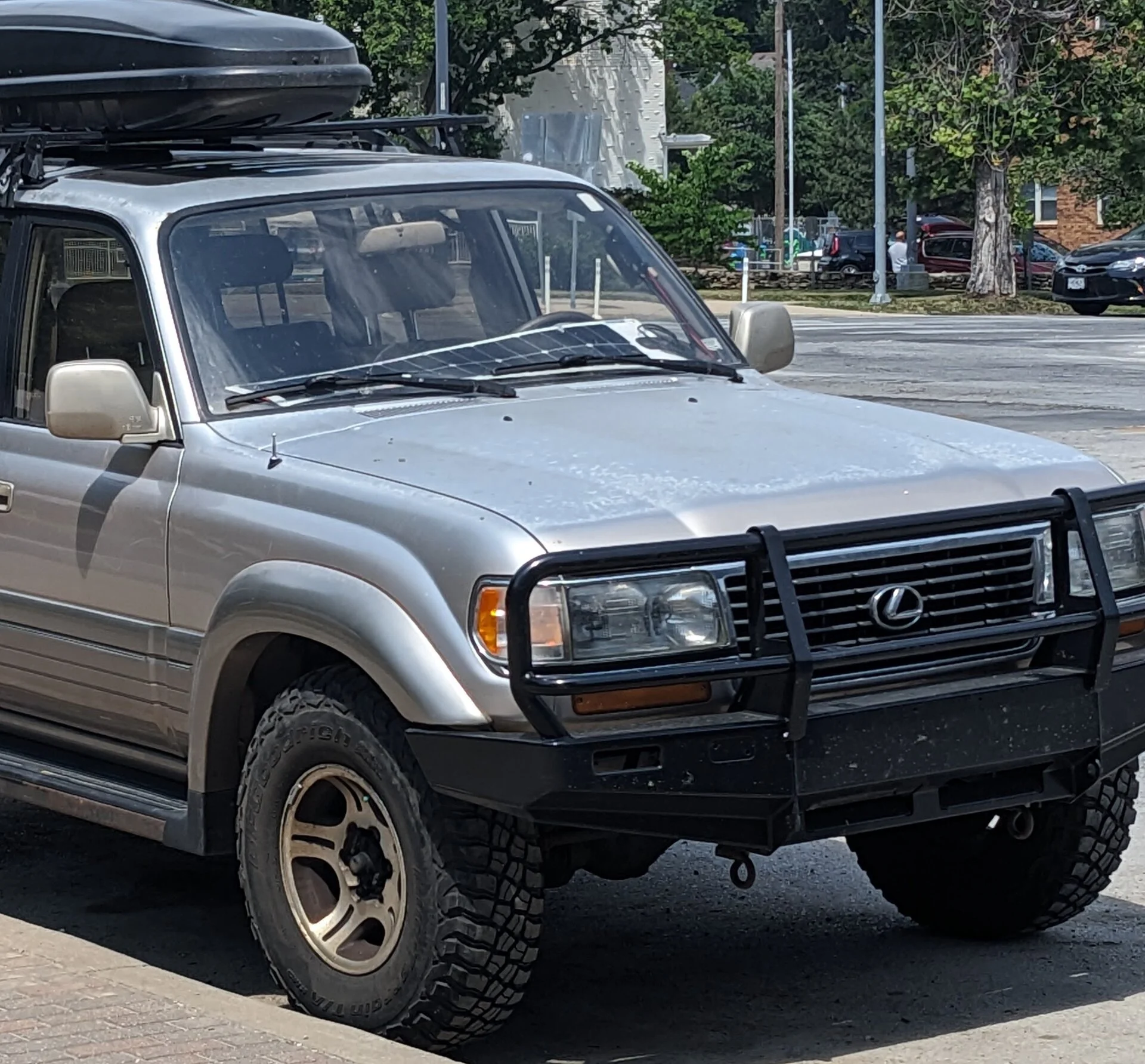

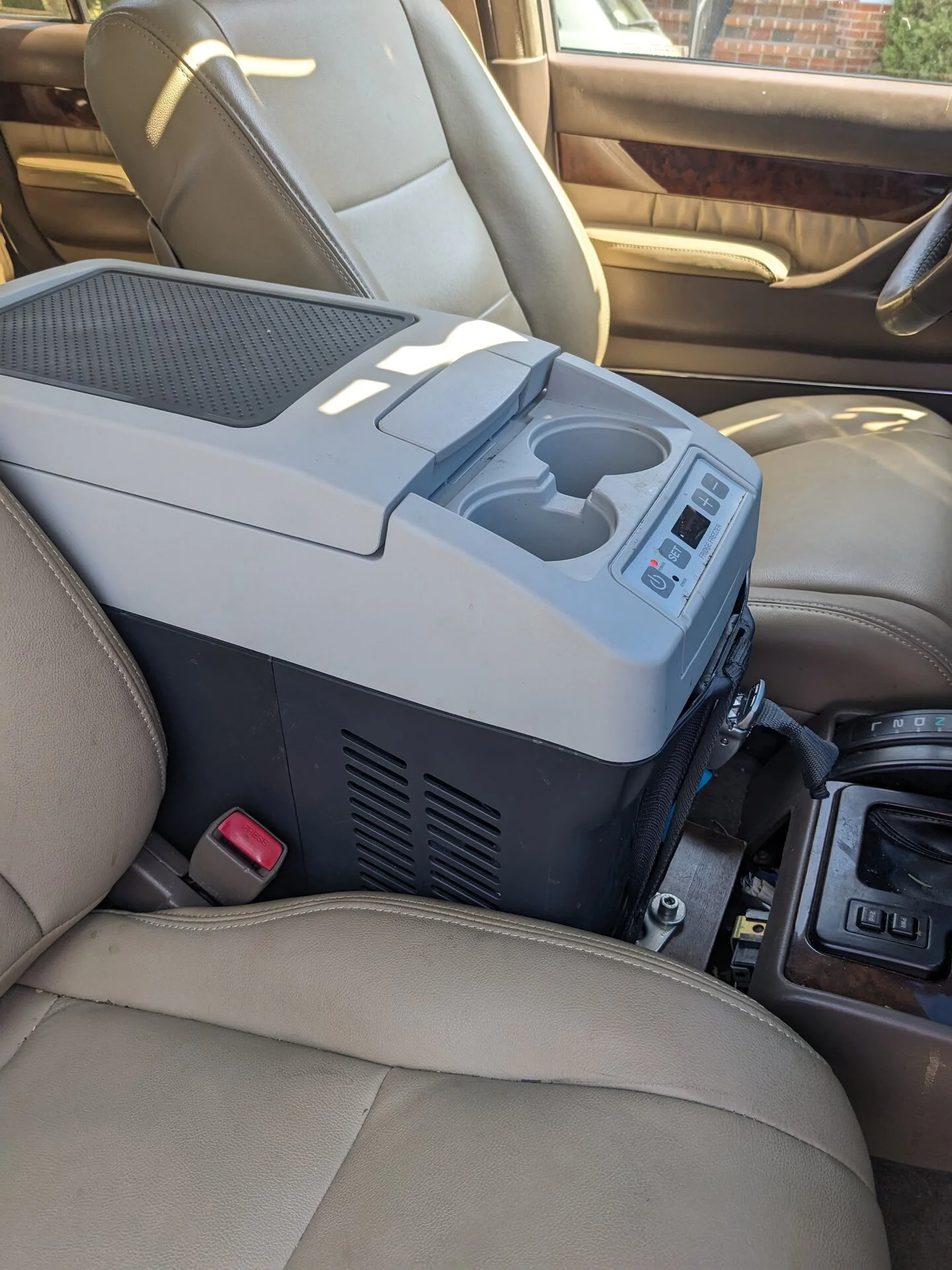

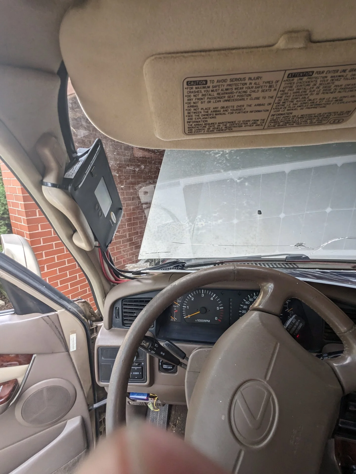

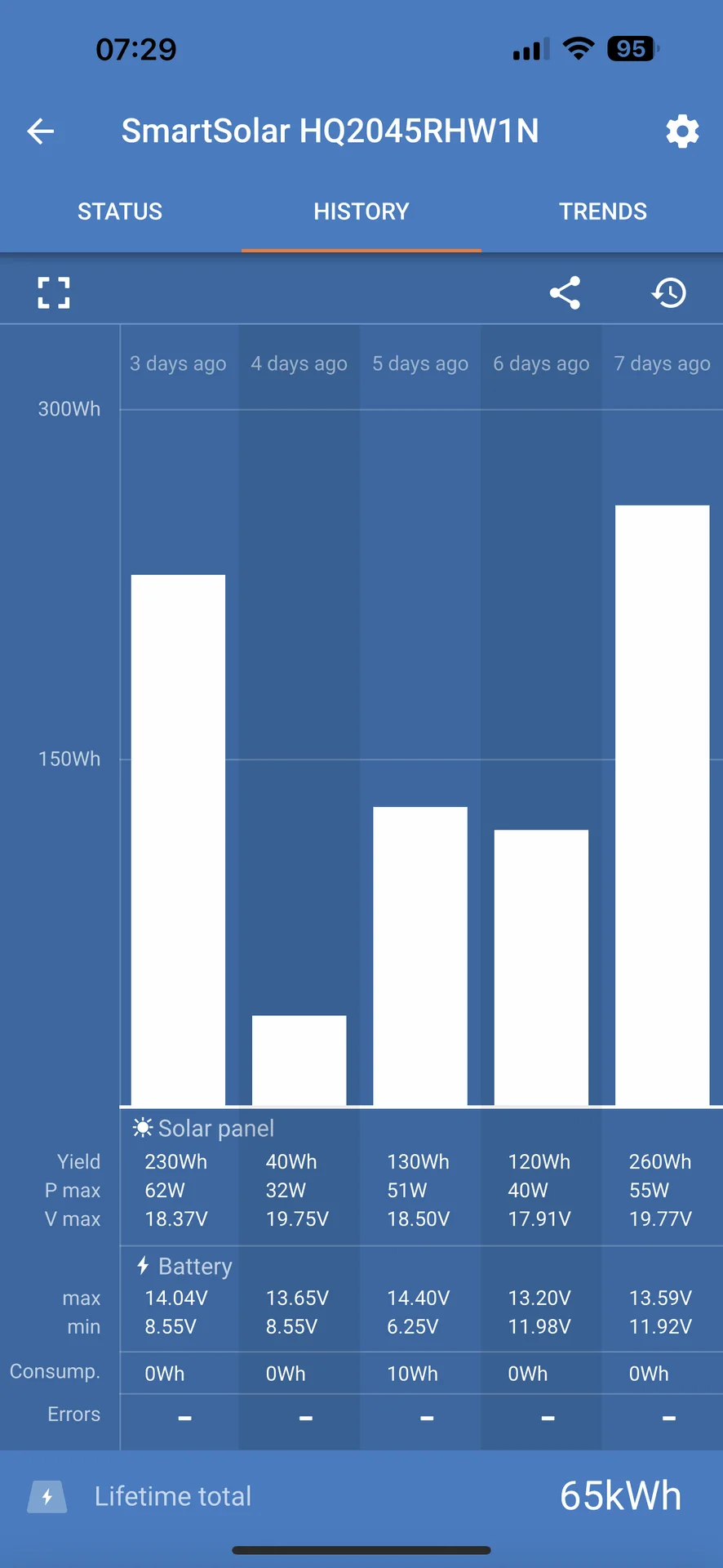

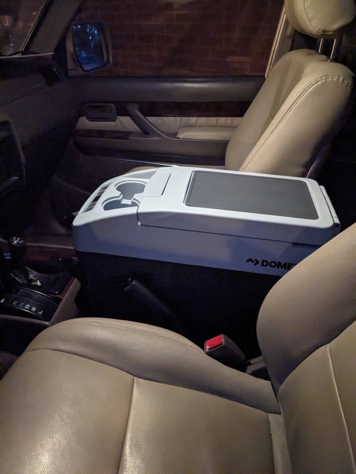

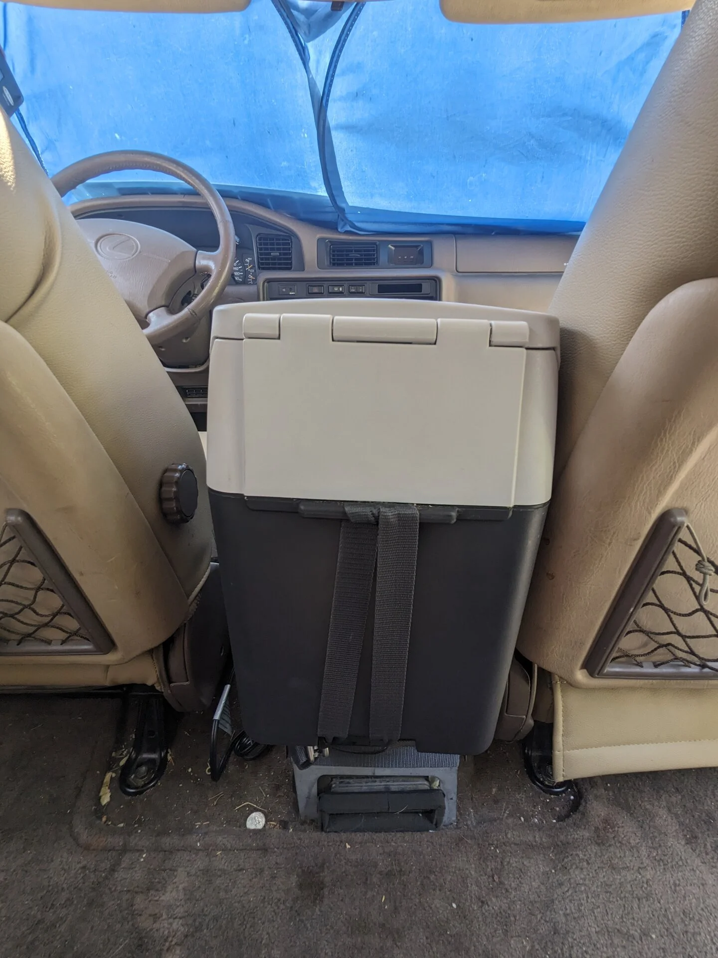

Sharing a few photos of my dometic center console build. I paired it with the 2nd battery tray under the hood, paired with a Costco group 27 marine battery (88 amp hours?). The solar is a flexible 55w panel that just barely overhangs the dashboard. In the summer I've been getting about 2.2amps during peak hours. The console sits just a little high, but is a welcome addition. I occasionally plug it in to a trickle charge once a week to keep it topped off. Currently the 2nd battery is completely isolated from the starter battery. The charge controller is fairly out of the way on the driver grab handle.
I thought about the cascadia system, but I got my 55w panel and charge controller for $220. It's a little harder to steal, and the dashboard gives your panel some tilt! I may add some hood solar eventually, my charge controller could accommodate the extra 90w or so.

100 watt panel…paired to 2 agm batteries and a solar controller…seen 300 watts on decent days…used to maintain an Engel fridge freezer…24/7
The 100watt panel puts out 300watts, or do I misunderstand?
misunderstand…
panel is rated for 100 watts…over course of the day can generate 300 watts

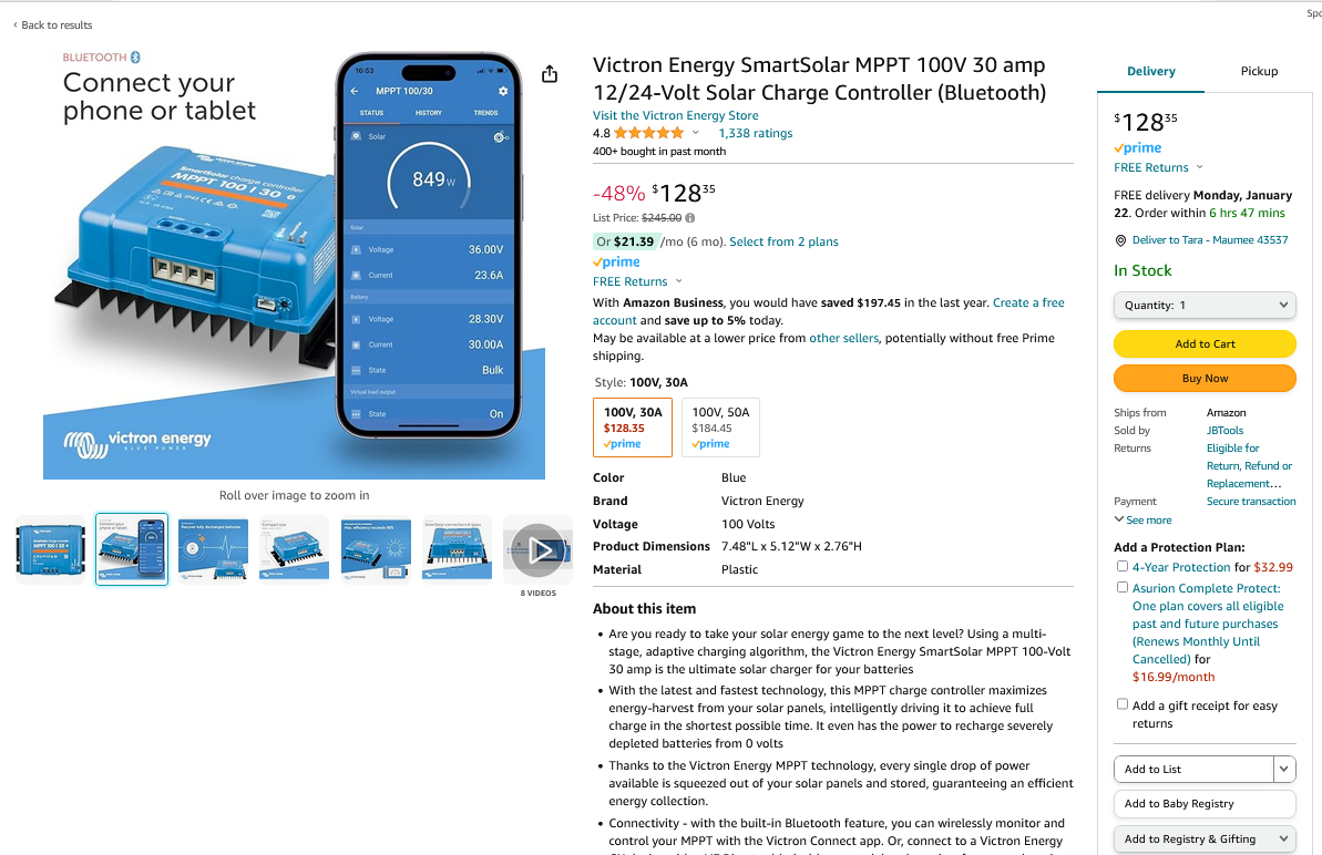

If you haven't bought a solar charge controller already I highly recommend Victron equipment. Run the PV panels in series to keep voltage higher (~40vdc with two 100w panels) and amperage low (less than ~5A). The the controller can then make the most of the output (~16A @ 12v using MPPT) even in low sun conditions. These are on sale right now for $130 (100/30 unit) which is a great deal.
