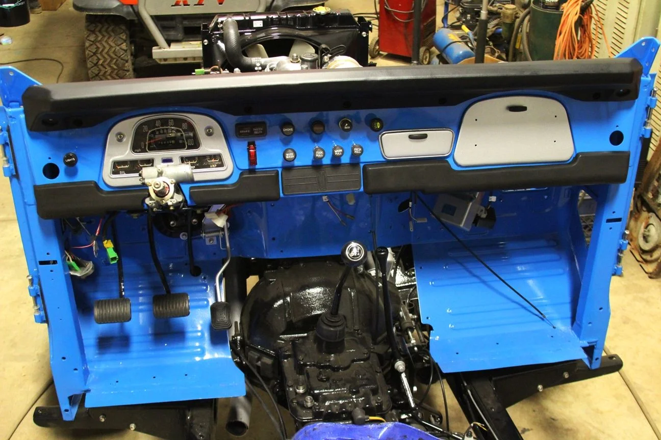

I also assembled and installed the pedal hanger and several other firewall components. Started getting more serious with the wiring harness and installed a few pieces because I knew where they went. Need to refer back to the old pictures so I can put the rest of the knobs/switches back in the proper place. The gauge cluster is not in for good. . . just test fitting and wanted to see how things looked.
I did pull the gauge cluster apart so I could clean everything up on the inside. There were a few patches of superficial rust on some of gauge faces so I tried to clean them up/paint them as best I could without covering over the lettering. I also taped off the glass and painted the outside cover a fresh coat of silver.
Again, the fasteners are not tightened down -- just test fitting to see if I like the color combination.

Bolted up the steering column support and have been slowly installing the wiring harness and all associated connections. Cleaned up the original lower dash pads and gave them a test fit. Found a new flipper switch on the shelf of past project leftovers and installed it in the mystery hole below the brake/belts light. That mystery hole must be for some sort of cable setup due to the bottom part of the hole being flat like the choke and heat pulls. . . perhaps a hand throttle? All the hand throttles I have seen in the archives mount on their own little tab below the main dash though. I was planning on running a small inverter into the glove box and the switch could be used to run that; not sure if I like the look yet though.

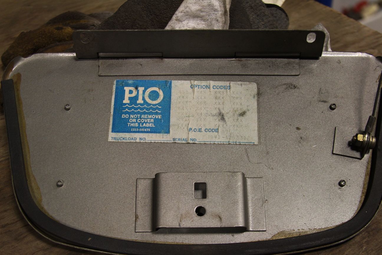

I was cleaning up and getting ready to blast the glove box lid and I thought some kid long ago decided to slap a sticker in the inner face.
Closer inspection suggests it might be an original shipping label? Maybe even from the boat ride over. . . I am thinking those are ocean waves under the "PIO." The tag lists the truck serial number, truck load number, and option code "860." Cool to think that it has survived all these years. . . just like the tag on a mattress with "Do not remove" but missing the "under penalty of law." I will attempt to clean up the inside of the lid and preserve the decal.

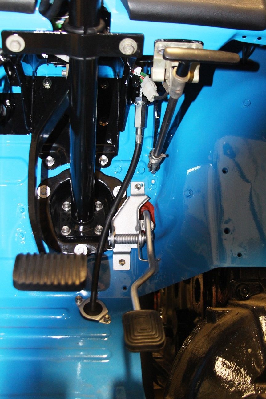

To keep this post somewhat Toyota Tech Related I did manage to get the parking brake pull installed under the dash. Loving all the Stainless Hardware @davework . . . the rate I am going thru it I will have to place another order soon!

That is the Port Installed Options sticker. Seen on 76-78s, on the glove box side wall or inside door. Some options were installed at Toyota port facilities. More info here. The option code on your sticker may be 880, rear heater.
