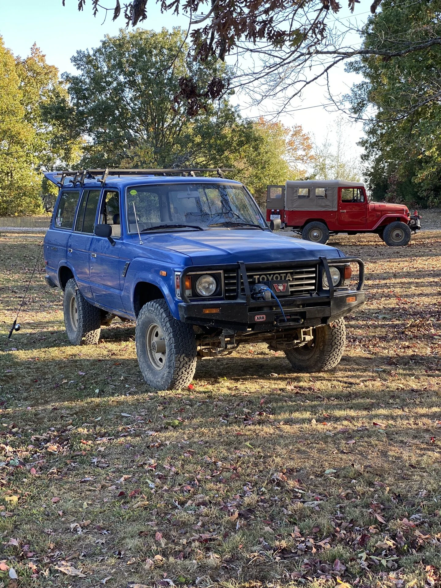

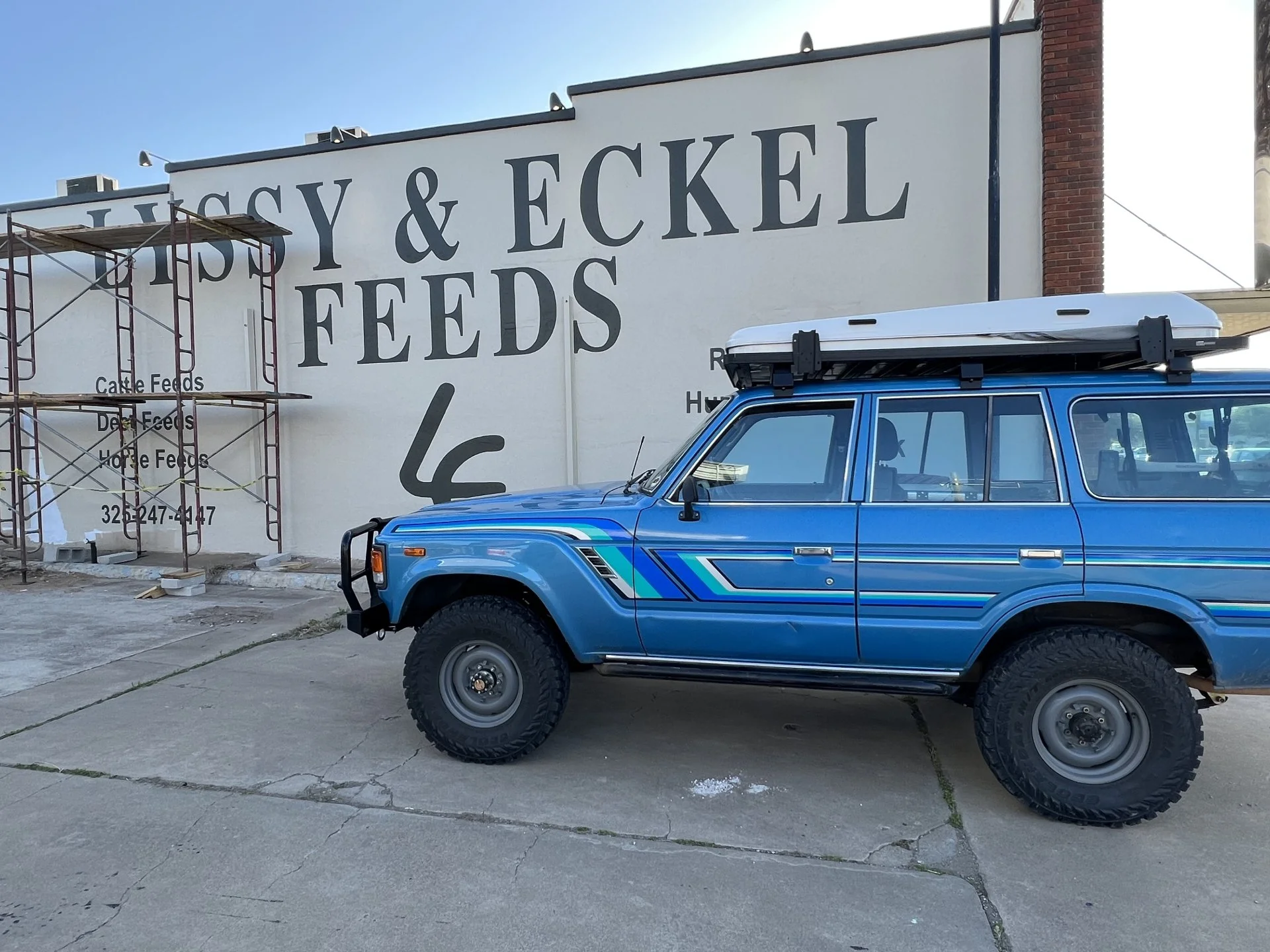

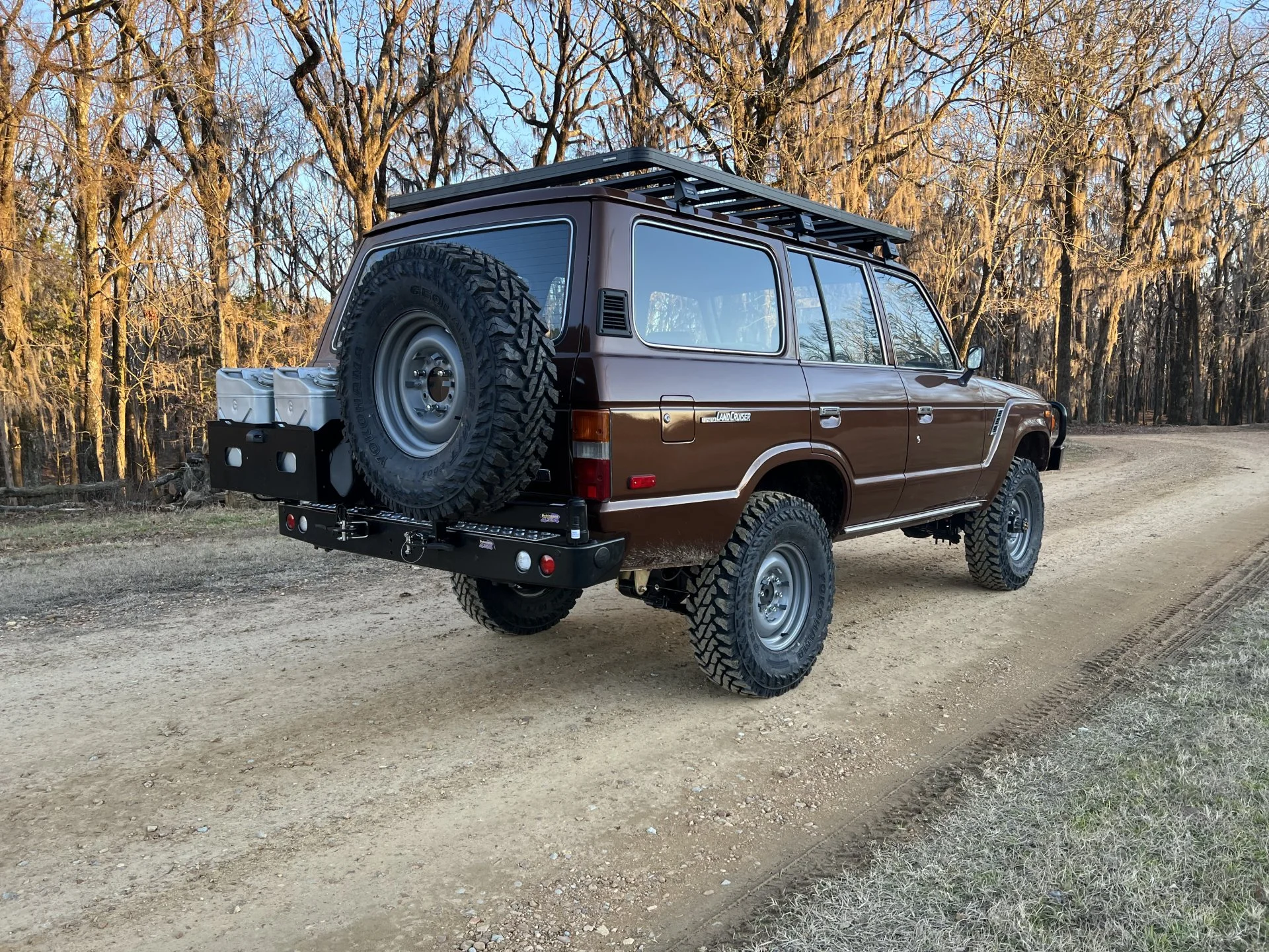

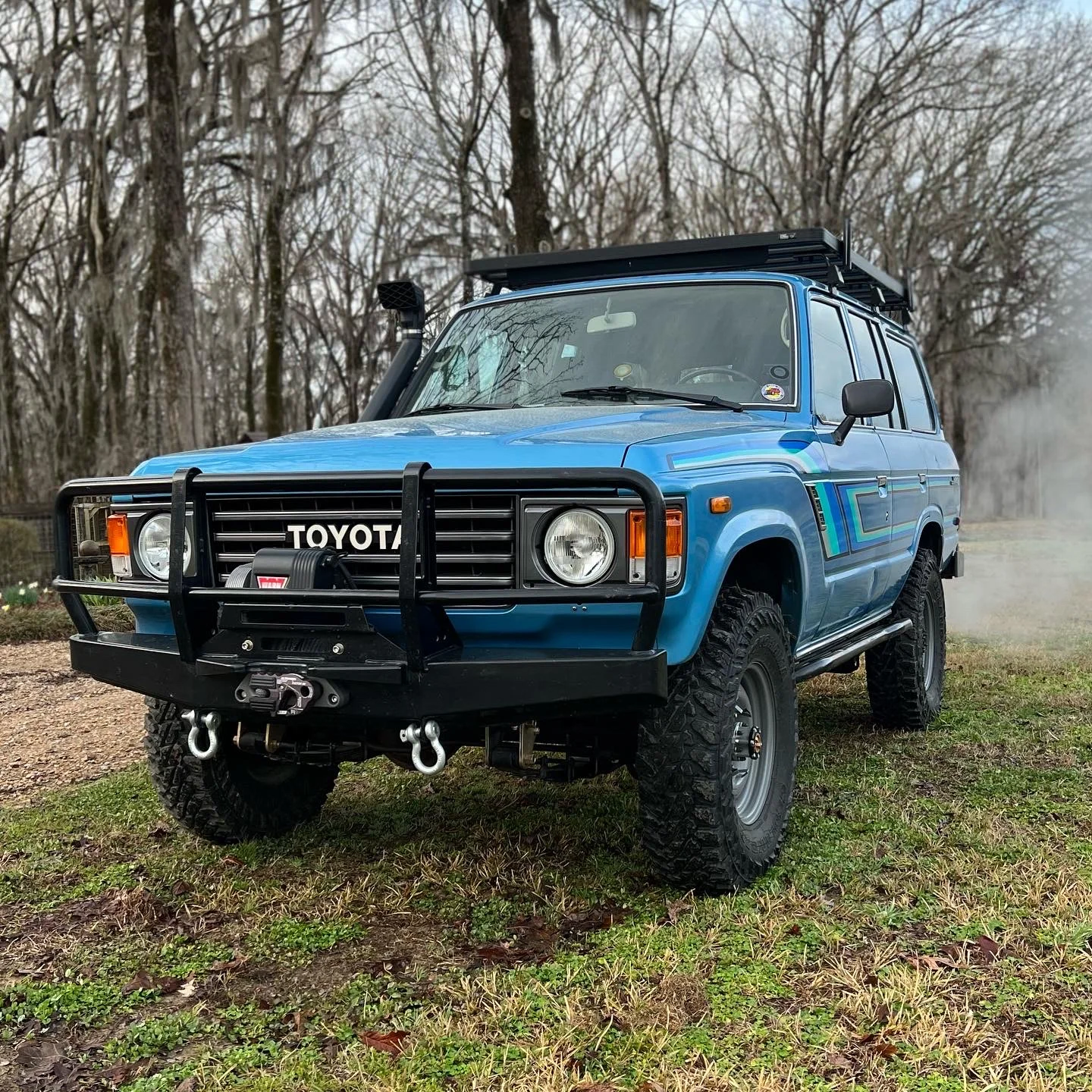

I have the MRR on my 60. I’ve installed 3 on 60s. 2 on 200s.
I have IMS on 3 40s and my 80.
The IMS and MRR share the same body.
Personally I prefer the IMS for most applications because Dobinsons has that shock super dialed in.
The only complaint about the MRR is that it
Is so adjustable I find myself always messing with them.
My 60 rides great.
Here are two of them.

These look great. Thanks for sharing. Are these 7 spring pack F and R? I hear you on over adjustability. I’ve had damper adjustable coil over setups before, and it always made me doubt I had it dialed.
Both sets of Dobinsons on FJ60s were Heavy front and medium rear. First time I chose that combination so I could adjust the springs down to my choosing versus having to go buy more leafs to add.
I ended up taking 2 leafs out. Can’t remember the final number but my Build thread is thread marked. See signature.
The second set was the same because of availability and I took the same ones out.
Dobinsons uses thinner leaves with more arch than OEM with no pads between the leaves. They are designed when new for the shackles to be vertical.
All new stuff to me but man they ride and flex incredibly

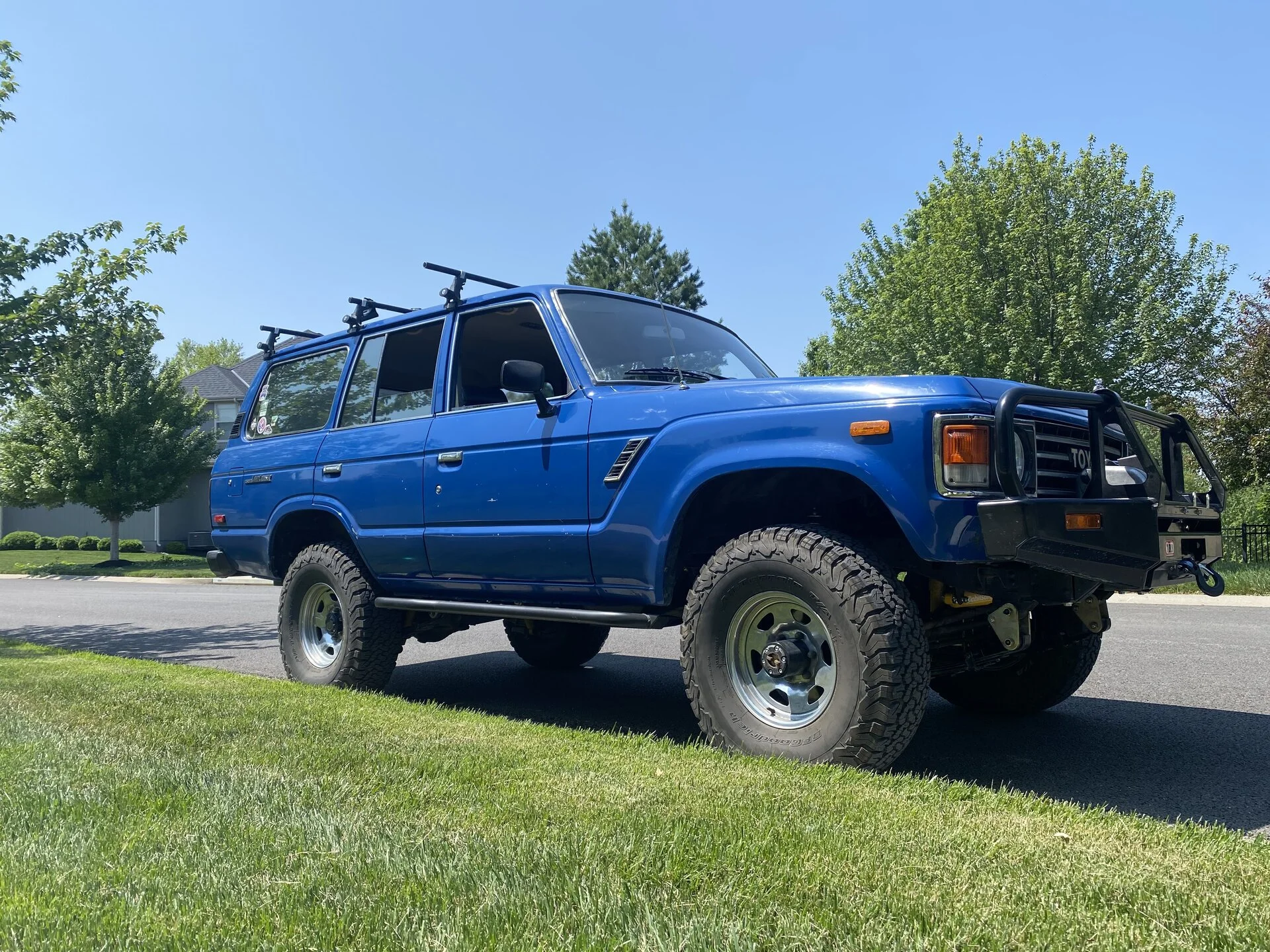

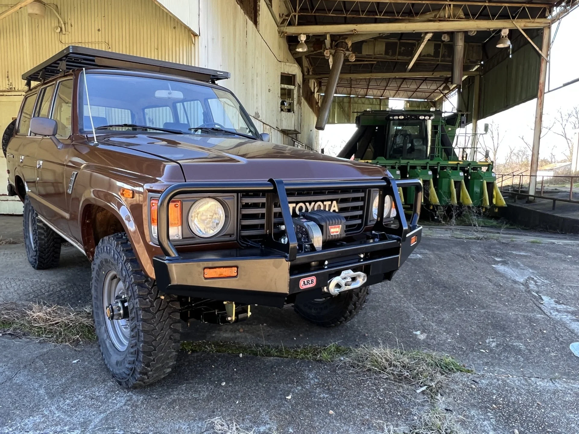

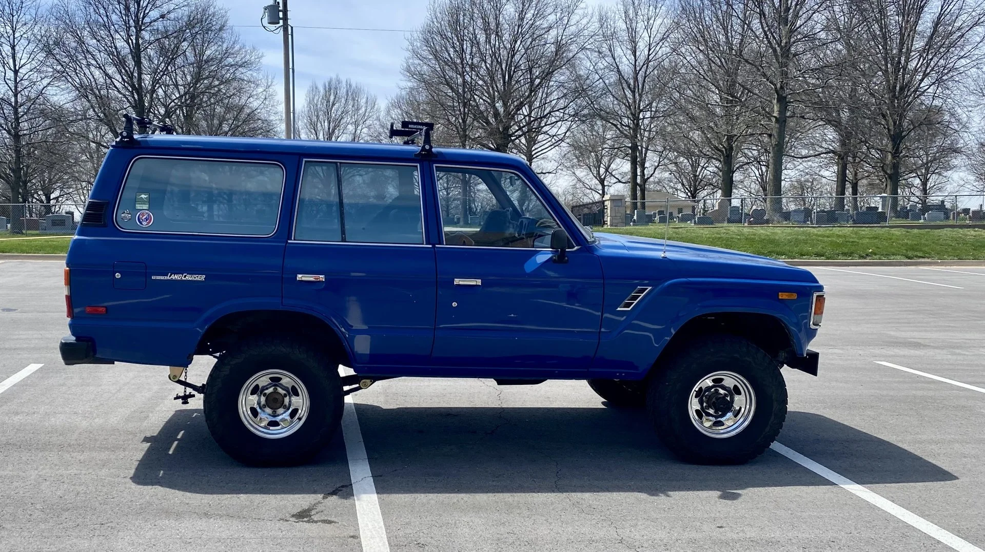

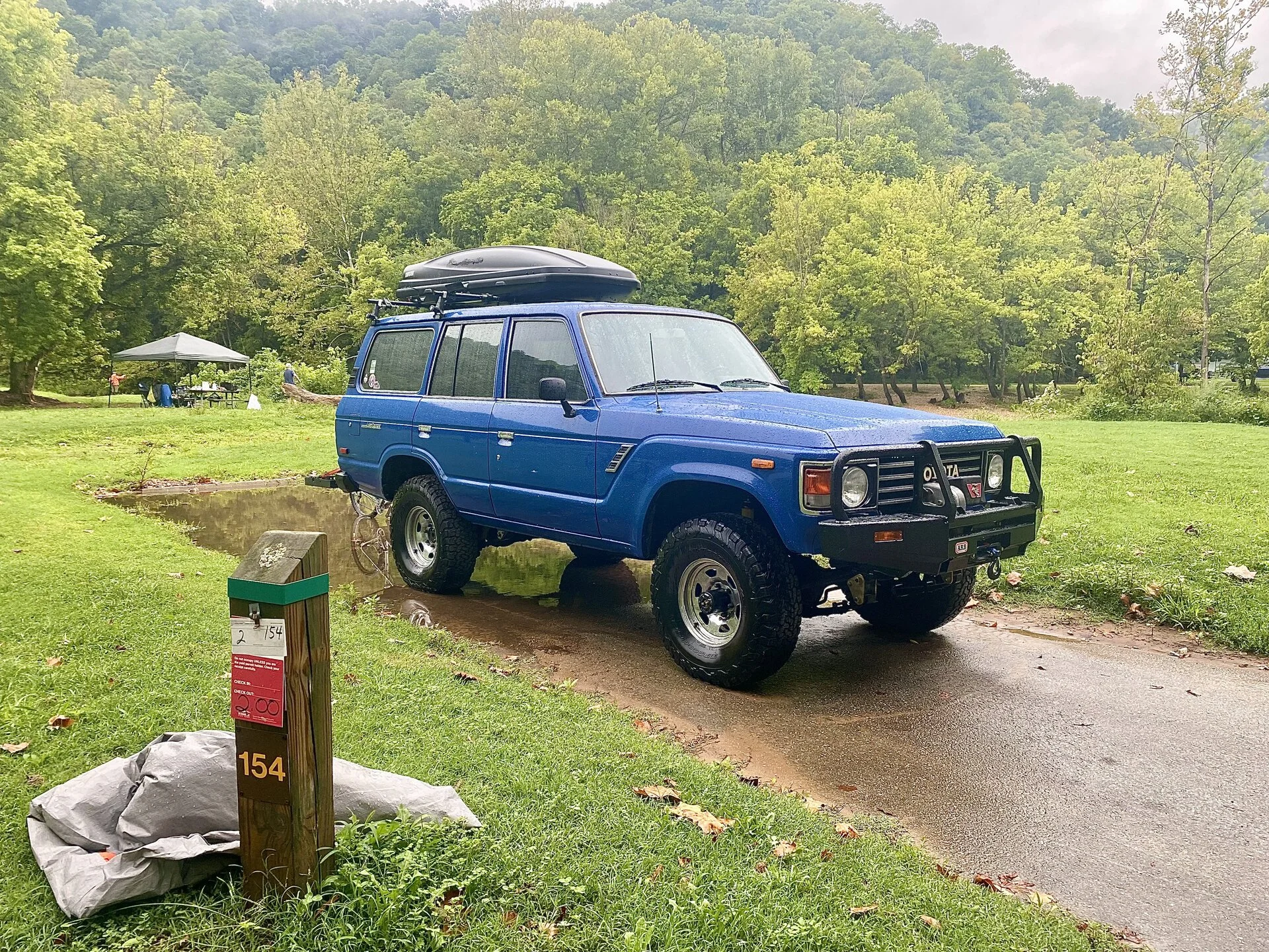

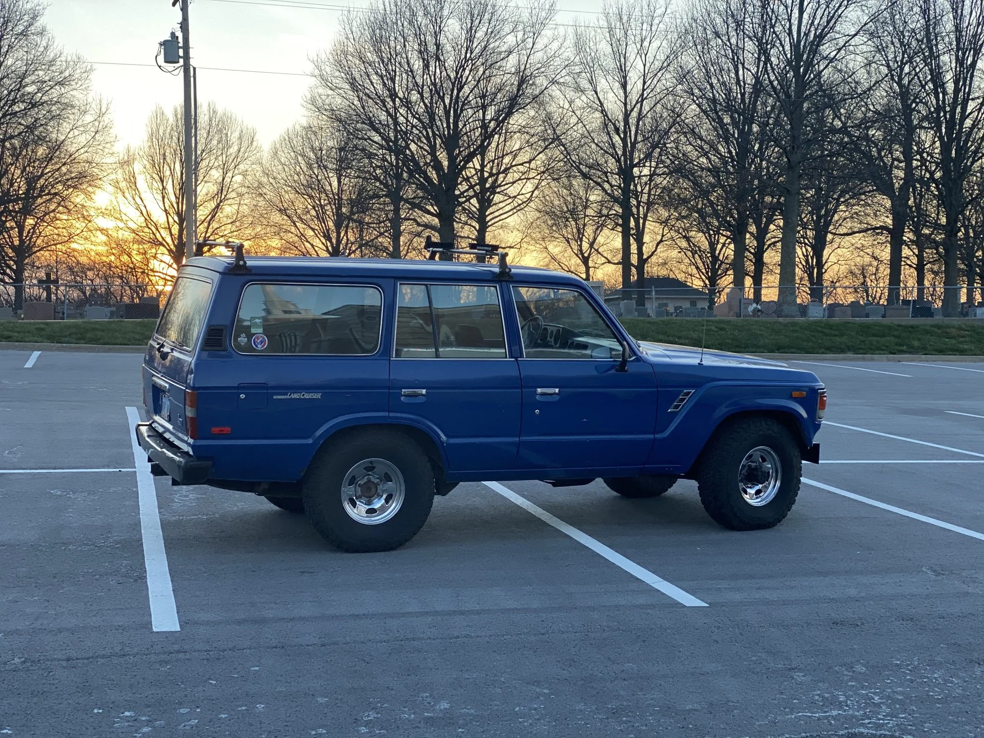

Not sure this helps but I posted this when I upgraded my suspension with a dobinsons kit (not IMS shocks):
Update: 1 year in and 3k mikes or so. Love the set up. Settled less that 1/4” even with sliders and front bumper/8274. Their entry level shock (yellow) is just ok. Eventually, will replace with stiffer option.
Thanks for sharing the photos. It's looking much more settled now, and a bit of dirt on it to help give it that proper land cruiser look too. haha
