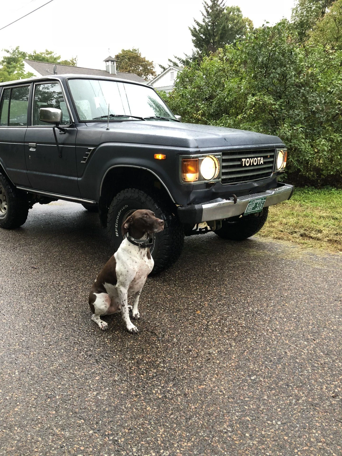

My first impressions are good. I was replacing the stock suspension system on a 1987 FJ60. I’m running BFG 33x10.5 tires on stock rims. The prior suspension was even, but the leafs had lost considerable arch and the vehicle looked a little tired. There was no cruiser lean at all. This is a medium kit, but it’s pretty even all the way around. I was worried about a stinkbug stance, meaning the rear is higher than the front, but none of that is really evident in the pictures below.

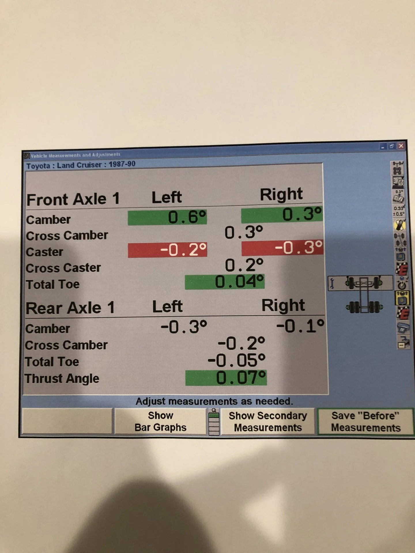

One distraction concerns the caster correction after alignment. I am -.2° on the left and -.3 on the right side, which is about half a degree under factory specifications. I do have positive turn response, and have had the vehicle up to 50 or 55 mph so far with no noticeable sway. I will say given that this kit was made for the FJ60 I’m a little irritated that set of 1° caster shims are not included. My local shops said to drive it for a few weeks and bring it back so they can look over the whole set up. There may be some settling, and I should know more by then. I’m going to keep an eye on this and will report back other problems should they arise.

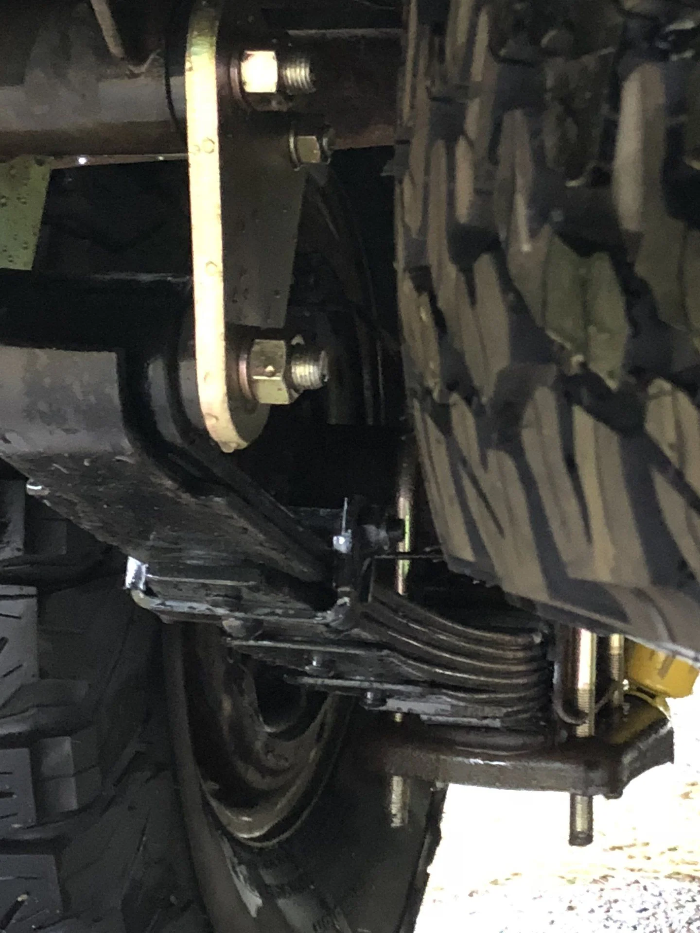

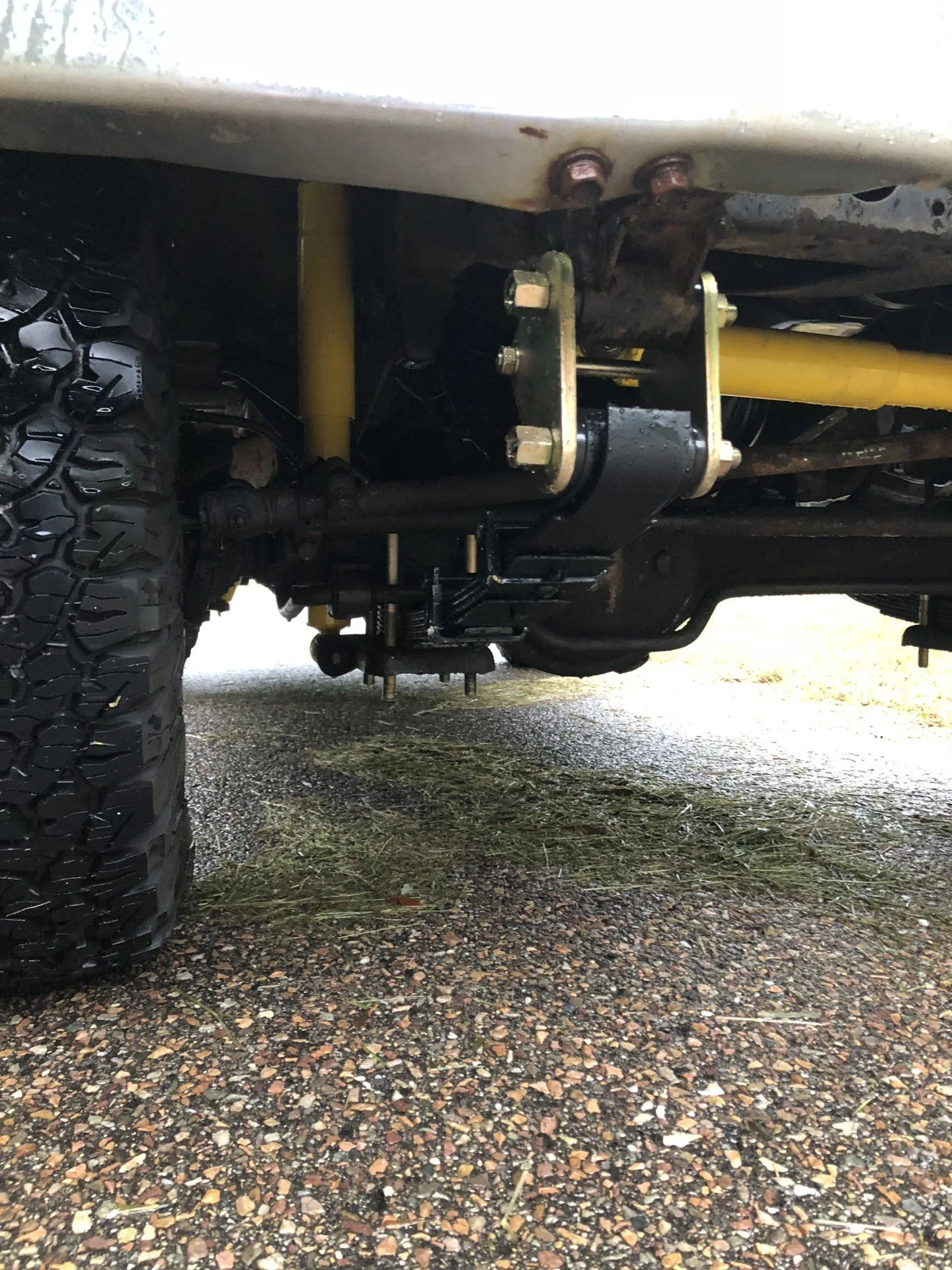

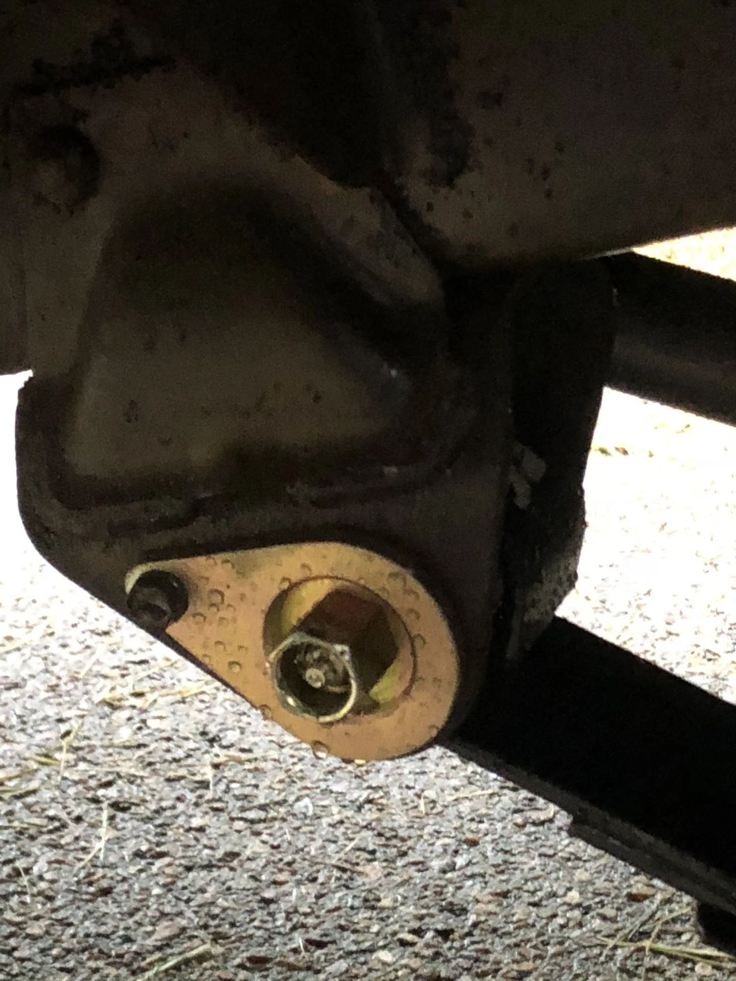

Attaching the original sales invoice with part numbers, pricing, before and after pictures with my German Shorthair Pointer as a reference, and a few close up shots.

I like the protected zerks!
They are nice, I have Ironman shackels (look exactly the same) on my 60 problem I suspect is they will pack with mud.
Yes this looks much more level than most of the OME setups I have seen. I am not a fan of the Stinkbug look at all so this kit looks like a nice alternative to OME. Looks great and thanks for sharing.
Like it. They (Dobinson) were very uncommon when I put my OME on couple years ago. Looks good. If you don't have wheel wobble at 50-55 you may not need to mess with the Caster.
Great color and look for the 60. You should post one of the pics in the 60s and Dogs thread.

Looking at your caster, I think she'd drive a lot better with some 3 degree shims in it...
