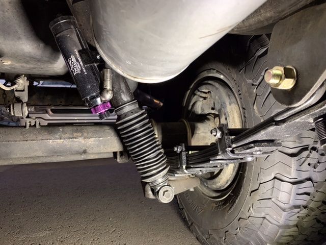

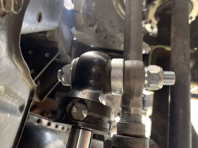

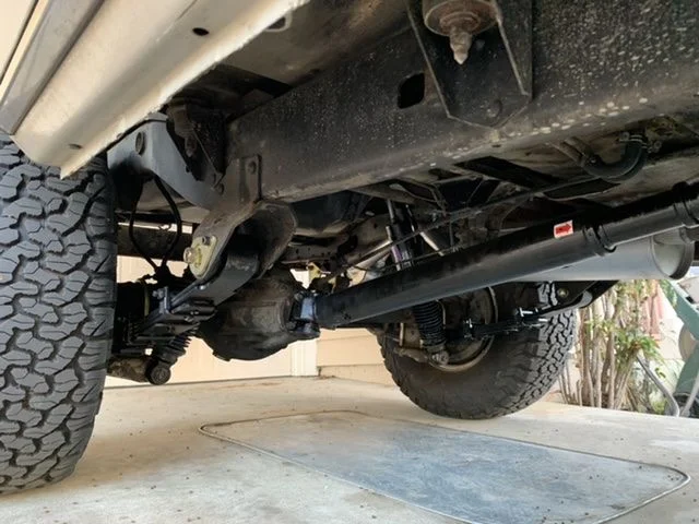

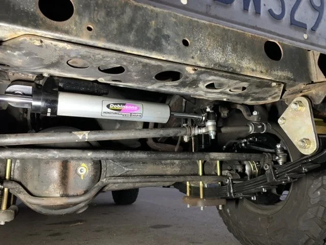

A few more pictures:

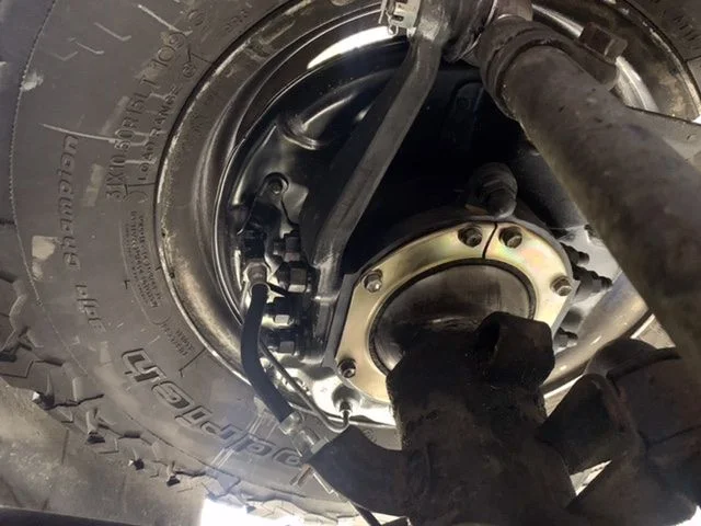

Knuckles looking much better!
Rebound Adjustment on the damper

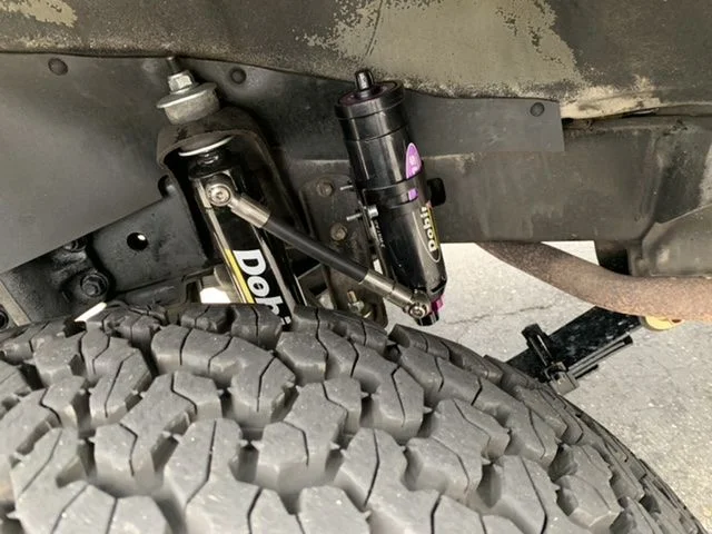

Rear shock with high & low compression adjustment on remote reservoir. The rebound adjustment is at the bottom of the shock

Relative to the ride prior it’s a huge improvement. I haven’t played with the adjustments much yet but I did take it on a couple long rides, so I have about 400 miles on the new setup. After 500 miles I’m going to take it to an alignment shop just to check on things, as recommended. I’ve got under it to look at things, soften up the settings and I tightened the lug nuts. Mostly on road but did go down a couple fire trails. For future reference, I have these settings:
3- High compression
6- Low compression
3- Rebound
8- Steering Damper
Highh has a range of 1-10
Low has a range of 1-20
Rebound has a range of 1-15
Steering damper has a range of 1-12
The ride is much smoother than before, steering a little heavier with much less road vibration. The ride prior wasn’t terrible but definitely not good. The springs were stock but the shocks were about 15 years old. The steering damper was stock and likely doing nothing. I hope that helps...
