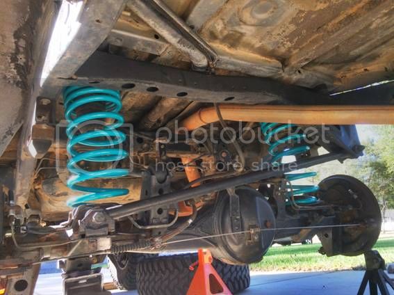

The installation went smoothly, nothing different from any other set of coils. I didn't have to use a coil compressor, but I did need help pushing the axle down to get the longer coils to sit properly. If done by only one person, a set of coil compressors would be handy.

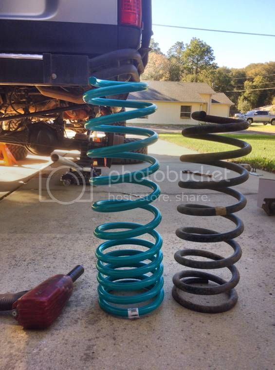

Dobinsons coil on the left and OME J spring on the right. Dobinsons free height is 570/580mm. Notice the progressive windings.

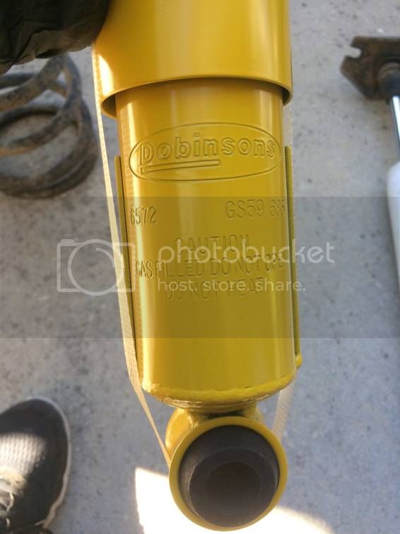

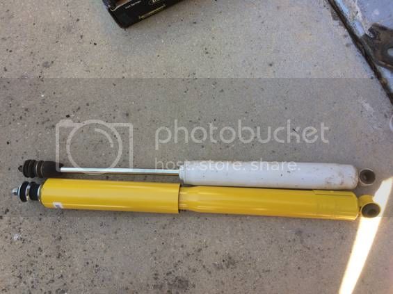

On the shocks, I went with the Dobinsons GS59-685 which are the 6" shocks to use the full potential of the coils. These shocks are 28.75" extended and 17" collapsed.

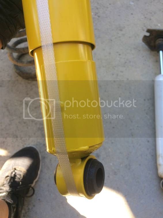

Below are both shocks at their full extended length. DT shock on the top, Dobinsons at the bottom.
One thing that made the shock particularly different to the standard AU shock is the built-in stone guard. I really liked that feature.
To run this shocks you will need a 3" bump stop extension so they don't get damage at compression. I was already using a 3" bump extension for the previous shocks, so that stayed the same. The extensions can be seen in the following picture with the coils installed.

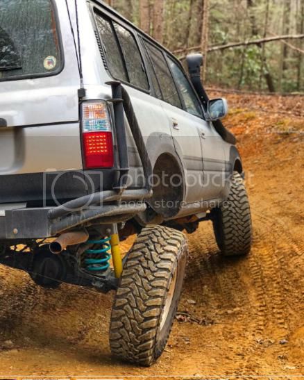

Currently, I have a little over 2000 miles on this set up and I'm very happy with it. The truck feels more stable/planted on the road. The ride is stiffer, but not harsh. Off-road performance with the progressive rate coil is great and I have no coils coming off from their bucket.
Ride height from the center of the hub to the top of the fender (no flares) is 24 3/8" on both sides. The added weight consist of custom rear bumper with tire carrier and integrated receiver, 315/75 R16 spare tire, and about 100 lbs of audio/recovery equipment.
How the truck currently sits
Testing it out

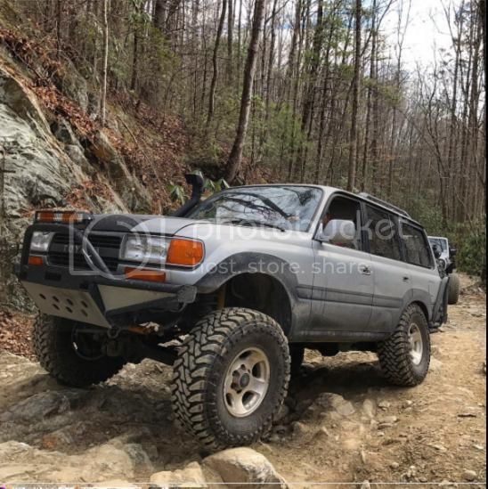

No sway bars? Advertised spring rates? Where did you find such terrain in Florida??? Nice looking rig btw.

Also, to me, these do not look like what is normally considered a "progressive coil" they look like dual rate. The spring wind appears to be only two different rates. The top rate which is closer together and obviously softer, and the bottom rate which has a different yet equidistant spacing for a firmer rate. I could be wrong, but I will know more on the subject soon !

Thanks, I'm not running a rear sway bar and this was in Ocala, FL and North Carolina. I don't know the exact spring rate of the coils
