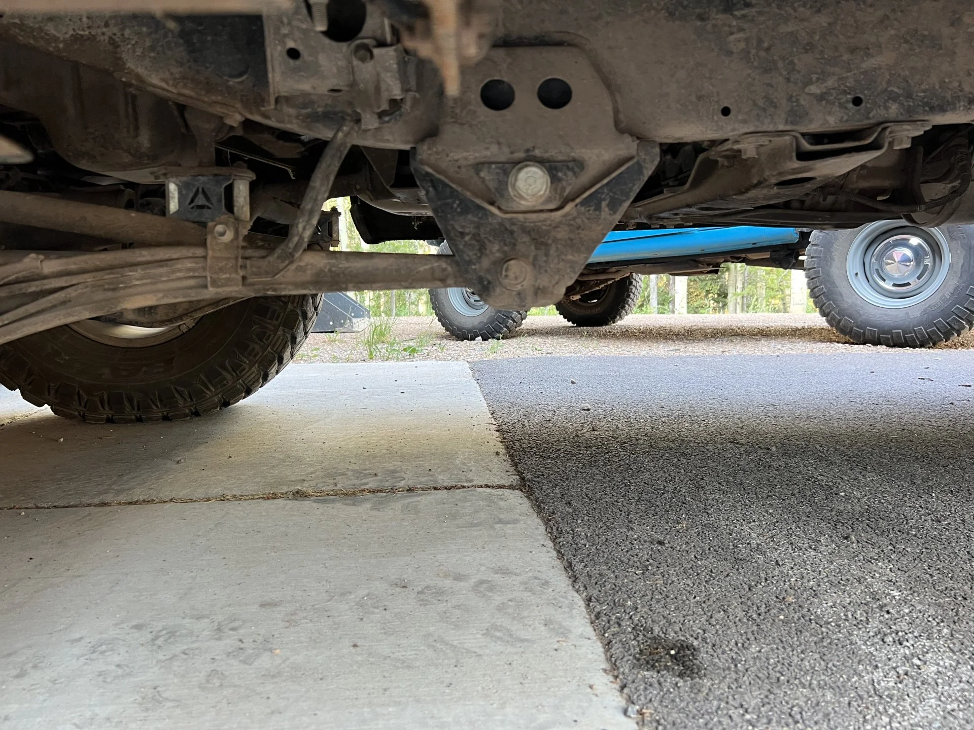

Any pics of the Ironman drop brackets installed @residualboulders ? I looked at those as well - not great from a loss of clearance perspective, but likely effective on the caster correction solution. Have not seen many of these in the wild just yet.

@Trusty Rusty here you go. I actually ordered man-a-fre drop brackets first, but sent them back. I liked how the ironman bracket not only dropped, but pushed the arm forward to correct the geometry. From what I understand that is what Delta replacement arms are also doing. I was planning to order the Delta Radius arms. But, it seemed to me the only draw back on the drop brackets was the clearnace loss. I think that is only an issue for certain people. I offroad mine a lot, but the most technical trails around here don't include many huge boulders. I haven't drug them yet and I suspect when I do I'll figure out a way around the obstacle. But, I'm not the type to beat up a rig on the rocks. The ironman brackets are pretty stout though so I would think they would hold up really well if you did make contact.

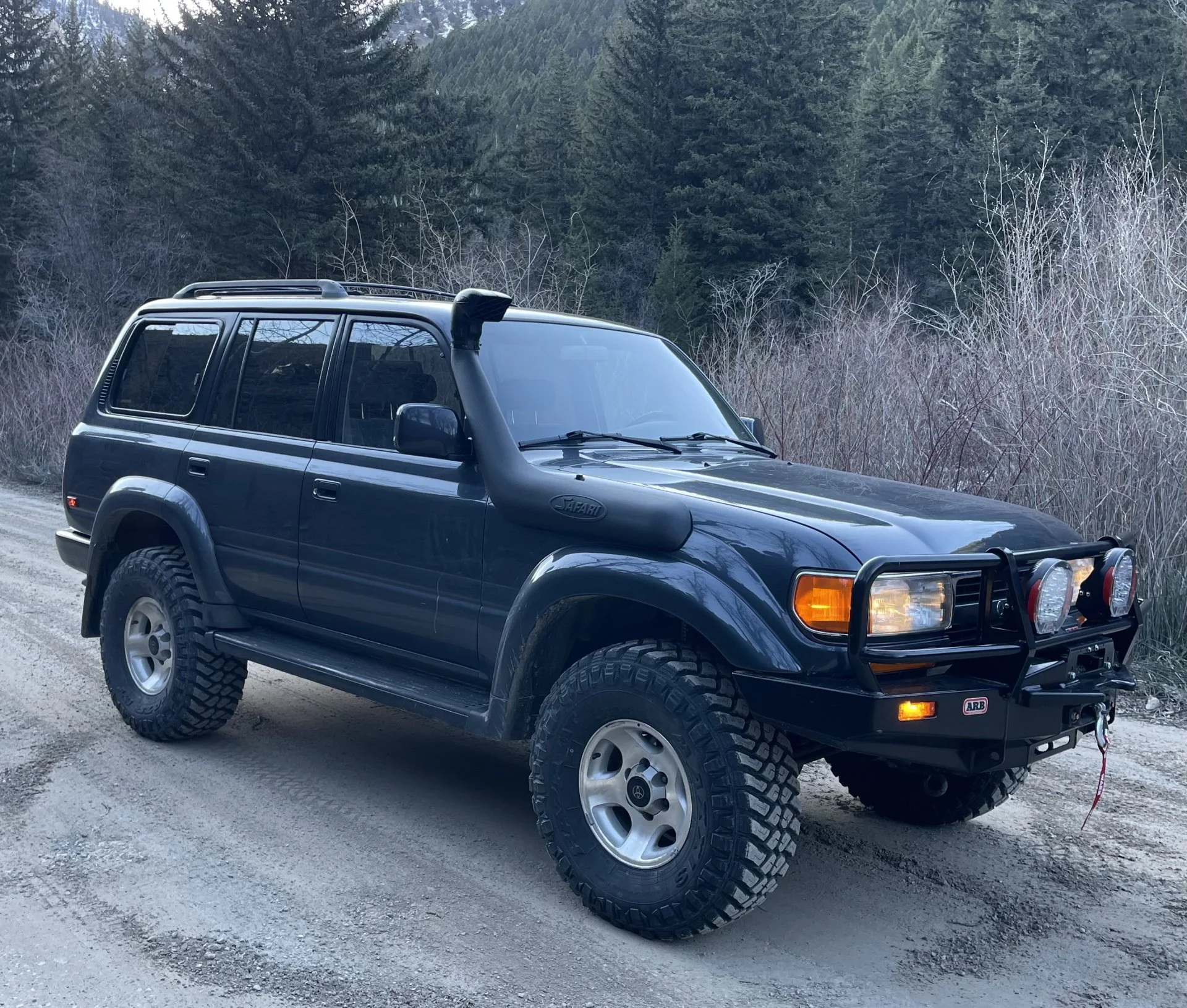

@Heckraiser so far I really like the suspension. I went from completely stock to 35" tires and about 4" of lift so it feels quite a bit different to drive. Suspension feels great and I would say similar to stock in comfort. Some power loss from the large tires though. I wondered if the custom Delta radius arms would be better, but with the drop brackets and the delta panhard drop the handling feels pretty well like stock. I would love to drive mine back to back with a stock 80 to compare just out of curiosity.
Soon after the install i met up with a friend that has a 1995 80 with OME medium suspension also with 35s. We drove both back to back. Mine is much smoother and plush of a ride, but it doesn't feel too soft. His was a bit jarring, which made me feel a little better about the significant price difference between the basic OME kit and what I got. But I still try not to think about the cost. I set my shocks at Dobinsons recommended settings and have not changed them yet because it just rides great. I suspect I may change them once I finally decide on a rear bumper and add more weight to the back. Overall I would do this suspension set up again. I am curious how the BP51 would be on an 80. That's what I have on my 200 and I've been very happy with it - but its also 25 years newer than the 80.

Yeah if I'm ever in your part of the country in my 80 we'll have to take them for a spin. I'm not surprised to hear your experience with the BP51. I love it on my 200. I was going to do it on the 80, but thought I might try the Dobinson's just because Id heard good things. I was planning on 2.5 lift, ended up with more.
I don't not like the higher lift, but I do need to replace my driveshaft. There is some vibraton. It's not terrible, but I noticed it immediately after the lift install.
Thanks for the pic @residualboulders ! I'm kind of in the same camp - no extreme rock crawling, and the drops seem like a very solid option for the caster correction assuming you can live with the aesthetics (my OCD says NO!) and reduced clearance.

I was concerned about the asthetics as well, but I found I really only care when I'm under the 80, lol. With my stock running boards still on there you really don't notice them unless your down at their level.
