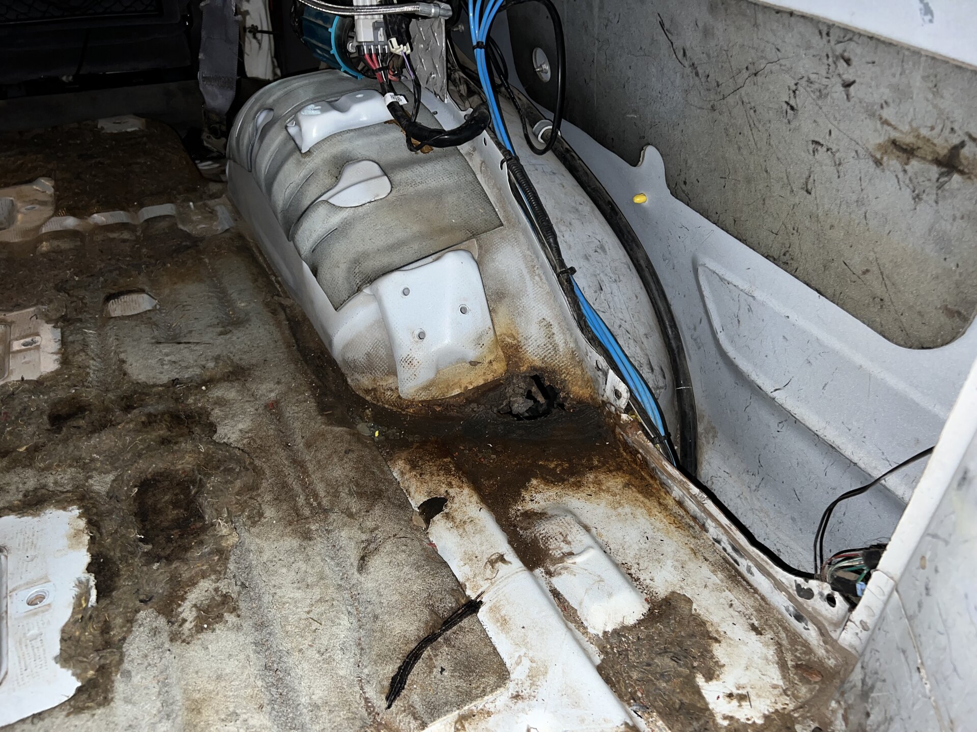

Bought this "rust free, we don't salt roads in Colorado" 80. Didn't consider looking under the carpets, since it seemed really rust free compared to "out east" corrosion levels.
Sadly it had several through body holes, front of both rear fenders and rear of another.
Make sure you do your homework.
Thank goodness I can weld.

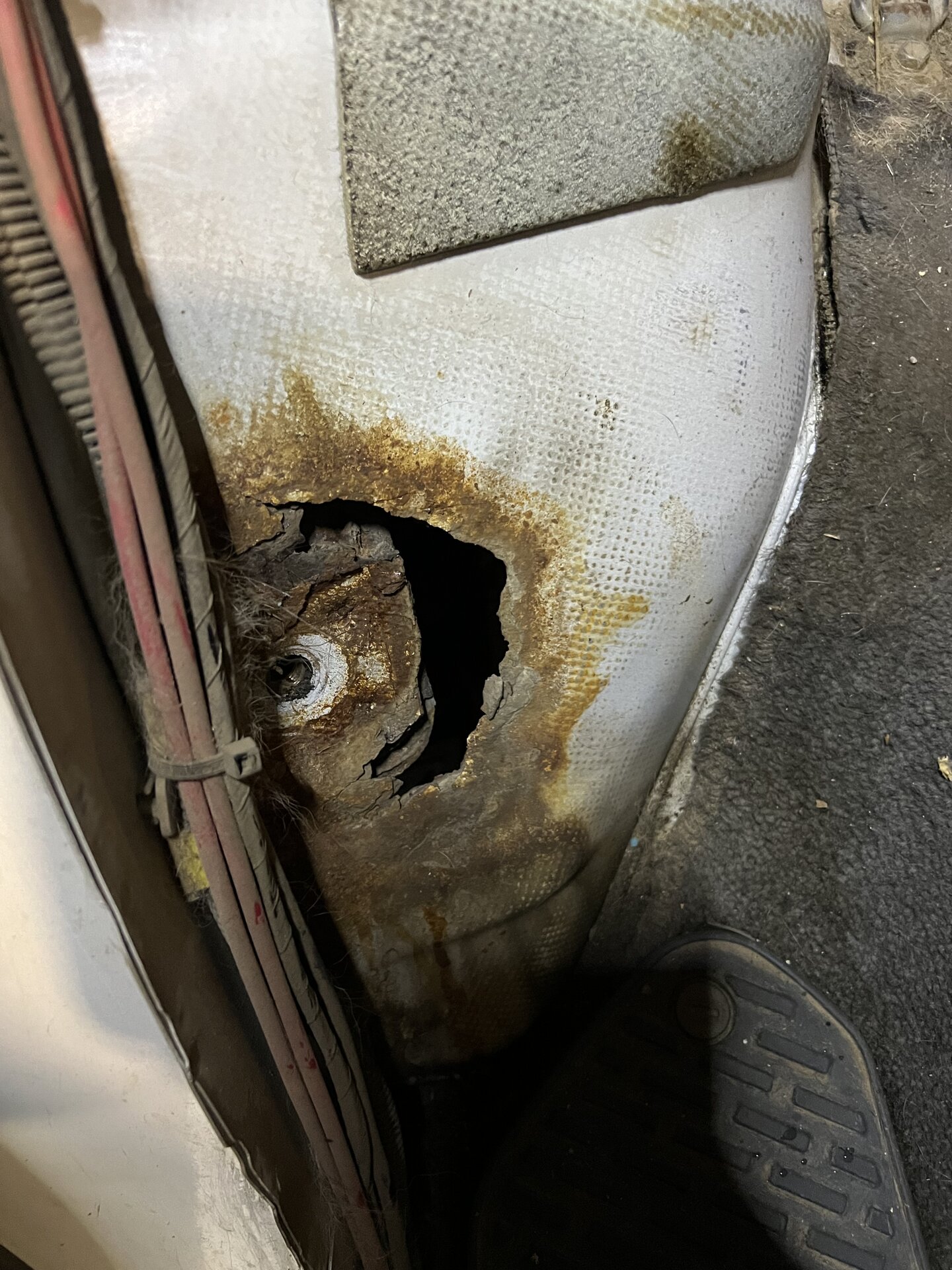

This (both sides where the second row seatbelts mounted) was rusted through from the outside. Seems as though the backing plates trapped something corrosive and eventually rust won.

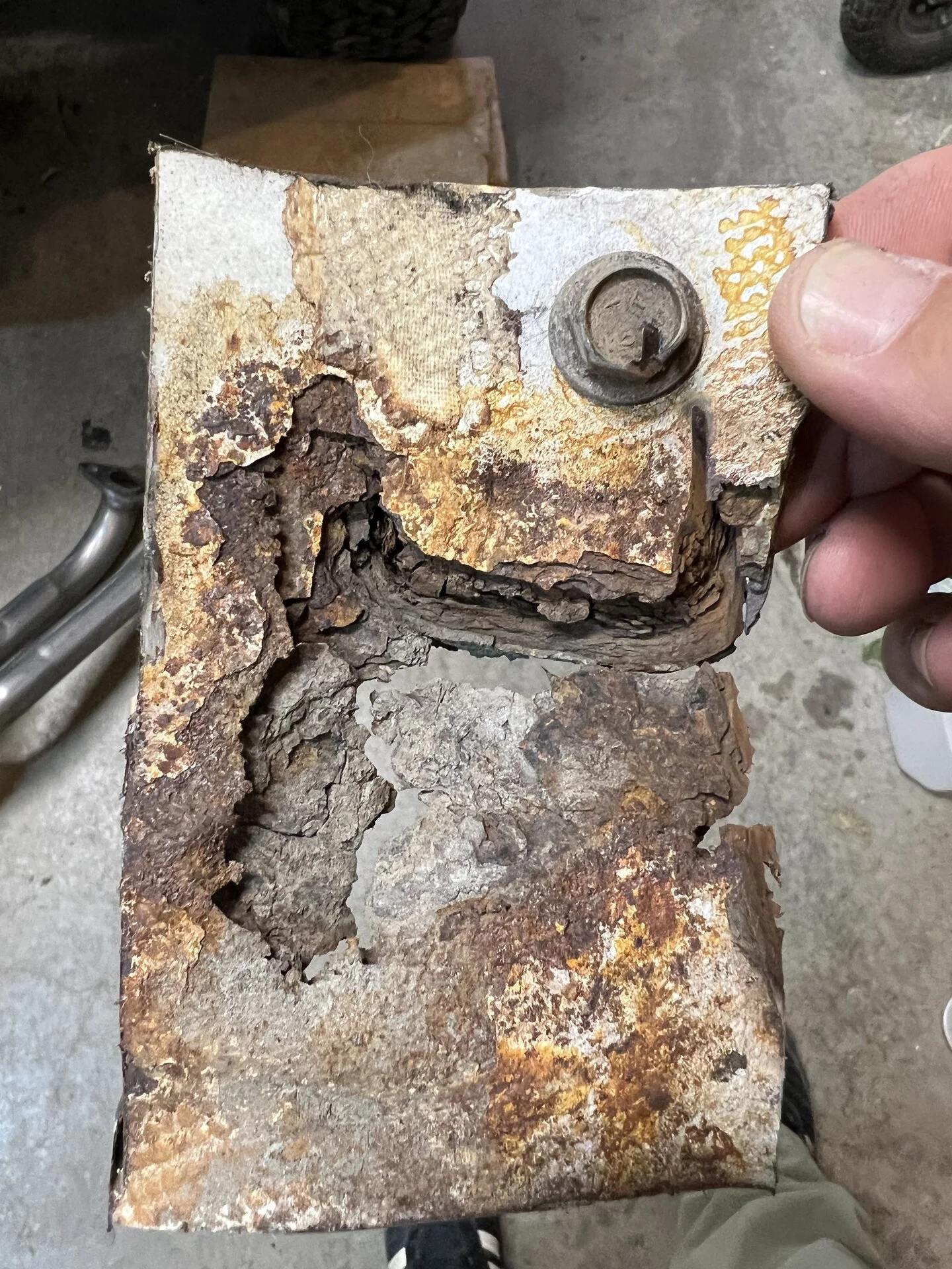

Common issue.
