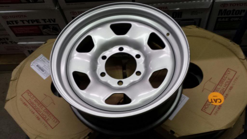

Sooooo I guess I will choose from either the Toyota rims Onur posted (42601-60262-03 ) or the cheap steel Soft 8's that all seem to be made in one giant factory overseas.
I purchased a set of 5 Toyota rims from Onur for my 70. They are so good that I purchased another set from him for my other 70. If I could have gotten PO authorization from my bride, I would have bought additional sets for my 40s.
No. 15”s for the US market.
These are available in 16” but most people don’t want to pay for custom wheels.
I'm in the market for rims to replace my HUGE backspaced aftermarket JDM rims. I am planning on keeping the skinny 255 or 235 85s and leaning towards the ones from cityracer (steel and the ability to run the old center caps). Anyone out there have experience with these Dean wheels from Japan? Maybe imported one with them already mounted up?
Love this setup. Are these 255/85/16 tires with the 16” x 7” Toyota wheels Onur posted below (42601-60262-03)?
To be clear, the OEM Toyota wheels referenced are 6" bead to bead (7" overall width), and would normally be referred to as a 16 x 6 wheel. But, yes, 255/85-16 fit on them very well and they're fantastic wheels for a 70 series.
Great info. Thank you. Do you need to run a lift for 255 tires? Or will they fit on stock suspension?
Just put these on my rig, love them. No spacers needed! But I think I got the last set from Summit.
Does anyone ever run these Toyota 16" x 6" wheels with 315/75/16 tires?
(Toyota PN: 42601-60262-03)
The recommended wheel width for 315 tires is 7.5" to 11". Obviously the Toyota wheels are narrower than this. But people run 33" x 10.5" x 15" tires on FJ40 wheels all the time (15" x 5.5").

The wheels are awesome. I had them on my troopy. But a 315 is what, like 12.5" wide? I wouldn’t run them on a 6” rim. Not sure if a tire shop would mount them for you, but you can always ask. If you want 33’s, and those wheels, look at 255/85-16. Even that’s a little wide, but it works.

I wouldn't mount 315s on those wheels for a customer if I ran a tire shop myself but it can be done. It would look weird to me too.
