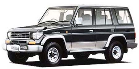

Japanese Prados had OEM 16x 6 alloys. Zero offset. Direct fit on a 6-lug 70 series.

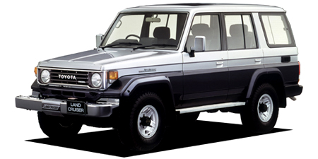

JDM HZJ77's came with those same alloy wheels, as did the very early HDJ81 from Japan if I remember right.
The 15x7" alloys came on both JDM light duty and heavy duty cruisers too a couple years later.

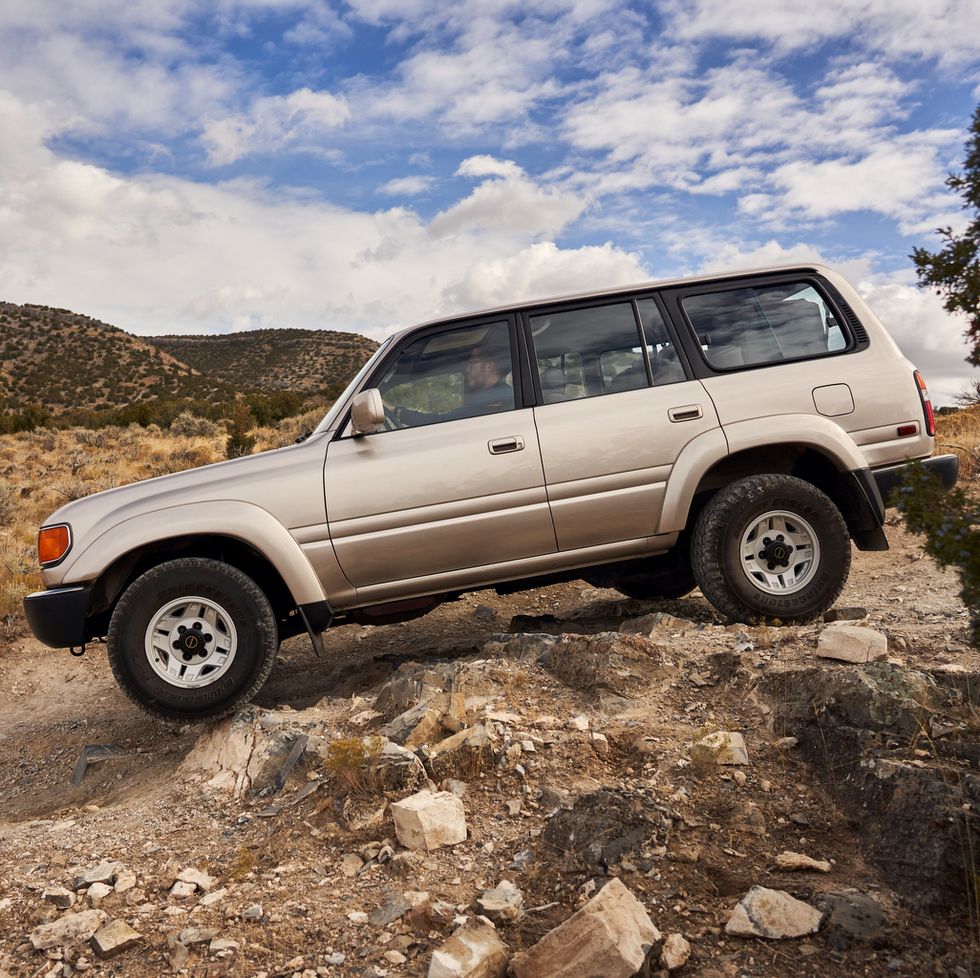

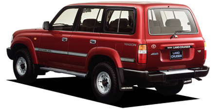

Same as 1991-1992 FJ80s for the USDM.
The 1991 - 1992 USDM FJ80 wheels are 15” x 7” with 3.5” backspacing?
I thought USDM 15” x 7” alloys that came on USDM 91/92 FJ80s, 4Runners, and early Pickups were all 4.5” backspacing.
And the JDM Cruisers were 3.5” backspacing?

While cosmetically similar, the JDM Prado wheels and the US 80 wheels are not the same.

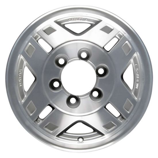

The 70-series (Prado) alloy wheels I referenced above are a 16 x 6" wheel with zero offset, thus 3.5" backspacing. Direct fit on a 6-lug 70-series, no spacer required. Work great with 235/85-16 tires, but can also work with 255/85-16 if you want to run 33". Nowhere near wide enough for a 315.
The early US market 80-series alloy wheels are a 15 x 7" wheel with 8mm positive offset, thus (about) 4 5/16" backspacing. You'd probably need spacers to run them on a 70-series, and you'd be limited to 15" tire sizes.
I'd assume the 4-Runner alloys of the same period are the same as the US 80-series wheels, but I've never had any so can't say for sure.
The wheel being discussed is pretty much 15X7, -20 on the heavy duty 70 series. That puts you around 3.2" BS.
I don't think 70 series Prado offset is -20 but is 15, then of course it is 16X6 which gets you closer to 4" BS. Too many variants of that wheel design out there to be sure!!

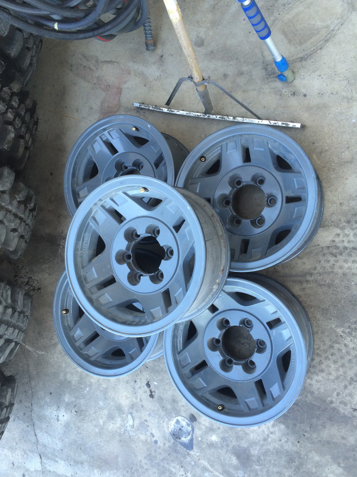

I actually have a factory 1990 lj78 16x6 set and can confirm they're 0mm offset.
