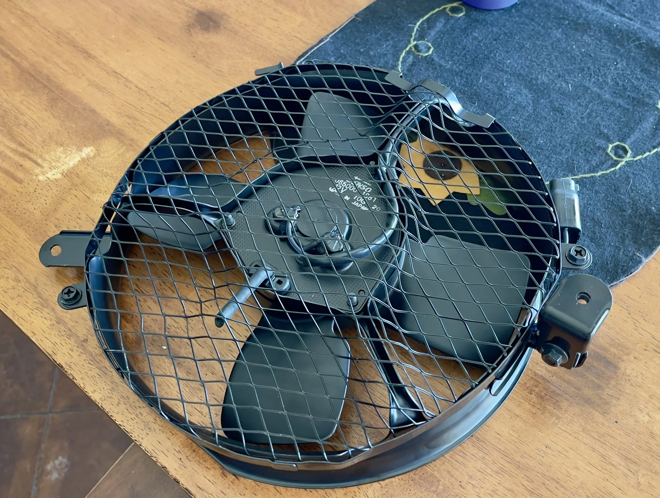

I live in Texas, and my cooling system is impeccably clean. I keep it that way. I agree with everyone who posted about the fan clutch above. It's critical, as is the shroud and the foam around it. When I am at idle, my AC drifts up a few degrees in the sweltering dog days of summer. I rigged up a pusher fan a few summers ago to test the improvements gained with a fan, and it did indeed prevent this from happening. So, bottom line, is it needed? Probably not, but does it make a difference? Yeah, it definitely does. Toyota includes the mounting points for a reason.
*not my photo
If you're ambitious, you can even tie into the factory switches to turn it on and off automatically.
A few vendors on here will sell you a complete kit to make it all easy. They tend to go in and out of stock pretty regularly. The Dr. T OEM fan is available from Amayama, PartSouq, and sometimes US vendors (at a HUGE markup, though); it's 200-ish from the overseas guys, 400 and up from the US places.

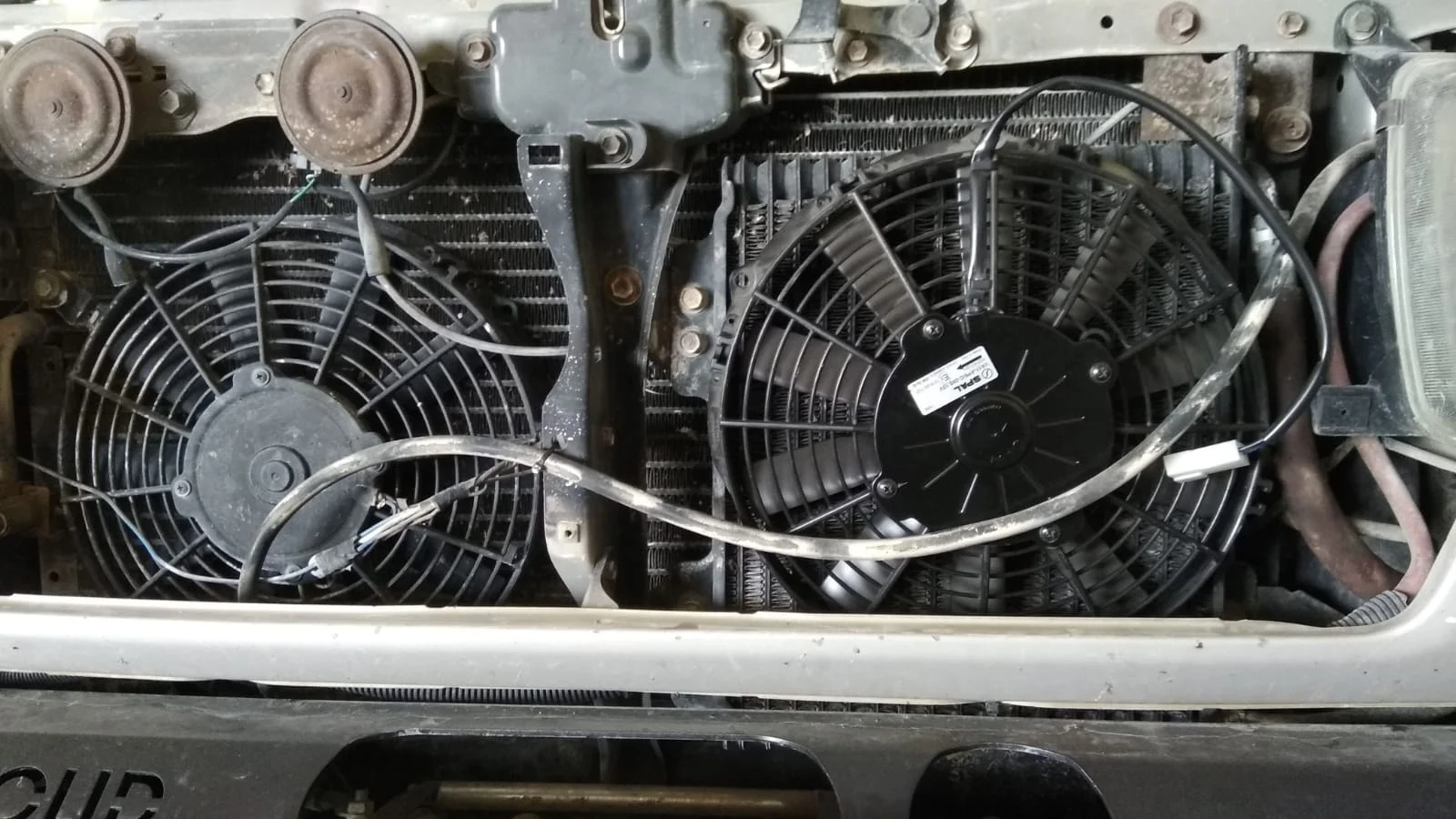

I have a retrofit AC in my J4 and I added 2 fans in front of the condenser. Initial plan was, to get rid of the fixed fan, which didn't work out (performance not good enough).
But it helps the AC to cool down a bit more. I did some measurements with fans on/off and the difference (vehicle in the garage) was a couple of degrees, like 3-5 or so.
