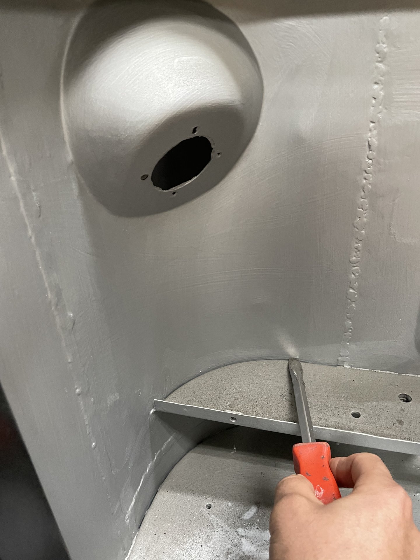

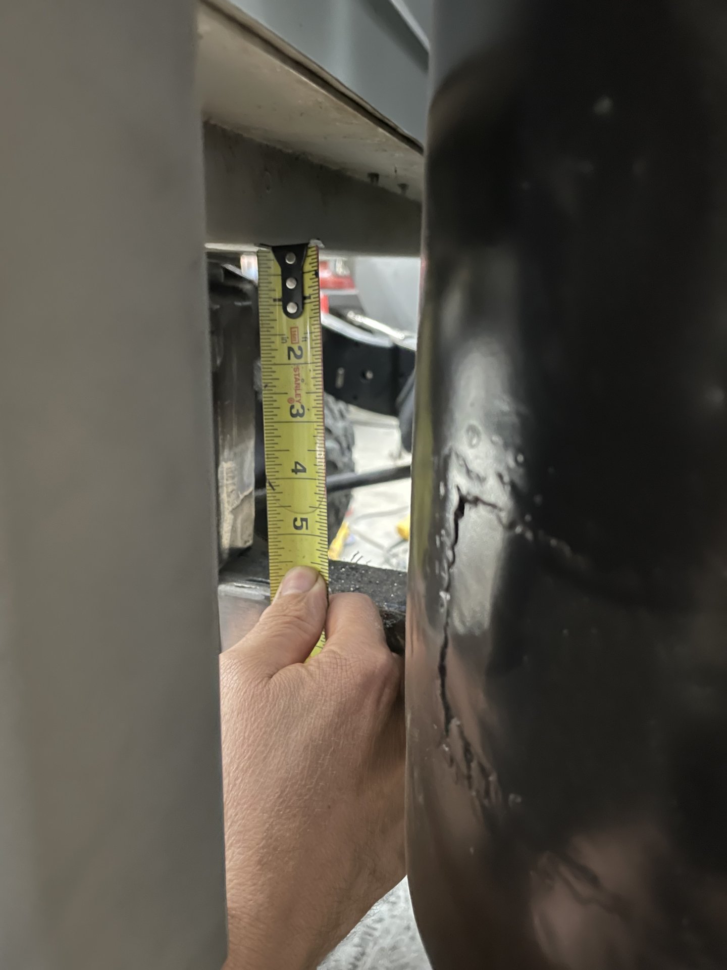

UPDATE.. looks like I could use original location, go down inside the cab and then turn about where the reiforcement section is and that is that would put me out right about the bottom of the bed. Will try to get a picture.

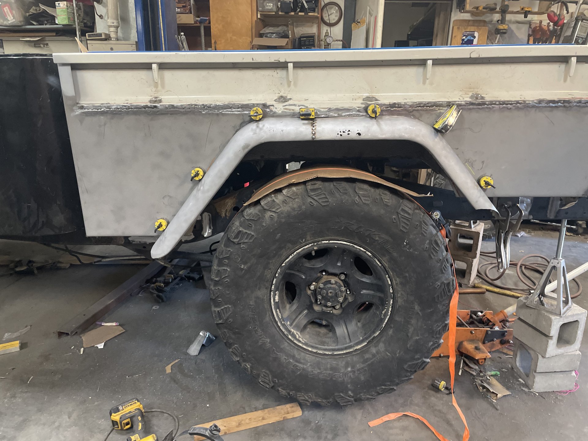

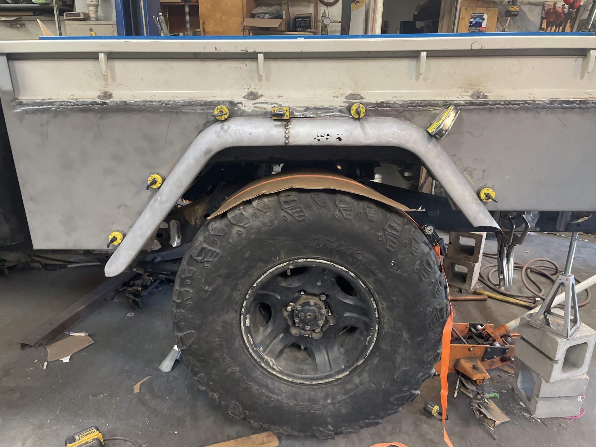

Left foot, right foot, just keep going…. Cut the flares a little wider than I want for test fit, will probably cut them back another inch. From the heavens above, Chef keeps helping many projects along…. Those flares came off of his Fj40. @Sherpa @tornadoalleycruiser @orangefj45
So glad his / now my FJ40 has the ability to be recycled..
Looks like it’s about 6 inches difference in height. So I would want the top of the pipe exiting the cab to be where my screwdriver is

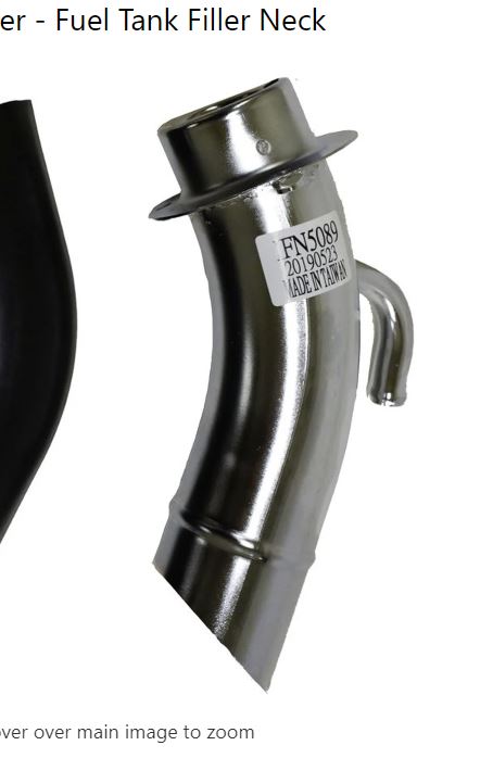

Ok, I need your help with how to make this.... I am thinking that I want a neck to go down from the OEM location, then another neck that turns 90 degrees out the back of the cab. I assume that should be made from some sort of metal... copper or brass or the like with a flange to mount to the cab -- also need vent pipe as well.
Then have a flex line connecting the stock pipe to this section.

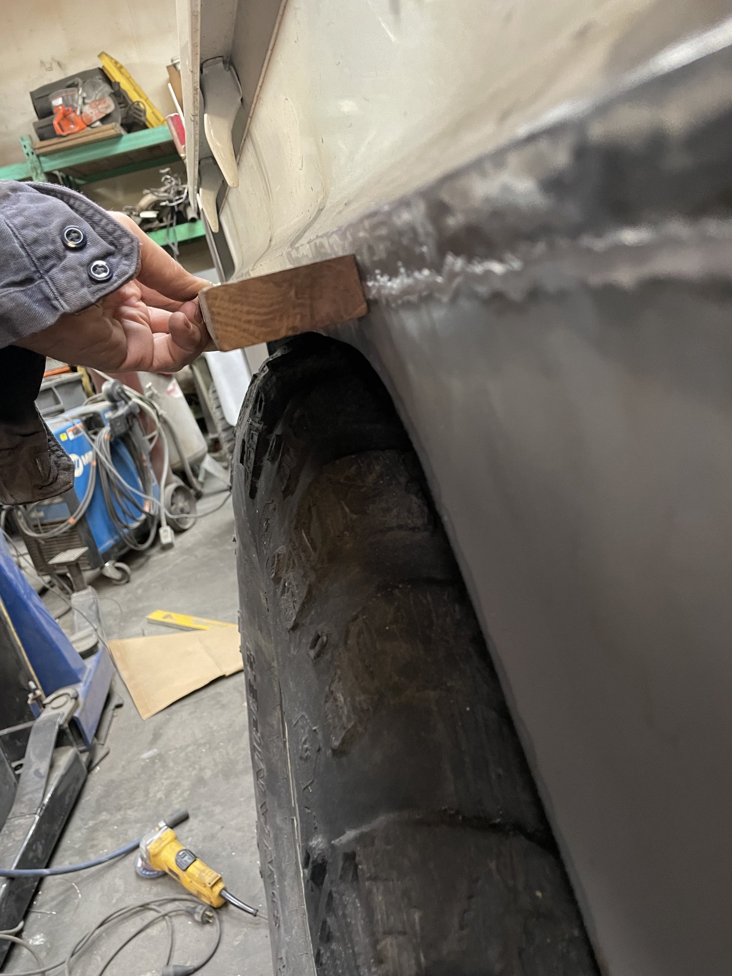

The nice thing about this bed is that the wheel wells are a little over an inch inside of the frame, so where our 80's typically rub is on the tub above the frame, and that is now not an issue, so I think I can keep with the same wheel backspacing. Of course not a common backspacing, so this may be fun search.

My current plan is to use mild steel pipe, route it as you say as my primary tank is just behind and at the same height as the rear of the cab. I will figure out the routing, weld it all myself, then have the final product cad plated like the original lexus filling pipe was on my my secondary tank. Flex rubber lines will connect the stock filler to the new pipe and then from there to the tank.
That's just my current plan and thinking. It might change, but only if I can find a length of fuel rated rubber hose with 2 90° bends in it.

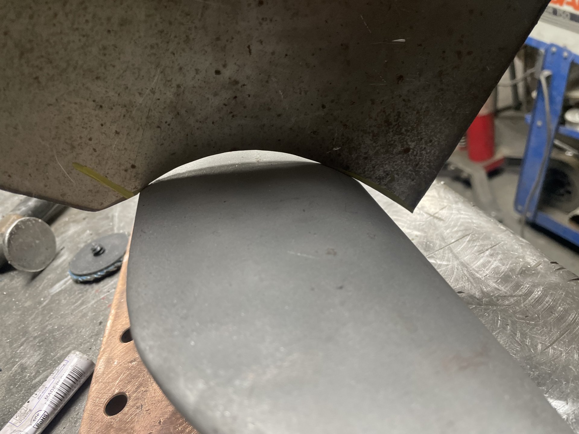

After kind of flares off Sandblast at the back of them again to get in all the nooks and crannies and as all these fenders were used did a lot of straightening. Make templates from the good ones and then beat them all into submission. In case anyone ever does this, to get the length of them all the same with the curved plane used my templates with a scribing point to get the exact dimensions
As Julia Child would say … And wallahhhhh….we have the chicken

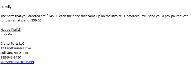

Tried to order stuff from CruiserParts for the first time.... this is what I found in my email almost two weeks later....
I'd say ship the parts back to them on their dime and they can keep them.
It's not your fault they can't get an invoice right if that was the advertised or agreed upon price.
