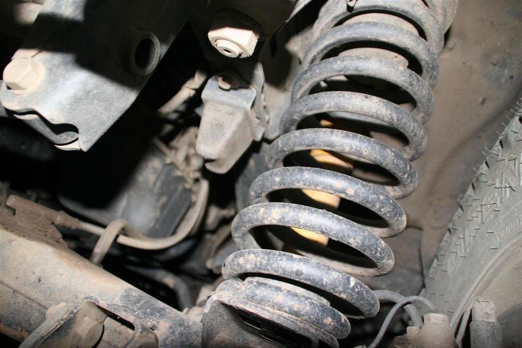

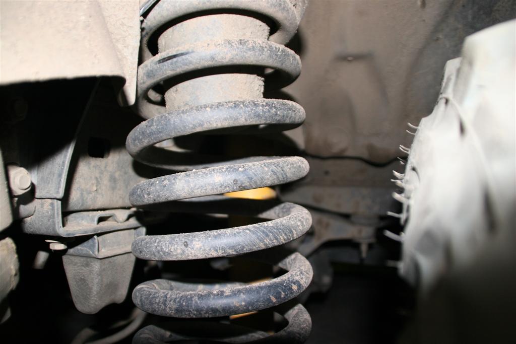

so after 10 days in the gran chaco and the altiplano i'm back to an internet connection. here are some pics of the bumpstops. they are fj80 stops that bolt directly into the fzj80 frame.
not the best pics in the world but you can see where i added the old style bump stump and removed the stop inside the spring. they work just fine with the 33s but the 35s still rub with the new bumpstops (i found this out after jumping my truck last fall with 35s and touching all 4 in the wheel wells)
