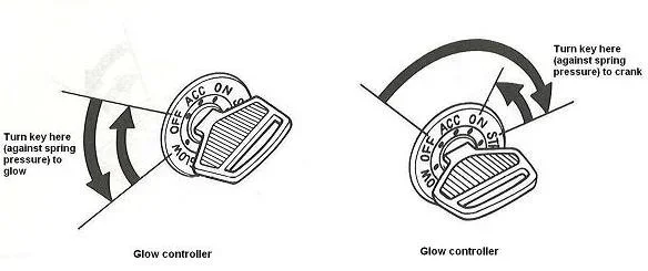

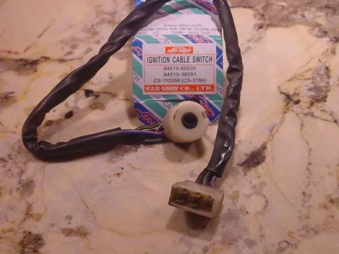

Can you show a photo or two?
Can you turn your key backwards (anticlockwise) to the "glow" position? If not, I think you have a petrol version (or perhaps ... less likely... a different diesel version .. perhaps for superglow or something like that).
I think this is what you should have there:
A quick look at the EPC gives me some confusion ... but it looks to me like 84510-60030 SWITCH ASSY,STARTER is what you should have there (on a 1981 BJ42) and it is apparently to be found on BJ4# and HJ4# models up to Aug 80. (Both 12V and 24V models).
I think the starter switch on any BJ4# or HJ4# that has the above key-face will work ... but earlier models may have part number 84510-60010 (and I wouldn't look at anything older than 1976).
PS. The EPC data is clearly incomplete/incorrect because I have to look outside your "1981 build year" to get these numbers. (I suspect the EPC thinks you should have a "superglow" starter but I know that's wrong.)
:beer:
Hi Dallas,
A few weeks ago I replaced the key switch on my BJ40 manual glow. This is the switch you are looking for. like Tom said the number is 84510-60030.
It's aftermarket but the quality is pretty good. And cheap! I paid $11 for it.
I think you can use the existing key because the positions are made by the switch. You are only missing the "glow" inscription.
Hope this helps,
Rudi

A quick look at the EPC gives me some confusion ... but it looks to me like 84510-60030 SWITCH ASSY,STARTER is what you should have there (on a 1981 BJ42) and it is apparently to be found on BJ4# and HJ4# models up to Aug 80. (Both 12V and 24V models)....
Rudi's post below (and photo) confirms that my statement above overlooks the fact that the "switch assembly" doesn't include the key, key barrel, and the surround (with GLOW-OFF-ACC-ON-START etc embossed into it),
Still I don't think it matters that much because it is the "models and years" that are really important to you.
In other words, as far as I can work out, your donor vehicle (for a complete "ignition switch assembly") can be 12V or 24V. And it can be a BJ40, BJ41, BJ42, BJ43, BJ44, BJ45, BJ46, HJ45, or HJ47. The epc suggests it should be made before August 1980 but we know from your 1981 BJ42 that some 1981 models have what's needed too. (Just make sure the key has the "anticlockwise-to-glow feature.)
Definately have a petrol version - I don't have a glow position.
I agree. (Damned PO!!!!)
....Also - there is a wire nest of bullet style connectors back there with a bunch of blue and yellow wires. ...
I'd say a professional may have fitted the petrol ignition then. Most POs would have just twisted the wires together. :lol:
......I think you can use the existing key because the positions are made by the switch. You are only missing the "glow" inscription. ...Rudi
I never thought of that possibility Rudi. For some reason I imagined the "spring-return features" were part of the key barrel ... but I think you could well be right!
(My memories of taking mine apart are vague ... but now that you mention it, I think I do recall the spring features being with the switch assembly.)
Still .... for "OEM look" Dallas will need the whole lot eventually. (But it looks like just one of those cheap switch assemblies may be enough to get him going.)
:beer:

Hi Dallas,
Hope this helps,
Rudi

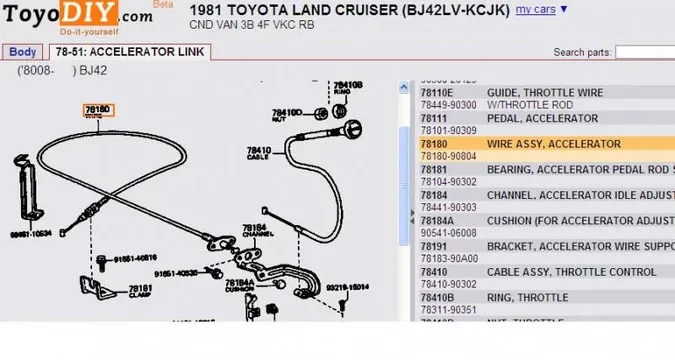

1. Is this indeed the correct accelerator cable?
Accelerator Cable Toyota Landcruiser 40 Series - BJ42 | eBay

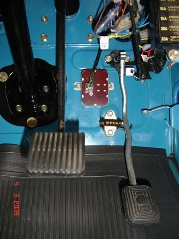

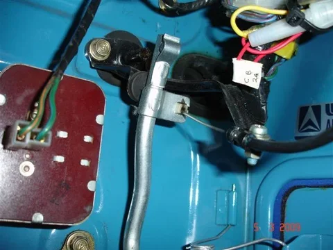

That link to the eBay item is too slow for me Dallas. But here's some pics of my RHD-version of the Hand Throttle that may help to show you what you should have there:
