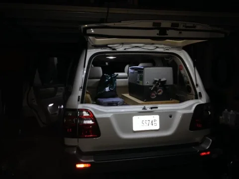

Tonight I installed a set of PFran LED's. They are such a wicked improvement it's crazy.
I won't go into the details that others have shared, but rather some insights:
- Nirtle gloves do not provide protection against blowing fuses. I'd suggest removing before install (located in passenger kick panel)
- don't button up the covers until you check that they work. I had two map lights reversed polarity, and all 4 doors needed attention.
- for the doors, the plugs had some wiggle in then. I played with the prongs to get a better connection.
- for the map light, I went with red on the passenger, and white on drivers. This way the :princess: can paint her nails without distracting my night driving.
Added Bonus: by combining the white map light, and spare map light, I was able to throw these in my license plate lights. They Fit, and no smoke yet, so I guess I'm good to go!
I was contemplating courtesy lights for the sliders, but the LED upgrade in the doors is more then adequate IMO.
They also perfectly match my already installed LED strip across the hatch.

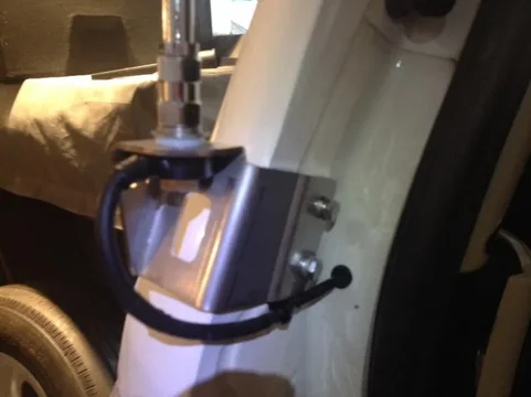

Last year I picked up just a simple hand held CB that really didn't give me the range neded on the trails (shocker).
Not all is lost since it accepts a CB cable, so I finally got around to installation.
I used a LabRak mount which after seeing some in CO, I had to have. On top is a 3' FireStik II, followed by a spring, and then a push and twist quick disconnect. For the cable, I used an 18' Fire Ring.
This does require soldering (only one quick drop to secure the center coax to the pin in the adapter) but allows for a super clean install.
Wire was fed through the back, and zig zagged under the carpet. I got to the 2nd row and ran it on top of the floor (still under weather techs) and then up to a hole I drilled next to the 12v outlet in the console where both plug in.
Haven't had a chance to play, but picked up lots of activity in a quick 15 minute trip to the store.

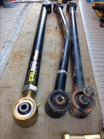

Step one to getting her back to normal was completed today - Metal Tech LCA Install. Click here for write-up on product/process.
Wheel/Tire situation will be fixed next week :) The Commemorative (destroyed) LCA is now hanging in my garage as a souvenir/reminder of our 1:30AM blacksmith shop in a group camp trying to pound it back out.
