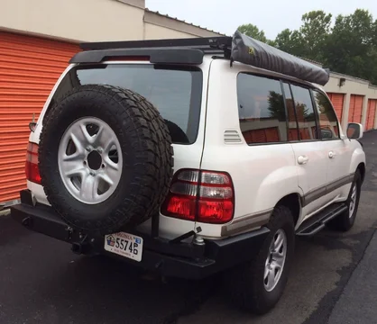

Over the summer, I picked up a BIOR rear bumper with swing out, and had Ryan from OTRAMM install it.
You can probably see from the photo that the *almost* 1" of rake evaporated. This was on OME 866's + 15mm spacers, and Fox 2.0's.

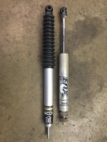

This spring I upgraded to 295/70r18 Toyo AT2 xtremes, and immediately wanted to get it a little higher, but also add rear travel. About this time a shock legnth thread popped up, when the new Icons came out. I wanted to give the Icons a try after others posted their extended legnth over the Fox (about 2.5")
MetalTech had a nice cyber Monday sale where I picked up the Icon VS series (non-resi).
Seeing is believing.
While mated with the 864's the ride has been good. Feels good upon acceleration, cornering, braking, and going over bumps. Bumps do feel a little sharper (thanks to 864s) but they don't feel like a dead blow they way they did with the Fox's. I also say the 866's played into this since they were at the high end of their "progression."

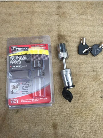

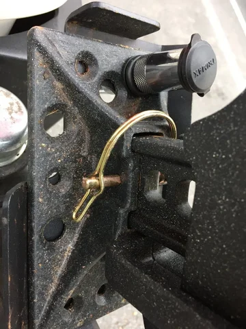

Finished off today with a "theft deterrent" (note: not anti-theft) pin on my hi-lift now that she can handle a little extra weight.

In all, she is sitting at about 23.25" center hub to fender in the rear. I expect a little settling, but good by me.
Icons have been great. I'm only running them in the rear, and while paired with 864's, its been awesome.
Just did a 700 mile trip up to NY and back, and was very happy. Part of this is I'm sure due to the jump to 864's at the same time, but really looking forward to seeing how she performs on the trail with the extra couple inches of extension.
