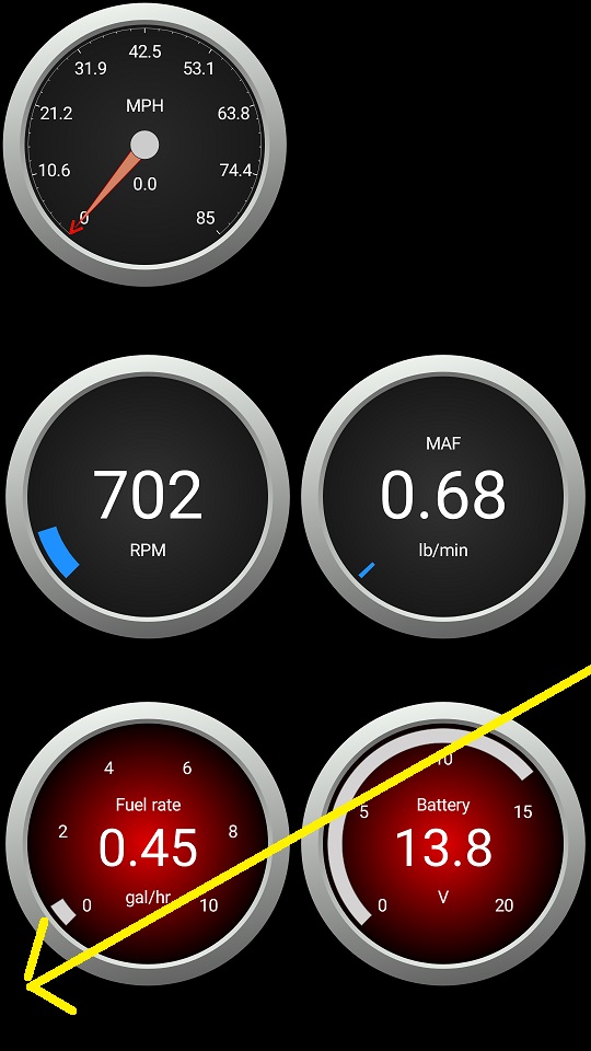

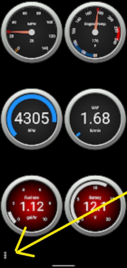

Dumb question but on my android phone I do not get the "menu" 3 dots to adjust my dash boards.
How do I fix this?
Android Sonim xp8
I did turn the use simple dash board off.
But still no menu dots...
Any thought on how to fix this?

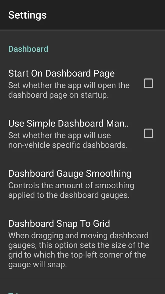

Not much help here. The iPhone does not have these dots either. There are horizontal dots in the bottom middle screen, but they do not represent a "settings" area. They just show you which dashboard you are on. ie. I have 3 dashboards, so I have 3 dots and the one that I'm on is highlighted. None of those dots appear to be highlighted in your screen shot, so I don't believe it's the same function. The iPhone just has a menu button in the top right to get to the settings for dashboards.
I mostly just posted to say that you probably want to leave the "simple dashboards" checked. It doesn't really mean what it seems like it means. Having simple enabled makes it so dashboards that are shared to you will work on your phone. With it turned off, then only dashboards designed specifically for your vehicle will work.

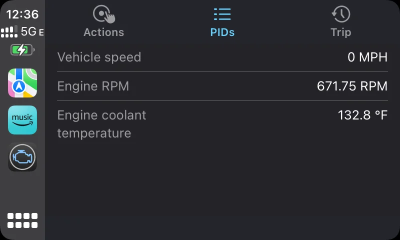

On a plus side. While digging around in the settings to see how mine looked compared to the post above, I see the app has been updated for iPhone and there is now a Carplay section in the settings. Not sure what it's going to do, but would be pretty cool if it means there will be dashboards that get pushed to Carplay. It looks like it's a tuned down version of the standard dashboard where you can add PIDs, but I don't think you can determine their placement. But still a step in the right direction.
Edit: here is a screenshot:
Ah, cool. Thanks for pointing this out. It’s in Settings > Preferences > CarPlay. Looks like there is some customization here.

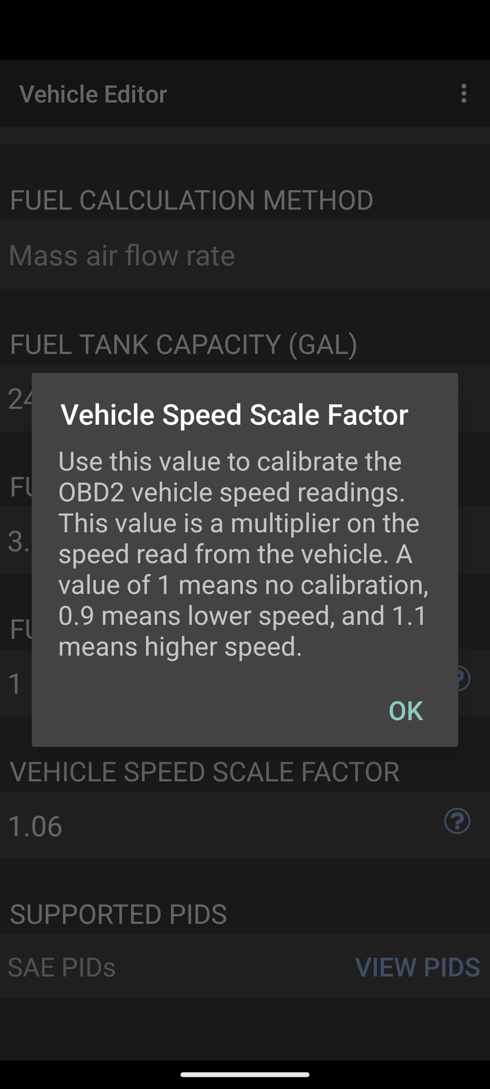

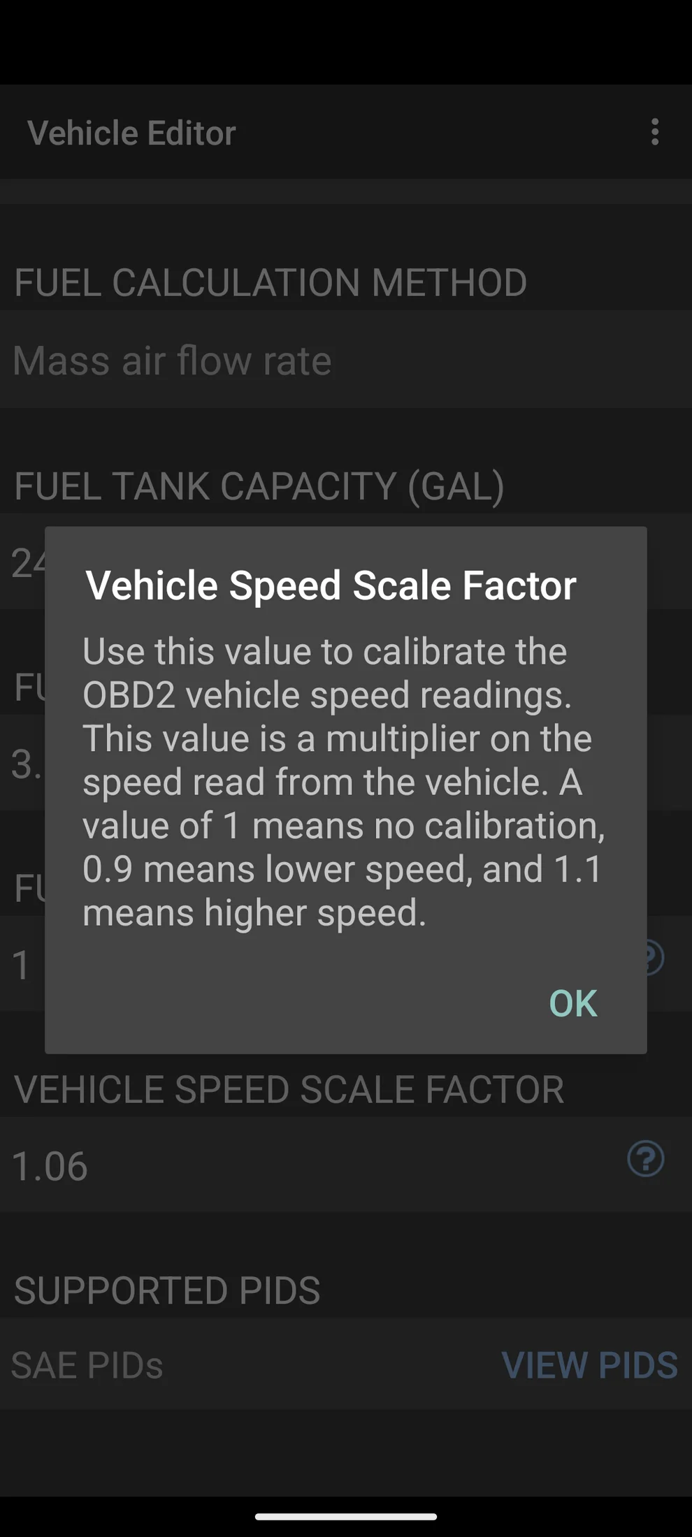

In the OBDLink app I'm running, there's an option to adjust the 'vehicle speed scale factor' in the 'Vehicle Editor' section. I have not found a discussion of this part of the app, so sharing here seemed logical.
I'm running 285/75/17 rubber, and the average of the on-paper and in-situ difference in speed indication is 6.5. At the vehicle level, I've set this adjustment to 6% currently (1.06 scale factor) and now the speed from the app (calculated) and GPS speed are nearly the same. I ran two speedo variants on one screen, side by side. Also, *I think* that the MPG reading from the app is now accurate. Best parts: MPG is better looking, and I can get very accurate calculations on how many gallons I need to top off minus two, to protect the Charcoal Canister.
Note: this factor adjustment can also be made on the individual dashboard level inside the app, but based on my experiments, once the vehicle-level adjustment is made, it propagates throughout and applies to everything. I could be wrong here. Still have to set up a three-speedo (adjusted, no 'vehicle level', adjusted at gauge level, and GPS) to fully confirm.
If you have insights into this or do it differently, please do tell.
